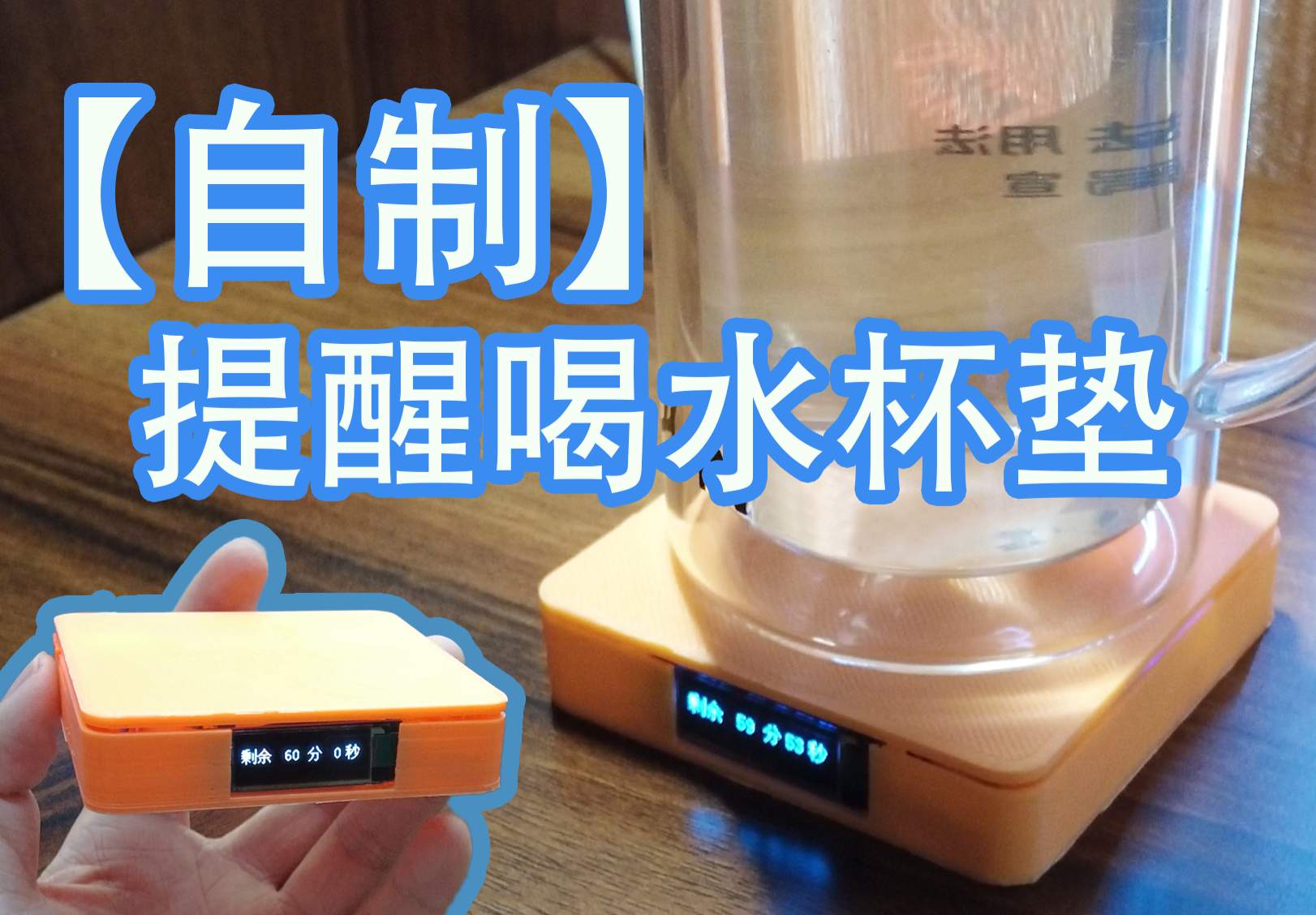

First, let’s start with a video introduction:
This is a simple project. The reason was that a netizen at Station B suggested that he needed a coaster to remind him to drink water like classmate H did, so he made this thing:
This is the internal structure:
The PCB design this time still uses SMD originals as the main method. Considering the size, it is impossible to use off-the-shelf Arduino and other modules. It is better to just build one yourself. The f0 series was selected as the main control because this project does not require high performance, and due to cost considerations, the simpler, the better. All the pins of this f0 chip are used, and the memory is just right. It can be said that no performance is wasted.
