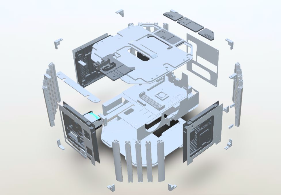

550A-MATX-AP Chassis
 The aluminum profile version of the 550A-MATX-AP chassis has a chassis size of 38 38 25, a graphics card compatible length of 343mm, an aluminum profile of 20 width, and non-slotted square profiles or 3-piece profiles such as 20 60 profiles can be used on all sides.
2023/08/03: The power board has been updated to solve the problem of inverted hole interference. Please use the 2023/08/03 power board for production!
