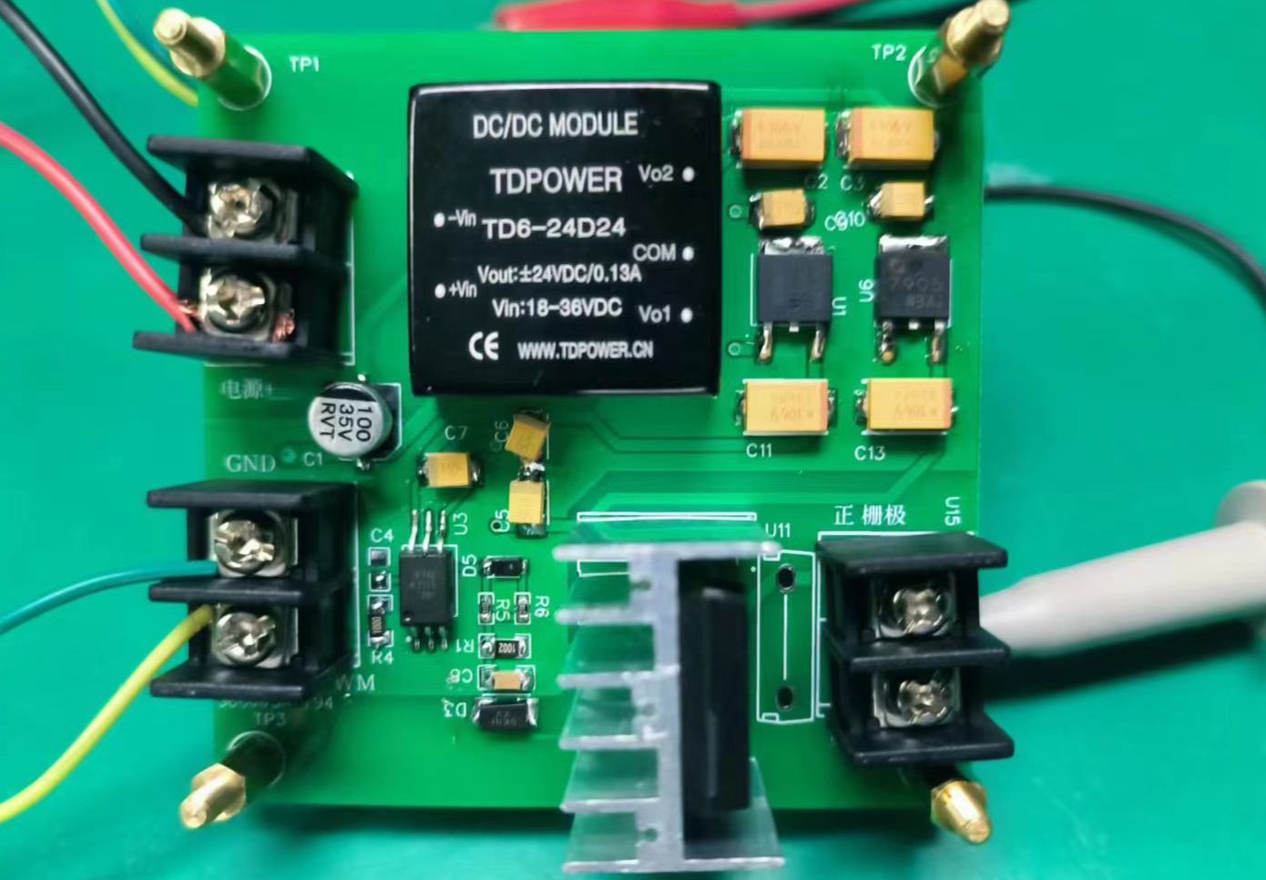

MOS switch modules on Taobao generally have low voltage resistance, so I made a switch transistor module using SIC for experimental circuit construction.
The SIC single-tube switch module built based on the optical isolation driver can switch up to 200K.
Working principle of 1200V withstand voltage :
Step 1: Use DCDC isolation module to output ±24V
Step 2: Convert to +15V and -5V through LDO.
Step 3: Enter the optocoupler isolation logic output and select between Vgs to output +15 or -5.
Because it is driven by an optocoupler, it can drive any SIC and MOS tube. If you need to change the driving voltage, replace the LDO.
The actual picture is as follows.
A close-up shot of the actual picture and
a screenshot of the driving voltage oscilloscope are as follows.
