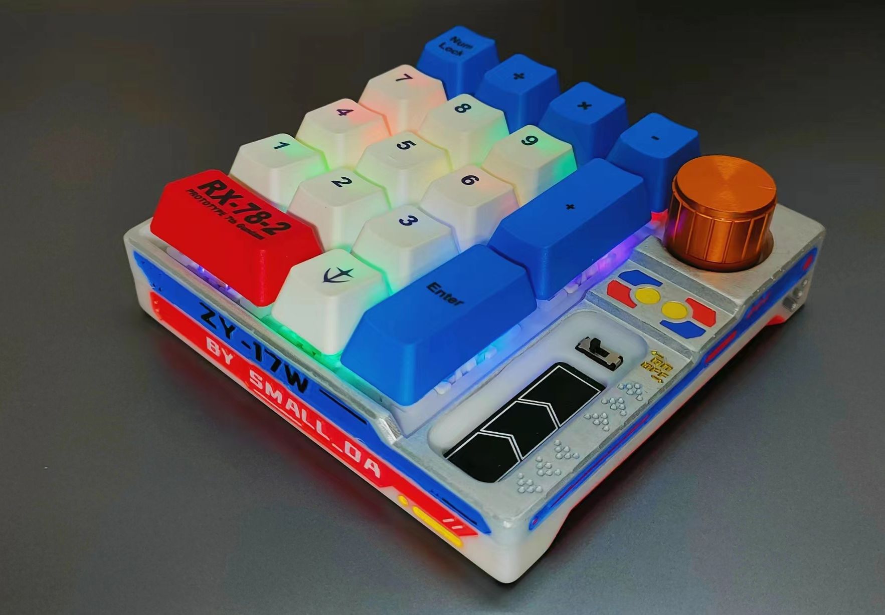

1. For the finished product effect display,

3.5 Install the shaft body, keycaps, and knob caps
as shown below. Install the shaft body, keycaps, and knob caps as shown below, and the shell can be modified as needed. Painting, here you need 3 2U satellite axes
