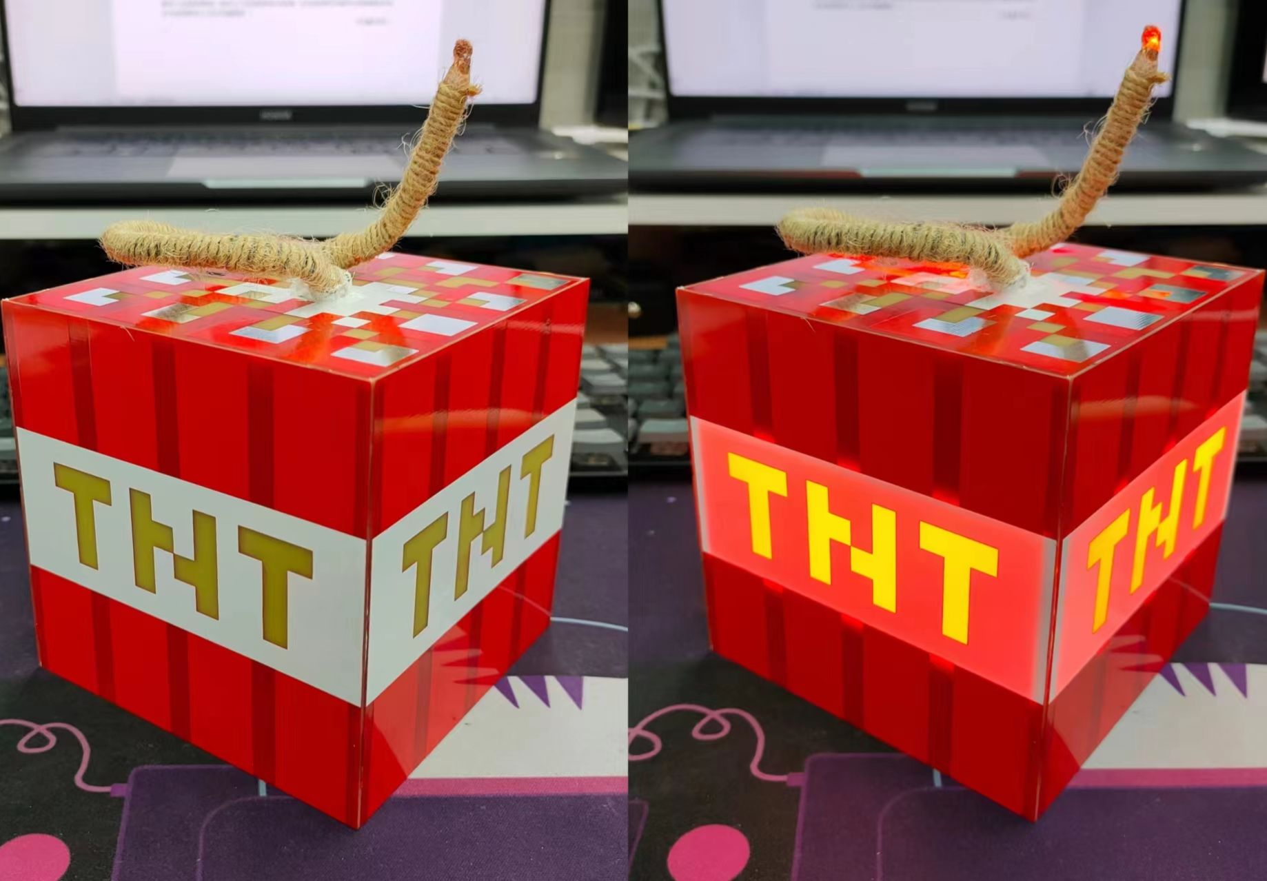

 I'm working on my graduation project recently and haven't done any new projects, but I can't waste the two free coupons every month! It just so happens that I have some components left from making snowflake lamps before, so I thought of using them to make a simple TNT lamp~ (it can even be used as a storage box)
1. Effect display
2. Hardware

3.3 Assembly and effect display
