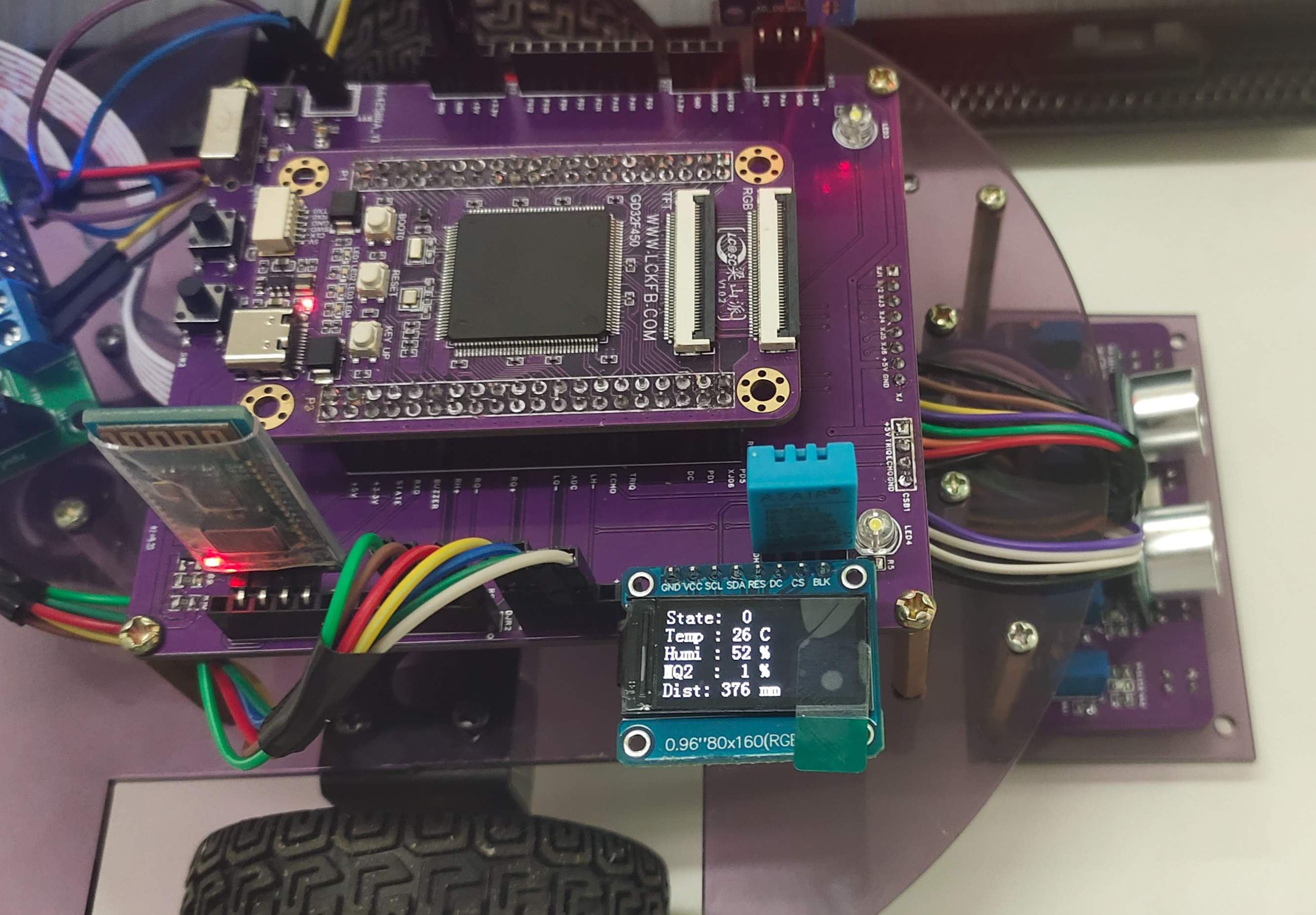

The environmental detection car is developed based on the GD32 Liangshan School development board. In terms of environmental detection, it can monitor air, temperature, humidity, human body infrared, etc. In other aspects, it has functions such as ultrasonic obstacle avoidance and infrared tracking, and then the sensor module measures Data is transmitted to the main control through Bluetooth, serial port, etc., and the data received by the main control is displayed and judged through OLED.
  In the running or stopped state, the sensor will continuously detect data and transmit it back to the main control, and display the processed data on the OLED.

(6 ) OLED display: In this project, the values ​​detected by the above sensors are displayed on the OLED, and the data is updated in real time.
