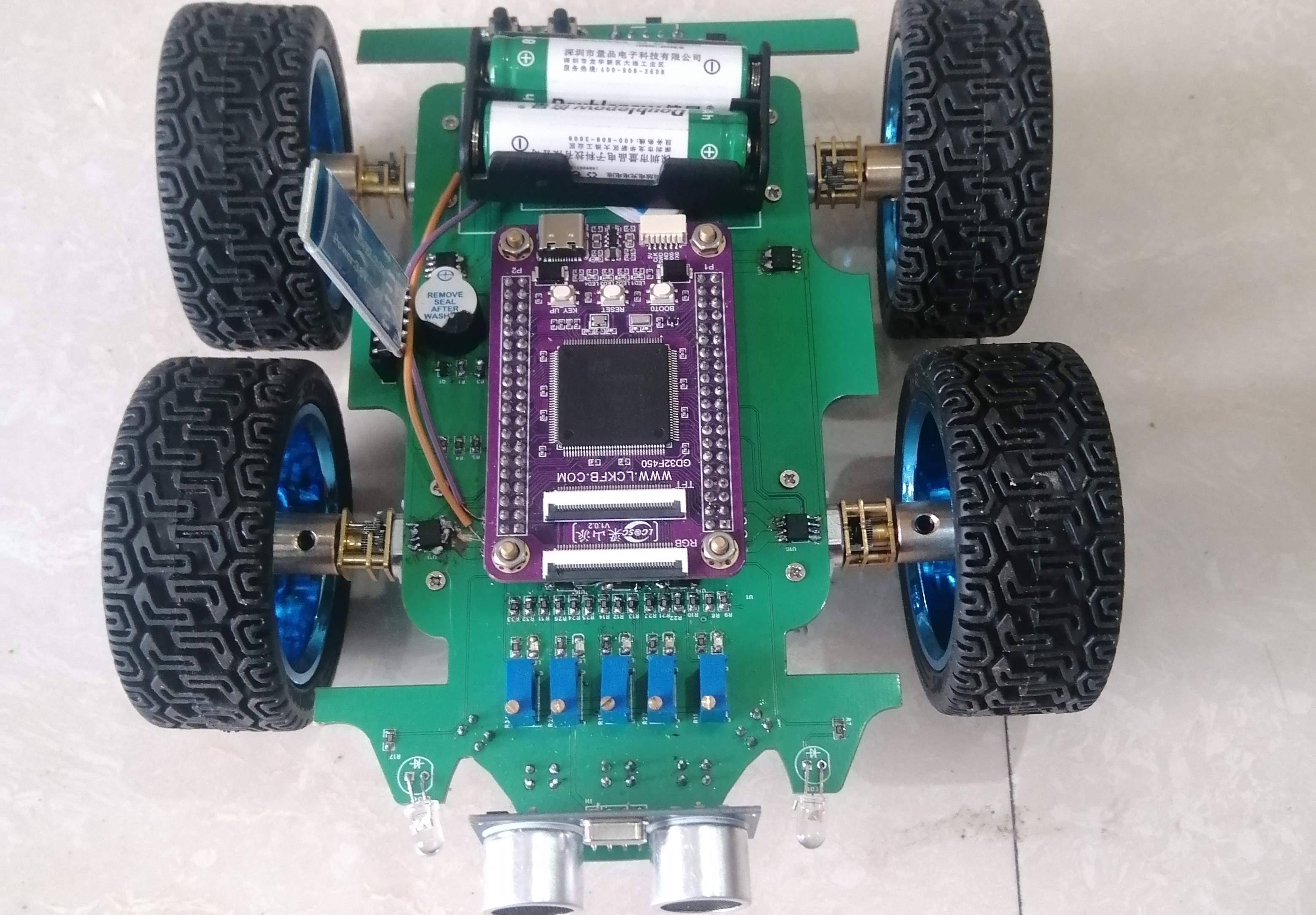

A smart car with Bluetooth remote control and autonomous obstacle avoidance based on GD32 main control.
The car uses the Lichuang Liangshan School development board GD32F470ZGT6 as the main control. It can realize tracking, Bluetooth remote control, ultrasonic obstacle avoidance, button control to switch the car's motion mode and other functions. , because it is the first time to draw a PCB board, there is no expansion I/O reserved, there are many welding problems and my own assembly experience is insufficient, the motor drive in the video is not sensitive.
## Physical display
! [QQ picture 20230221082642.jpg] ## Looking down
! [IMG_20230221_082511.jpg] ## Looking up
! [IMG_20230221_082403.jpg]
