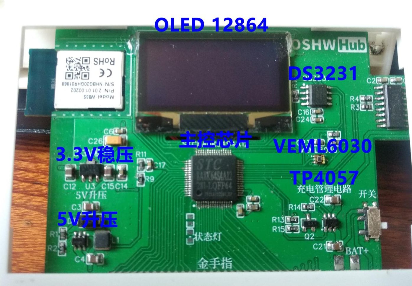

V1.0 function description (current):
  • 1. 1.3-inch OLED displays time, date, temperature, humidity, power and other data
  • 2. Press the buttons to set related functions.
  • 3. Use DS3231 as a clock IC to provide more accurate time when offline.
  • 4. Use SHT30 as a temperature and humidity sensor, which has better dynamics and higher accuracy.
  • 5. Use VEML6030 to sample the surrounding ambient light to realize automatic adjustment of OLED brightness and turn off the screen at night.
  • 6. Realize APP control and view current environmental data through Tuya Smart’s WB3S wireless module
2021-02-05 Edit
  PCB welding is completed and all modules communicate successfully
