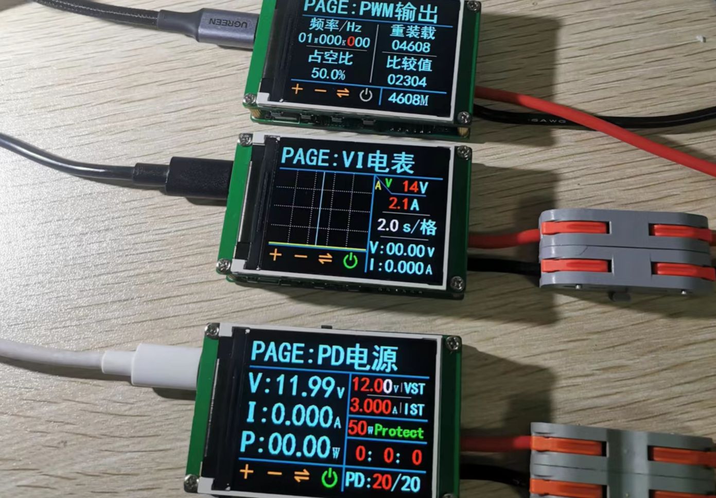

With it you will get 1×PD input low-power buck-boost power supply (OUT MAX: 40V 40W) 1×PWM generator 1×voltage ammeter
can be set to decoy 5V, 9V, 12V, 15V, 20V all PD power supply
3.5*6cm The mini size
has a huge screen-to-body ratio (fog),
which is really a good thing.
(It just feels a bit hot when running.)
This project consists of two projects. This project is the base plate.
The top board connection is: https://oshwhub.com/surpmotherfucker/pd-dian-yuan-ding-ban
Note: Before using its ammeter function, please connect the OUT+ points of the two boards with wires, otherwise the voltage drop will be large and the current value will be inaccurate.
