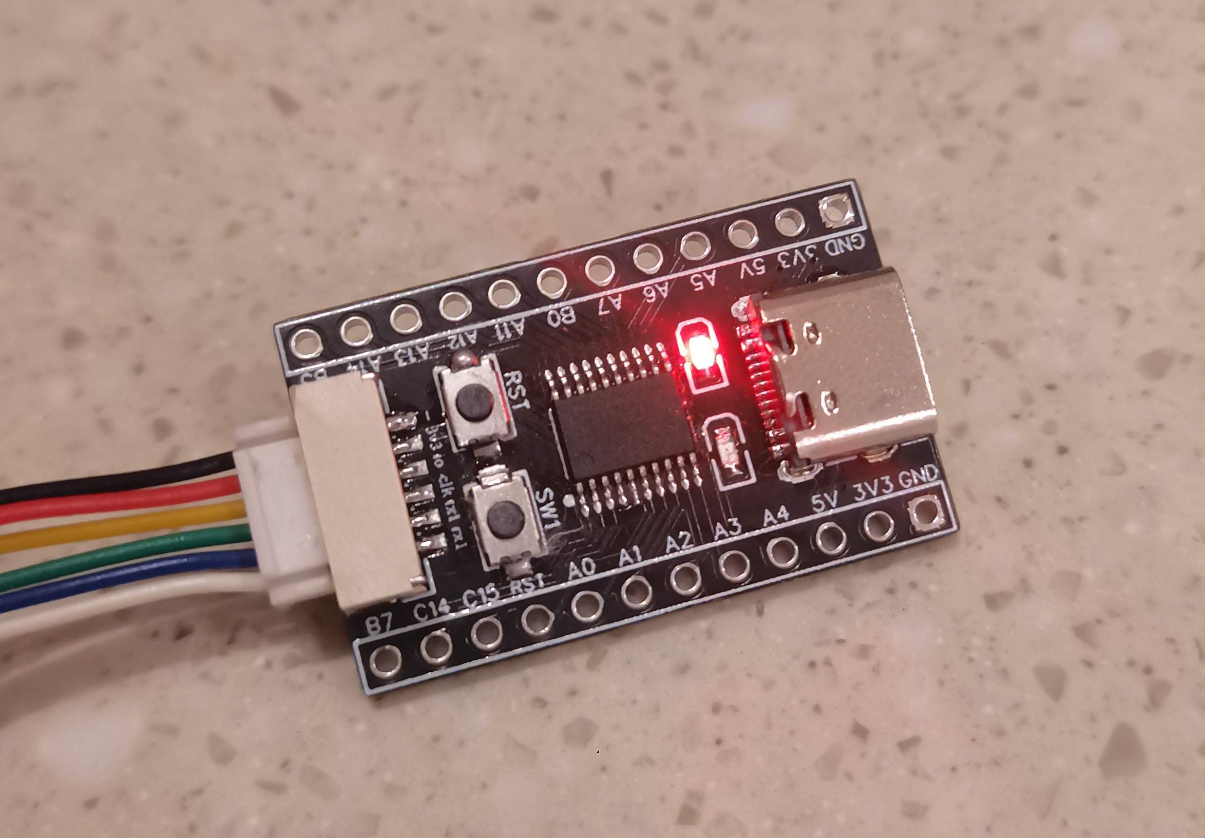

stm32g030f6p6 core board mini version
Small size, all pins are led out, typec power supply, gh1.25-6p port, integrating power supply, downloading, and serial port. With a homemade downloader (to be released later), debugging is very convenient
! [Top] picture is the first version , the cc pin of the typec port does not add a resistor, resulting in no voltage output from the C port power supply, which has been corrected;
there is a problem with the original part in boom, directly enter the schematic diagram to generate boom
