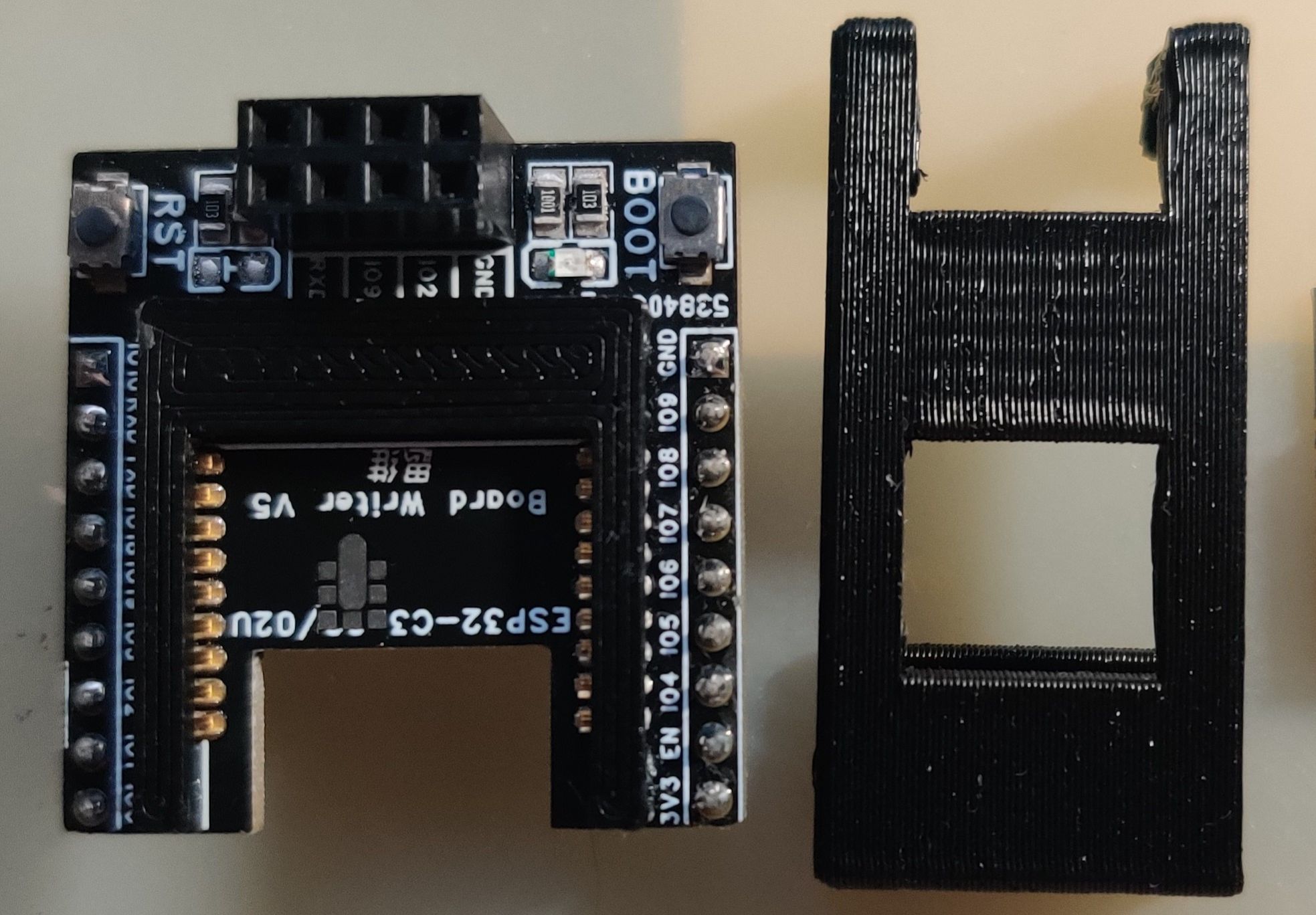

ESP32-C3 burning folder
The old ESP01 programmer can be directly inserted into the programming folder, and automatic programming is retained;
the metal shrapnel specification is 3.2*0.95*1.0;
the fixed frame and clip are completed using 3D printing;
the example picture shows the old version, IO10 An LED was introduced and has been removed in the project.
The 3D printed STL model has been uploaded in the attachment. esp32-c3-writer2.stl is pasted onto the circuit board, and the other esp-c3-02-clip.stl is the fixture. Just 3D print it yourself.
