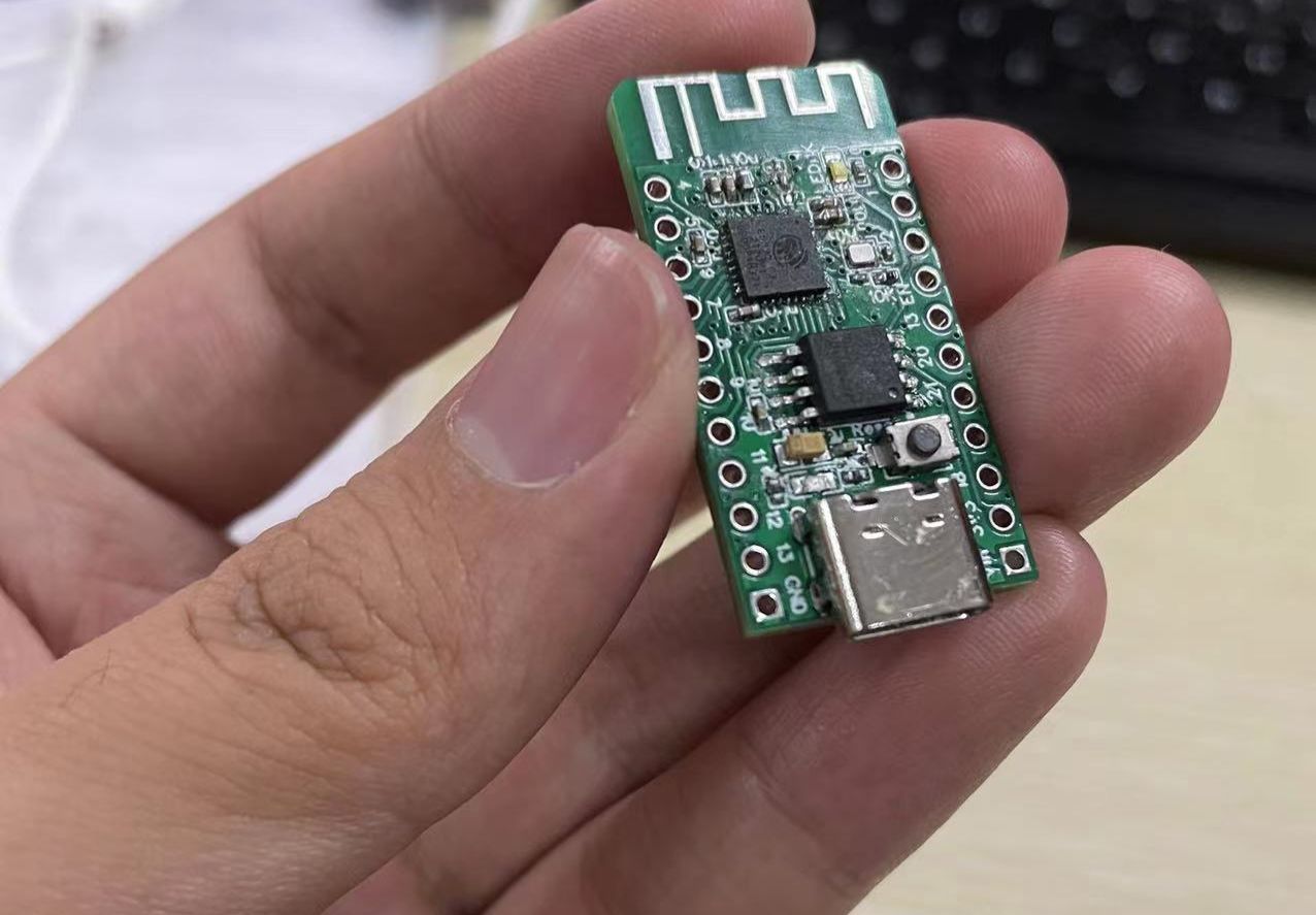

Esp32-C3-Nano: Super mini development board
        The ultra-small ESP32-C3 development board integrates an automatic download circuit. The reversible type-C interface can switch between the serial port module/chip's built-in USB, and is compatible with different development needs!
        Designed with ESP32-C3 chip, the Flash location is reserved, and you can use the C3 chip with built-in Flash or without Flash.
        The serial port module uses the classic CH340C chip, the power supply solution is the AMS1117 module, and tantalum capacitors are used as output capacitors.
