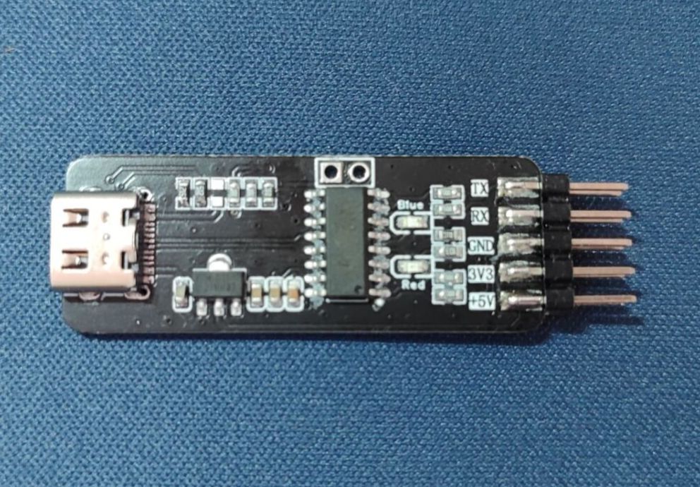

This downloader is mainly used for the following purposes:
- swd debugging of arm mcu such as STM32
- two-wire debugging of Qinheng's own riscv
- downloading of serial ports such as STC ESP
- serial port debugging
# Hardware description
This time I drew three types of boards, Board3 is more recommended, let’s take this as an example.
For the three resistors selected in the frame in the picture below, if a 3.3V level is required, use 0R resistors to solder the two on the right. If a 5V level is required, only the leftmost one is soldered. Please see the schematic diagram for details
! [image.png]
# Firmware burning
uses WCHISPTool to download the firmware. It is recommended to use serial port download. . I have not been successful in downloading using USB
! [image.png]
# Use
The use of Daplink in keil is no different from ordinary daplink. It just needs to be switched to arm mode. The default is riscv mode.
## For details on two-wire debugging,
please refer to Qinheng’s official configuration manual
# The video
below the demonstration video is the complete welding process. According to my soldering method, the level after completion is 3.3V.
