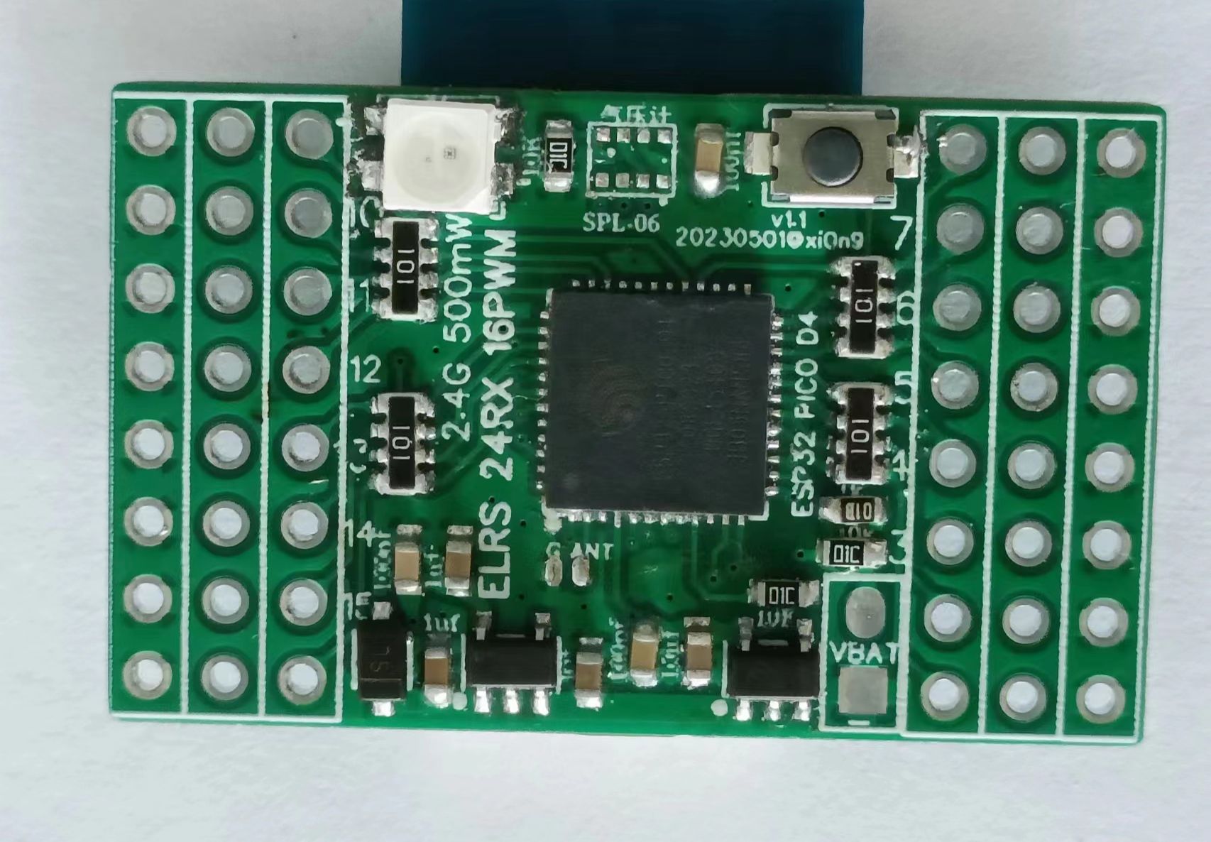

## Features
- esp32-pico-d4 high performance main control
- Use E28-2G4MxxS mature and reliable RF module
- Size: 34mmX21mm
- Working voltage: 5v
- Output channels: up to 16 PWM
- Telemetry return power: maximum support 500mw
- Altimeter vario return, using high-precision barometer SPL06
- Support 8S (33V) battery voltage vbat return
- Can switch output CRSF protocol, can also be switched to transmit high-frequency head
- WiFi web page to set pwm output, and update firmware
- IC components single-sided layout, easy to make
## Production
### Hardware production
1. Use the gerber file to Jiali Chuang PCB [first get a free coupon](https://www.jlc.com/newOrder/#/collectCoupons ) and then [one-click order for 5 samples](https://www.jlc.com/newOrder/#/pcb/newOnlinePlaceOrder)
2. Open the bom.html interactive web list, purchase components and place them according to the diagram.
3. You can use a 10-yuan "PTC heating table/LED desoldering table" for soldering: pre-tin the pad with a soldering iron (or apply tin paste), place the components according to the interactive ibom, move the PCB to the heating table and heat it for a while until the tin melts and the soldering is done. (Reduces the difficulty for novices)
4. Check whether the pins are tinned or not, and use a soldering iron + flux to treat them.
5. Use a multimeter to measure whether 5V/3.3V is short-circuited to the ground, and measure whether the adjacent pins of ESP32 are short-circuited according to the ibom diagram.
*tips: 1. The back pad is fully compatible with the 20s27s pins. If you use 12s, pay attention to the dotted mark; 2. Whether the barometer is soldered determines the number of PWM channels, see [Firmware section](#gujian)*
