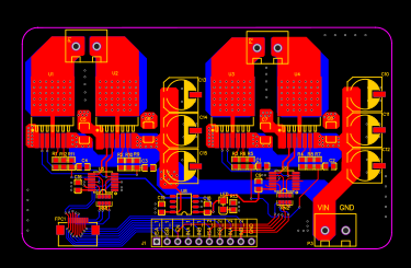

This project uses the INA219 current detection module and the BTN7971 motor drive module. It collects the voltage and current information read by the AD through the STM32 main control board, outputs the corresponding parameters to the motor drive module to control the motor speed, and transmits it to the host through the wireless module. machine display.
参考设计图片
