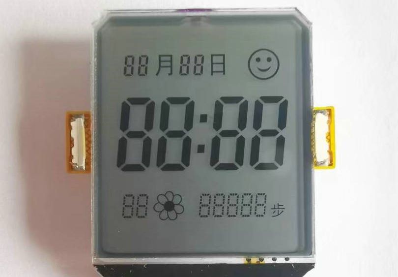

    The display part uses a 0.9-inch segment LCD driven by Philips PCF8576C, which is very power-saving. It is cheap and sufficient for a watch display. It occupies relatively few system resources. The following is an introduction to this LCD screen: https://mastergong.cn/docs/display_specs/%5B50%5D0.9LCD.html
