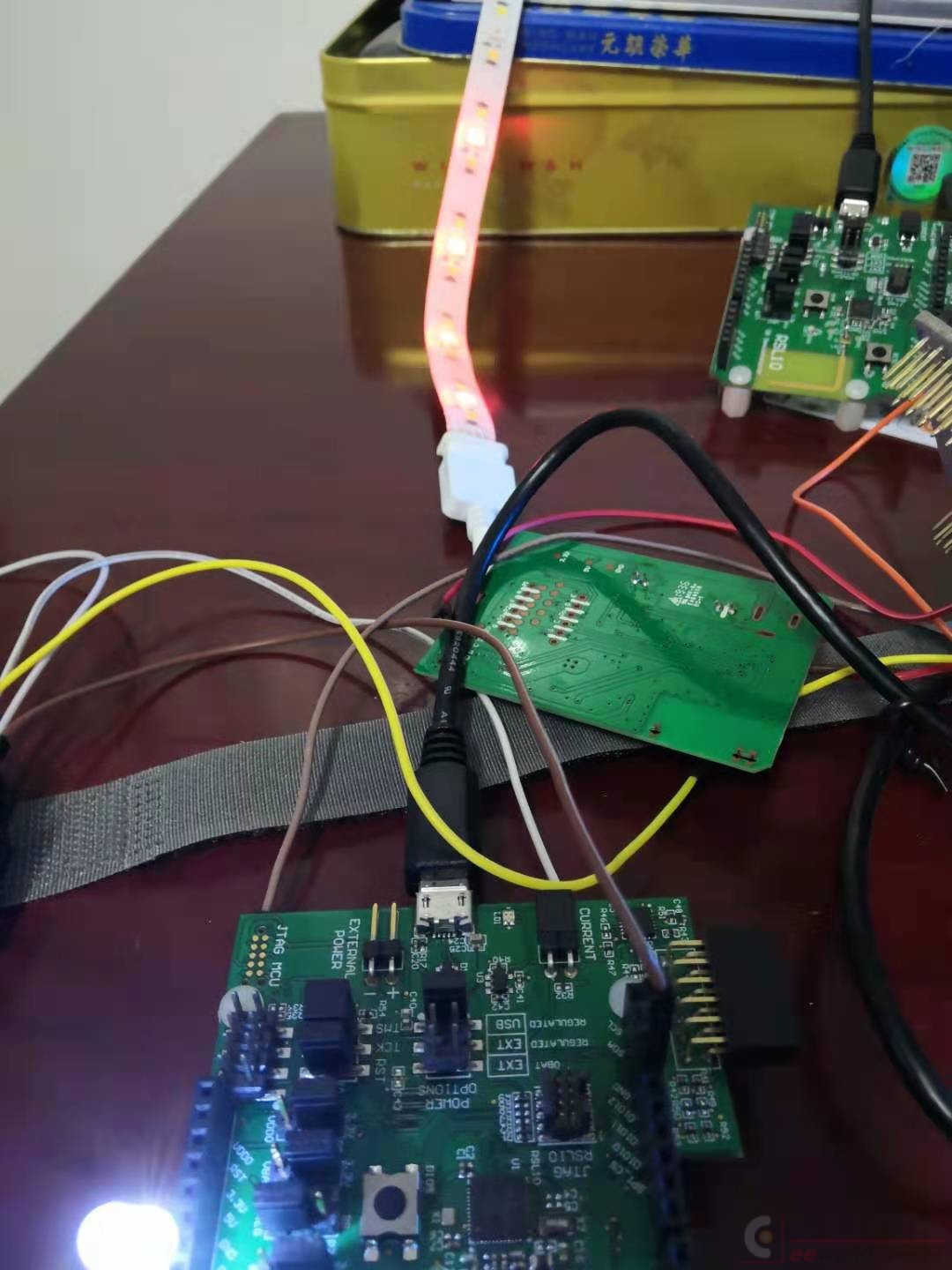

RSL10 QFN EVB is used as the main control of IOT lamps. Because the GPIO of RSL10 is limited, the data protocol adopts single-line return-to-zero code communication method. The system only needs one GPIO1 as the LED RGBW driver. GPIO is used to drive WS2812. WS2812 is a control circuit and An intelligent externally controlled LED light source with integrated light-emitting circuit. Its appearance is the same as a 5050LED lamp bead, and each component is a pixel. The pixel contains an intelligent digital interface data latch signal shaping amplification drive circuit, a high-precision internal oscillator and a 12V high-voltage programmable constant current control section, which effectively ensures that the color of the pixel light is highly consistent. , the other ADC port is used to collect the temperature of the lamp, and when the temperature exceeds the limit standard, it automatically reduces the luminous efficiency of the lamp to avoid burning out the LED due to excessive temperature.

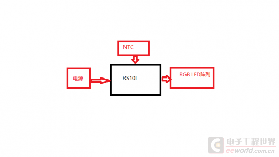

Blockdiagram
