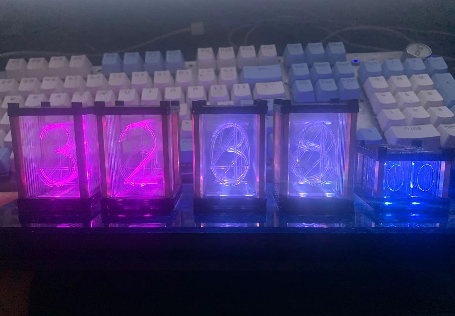

1. Function description: This project is an acrylic structural part project. The
acrylic digital board size is 30mm*49mm, 14mm*24mm. Acrylic engraving can be done on the Lichuang panel;
the open source numbers 0-9 are used and imported into EDA using CAD;
low panel Print on the Nihui panel.
The panel printing link is: https://dos.szlcsc.com/The
circuit open source file is as follows:
https://oshwhub.com/winton/ni-hui-guang-guan
2. Design features:
Use Lichuang EDA draws the PCB file of the lamp board, and you can directly proof the patch in Jialichuang; please note that the lamp bead WS2812 is a model with capacitor.
Use the professional version of Lichuang EDA, panel drawing software, to draw the shape of the acrylic board, which can be printed and engraved on the Lichuang panel;
3. Video:
 Attached video, more details will be posted on station B.
4. Important note:
This project is only for update Many people make similar Nixie tubes and open source related structure files, and hope to know more about panel printing and become familiar with using the professional version of Lichuang EDA, which has more comprehensive functions.
This project is released based on the GPL 3.0 agreement, requiring secondary developers to make it open source and free under the same open source agreement, and cannot be used for commercial purposes.
5. Precautions:
Acrylic customization may have accuracy errors.
Please read the relevant project details and video content of the project in detail before proceeding with proofing. You need to understand all related structures.
