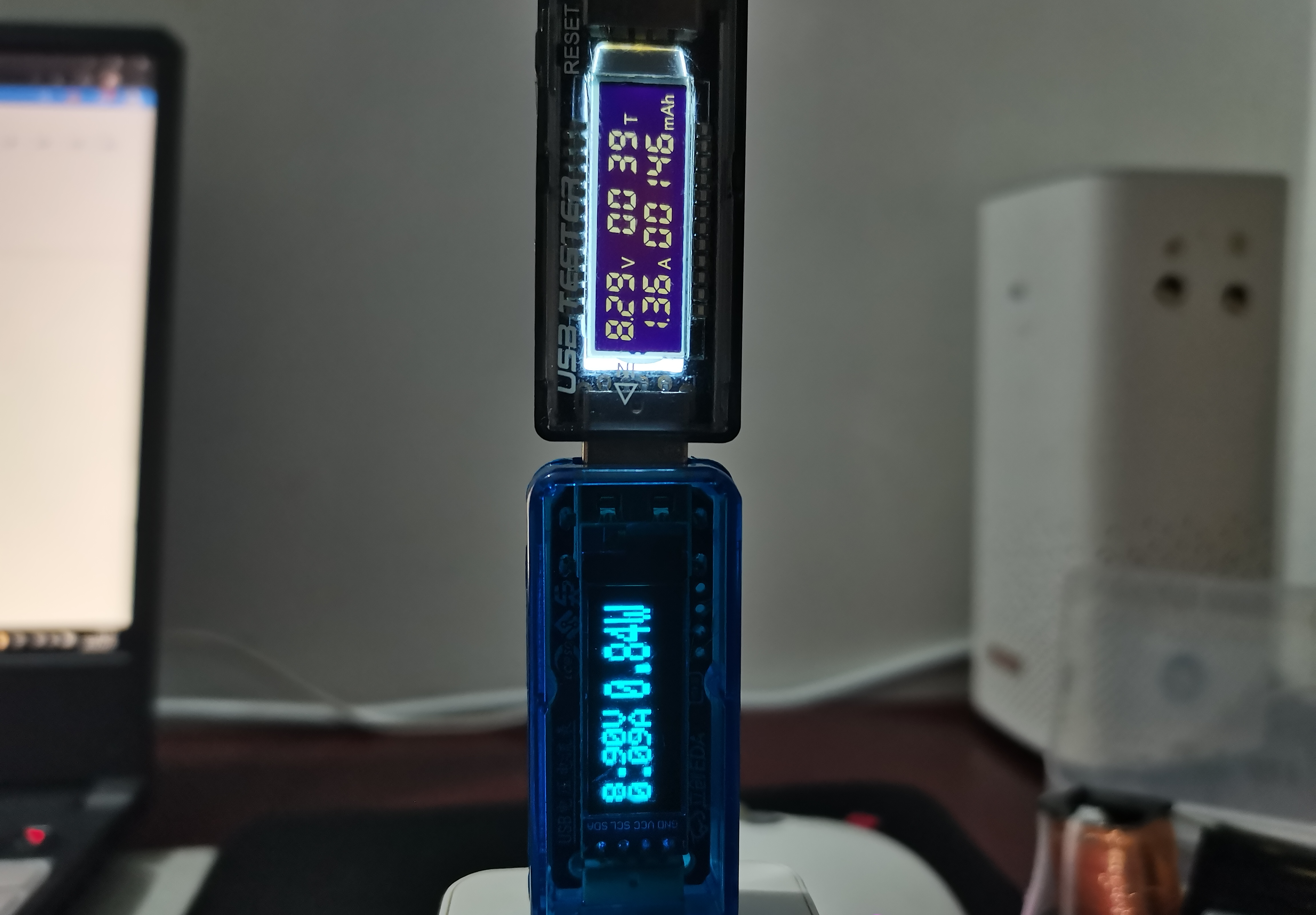

is based on the official redrawing of the PCB front and back of #7th Lichuang Electric Competition#USB Basic Voltage and
Current Meter:
the line width of the sampling resistor area should be increased, and the power supply part should be as thick as possible to increase the overvoltage and current capabilities.
The GND part has a large area of ​​ground and a large number of vias to ensure strong overcurrent capability of the loop
