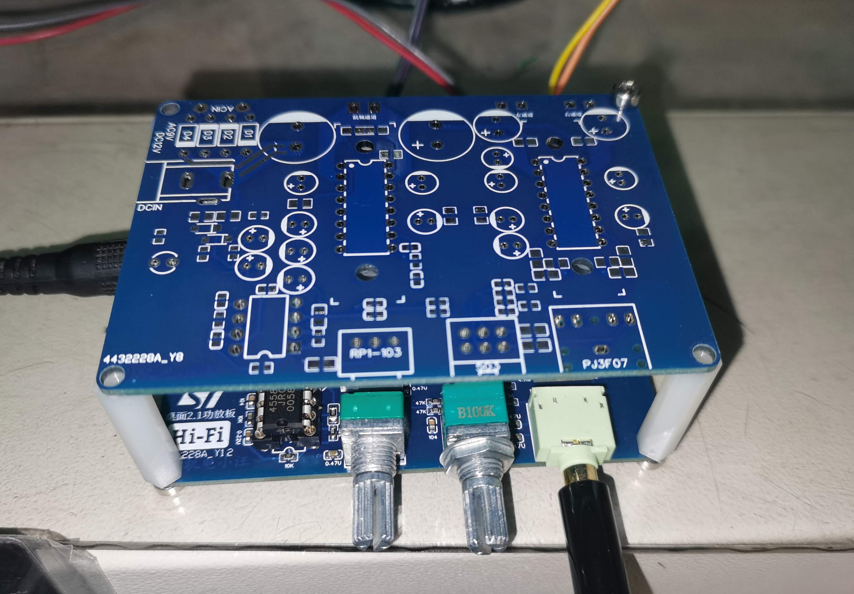

Desktop amplifier (op amp version)
This circuit uses two TEA2025B as the main power amplifier chip, jrc4558 op amp low-pass filtered 2.1 desktop power amplifier.
(Verified)
The power supply is DC 12v or AC 9v (about 12v after rectification).
The signal input uses 3.5mm
. It has been verified that the board can be directly printed
. Some precautions have been marked on the schematic diagram. Note that the reference
chip needs to add a heat sink, especially the bass chip!
