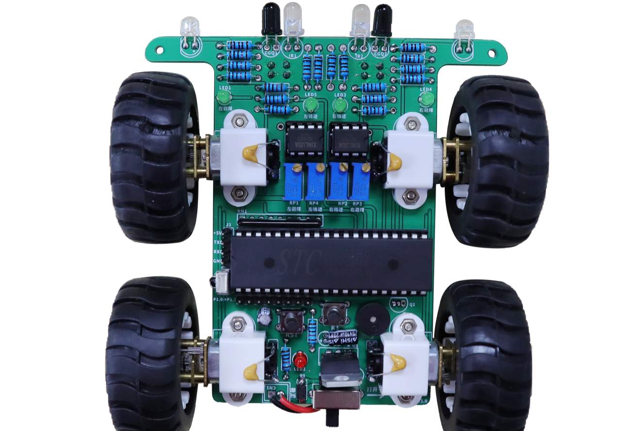

        Smart cars are a very classic course case. There are various car body models and kits for sale on the market. Can we design a smart car ourselves? Based on this idea, we designed this STC89C52. Mainly controlled smart car. As for why STC is used as the main control, the main reason is that this chip is highly recognized by everyone and is very classic!
Application scenarios:
  • Single-chip microcomputer course teaching, using smart cars to replace development boards throughout the single-chip microcomputer course teaching
  • Microcontroller course design allows students to implement relevant functions according to requirements
  • Electronic cognition and welding exercises, complete the welding of smart cars, stimulate interest in electronic learning
Features:
  • The two left and right car lights simulate the state of the car lights in a passing car.
  • Independent keys to practice key input and interrupt functions
  • Passive buzzer, learning audio frequency generation, simulating sprinkler truck music
  • Four motor drives realize PWM output and speed adjustment functions
  • Tracking and obstacle avoidance functions, learning comparator circuit, realizing obstacle avoidance and tracking functions
  • Wireless remote control, learn wireless transmission theory and realize remote control function

4.2 PCB design considerations
4.2.1 Frame shape
        After designing the schematic diagram, it’s time to design the PCB. The design of the PCB shape is the first step that needs to be determined. Since we are making a smart car, the frame we want to design is the chassis of the car. Use the frame layer in Lichuang EDA for design. The frame size is controlled within 10cm*10cm. This is mainly for free proofing, which is also satisfactory when designing this car. Use the straight line and arc tools in the drawing tools to design, and you can also make full use of the grid size and grid size to assist in drawing lines, which can help us design the outer frame more accurately. Regarding the car models and styles, you can design them according to your own preferences without sticking to the reference pictures, such as go-karts, four-wheel drive vehicles, racing cars, etc. Everyone has a different car in their mind, and what we do is we need to express what we have in mind. The design reference outline drawing is as follows:
Figure 4-5 Smart car appearance reference diagram
4.2.2 PCB layout
        After the PCB frame shape is determined, the components can be laid out. Combined with the characteristics of the smart car, the wheels are placed on both sides, the tracking, obstacle avoidance and light circuits are placed in front of the car, and the four drivers are placed on the four sides. A motor accessory, the smallest main control system is placed in the middle, the power circuit is placed at the bottom of the board, and the switch faces outward. The layout of components after the schematic is converted to PCB is relatively random. It needs to be placed in the appropriate position and adjusted slowly. When laying out components, be good at using the layout transfer of the top menu bar selection tool in the Easy EDA schematic diagram. Function (shortcut key: CTRL+SHIFT+X) can quickly classify and display components. There are several principles to consider in device layout:
(1) According to the circuit module layout, the core devices and peripheral devices of each circuit are placed together;
(2) According to the functional layout of the circuit, components cannot be placed around the special device layout to avoid interference, etc.;
(3) According to the layout of the device characteristics, the input and output interfaces should be placed on the edge of the board for easy operation.
4.2.3 PCB routing
        A good component layout has completed more than half of the entire PCB design work, but the previous layout can only be a rough layout. In fact, it needs to be adjusted during the PCB routing, and it is adjusted while drawing until it is completed in our mind. Medium look. The following points need to be noted for PCB routing. More design points require us to continuously accumulate experience in design and improve our design and drawing capabilities.
(1) The power supply and signal wiring should be laid out according to the signal current flow direction and strictly according to the schematic design drawing. Even if they are all connected and no error is reported, the order must be considered, first through A, then B, and finally to C. , you cannot go directly from A to C to B. This is especially important when you are a beginner.
Figure 4-8 Routing reference
        As shown in the figure, chip U1 is a step-down chip. The power is input from the left side of C1, passes through capacitor C1, flows to chip U1 for step-down, and is output through C2. When placing the layout, the capacitor and chip must be close and neat. Place.
(2) Pay attention to the line width setting during PCB routing. The power line should be slightly thicker than the signal line, which can be set to 30mil, and the conventional signal line should be set to 15mil. The line width cannot be set too thin, and the factory production process should be considered. The PCB production process of Jialichuang is shown in the figure below:
Figure 4-9 Jialichuang process drawing
        During the actual wiring process, the pads connecting two identical networks are connected with wires. The wires should be given priority in straight lines, horizontally and vertically. You can adjust the device layout to make the connection between the two points the shortest. If a straight line cannot be maintained, it should be used first. 135° obtuse angle or arc routing keeps the design beautiful.
