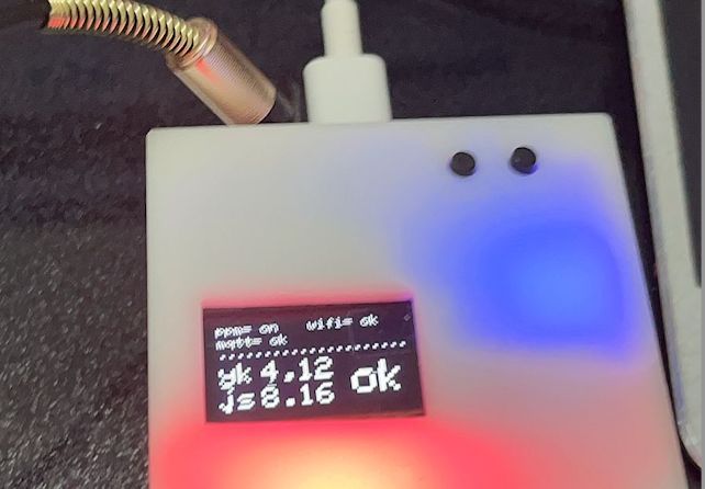

Update instructions for the third generation Tudou remote control.
The receiving end version is updated to V1.6 (esp8266_mqtt_ppm_pwm_jieshouji1.06)
The transmitting end version is updated to V1.7 (esp8266_mqtt_ppm_yaokong1.07)
The PCB of the receiving end is updated to V1.0
The PCB of the remote control end is updated to V3.0
The remote control end adds a screen display, which can display the ppm connection status, wifi connection status, vehicle connection status, mqtt server connection status, remote control end battery voltage, and receiving end battery voltage. The remote control end
switch is a headphone switch, which can be turned on by inserting headphones.
Add a 3D printed shell.
The remote control end reads 8 channels and the receiving end reads 6 channels.
The receiving end adds a real-time feedback function for battery voltage detection.
