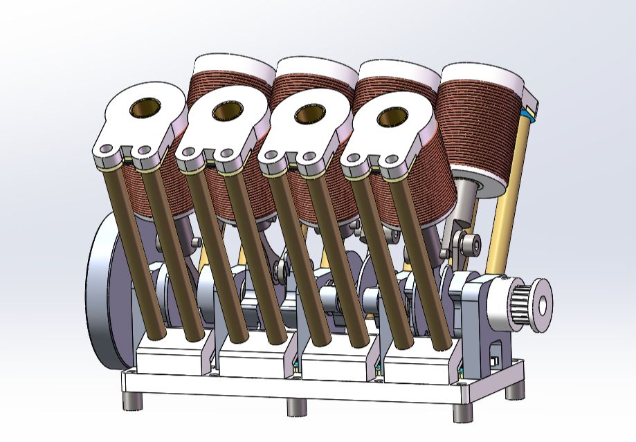

![V2 model.png] It adopts modular design. The most basic one is the V2 type. By replacing different base plates, more cylinders can be combined.
![V8 model screenshot.png] This is the V8 model in the video
