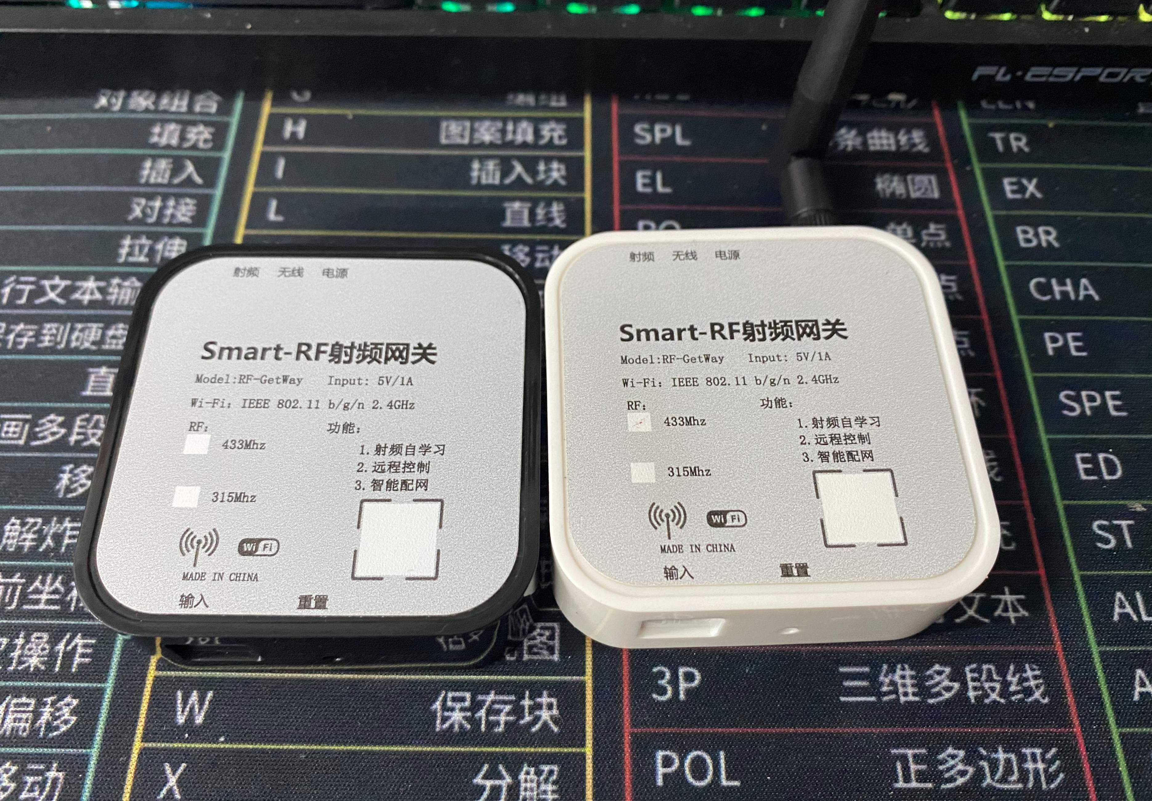

**RF Gateway Based on ESP8266**
This project uses the ESP8266-12S/F module of Anxinke to make an RF gateway. It can learn and send 433/315 non-encrypted RF signals around it, and can be controlled through the mobile phone. The purpose is to upgrade this type of RF to a remotely controllable IoT device.
Panel printing address: [https://dos.szlcsc.com/](https://dos.szlcsc.com/)
_**Board color: blue
thickness: 1.2**_
_**Attachments include shell drawings and test procedures**_
## Project FunctionsThis
project has the characteristics of self-learning and remote control
. 1. It has networking function.
2. It has 433/315 signal learning.
3. It has simulated 433/315 signal sending.
4. It has power indicator, network indicator, and RF indicator.
5. It has a button that can reset the device.
6. It has mobile phone control function.
7. It has web network configuration/smartconfig network configuration solution.

## Project picture
**Project picture reference**
![IMG_3785.JPG] ![IMG_3786.JPG ] ![IMG_3943.JPG ] ![IMG_3793.JPG] ![IMG_3794.JPG] ![IMG_3996.JPG]
