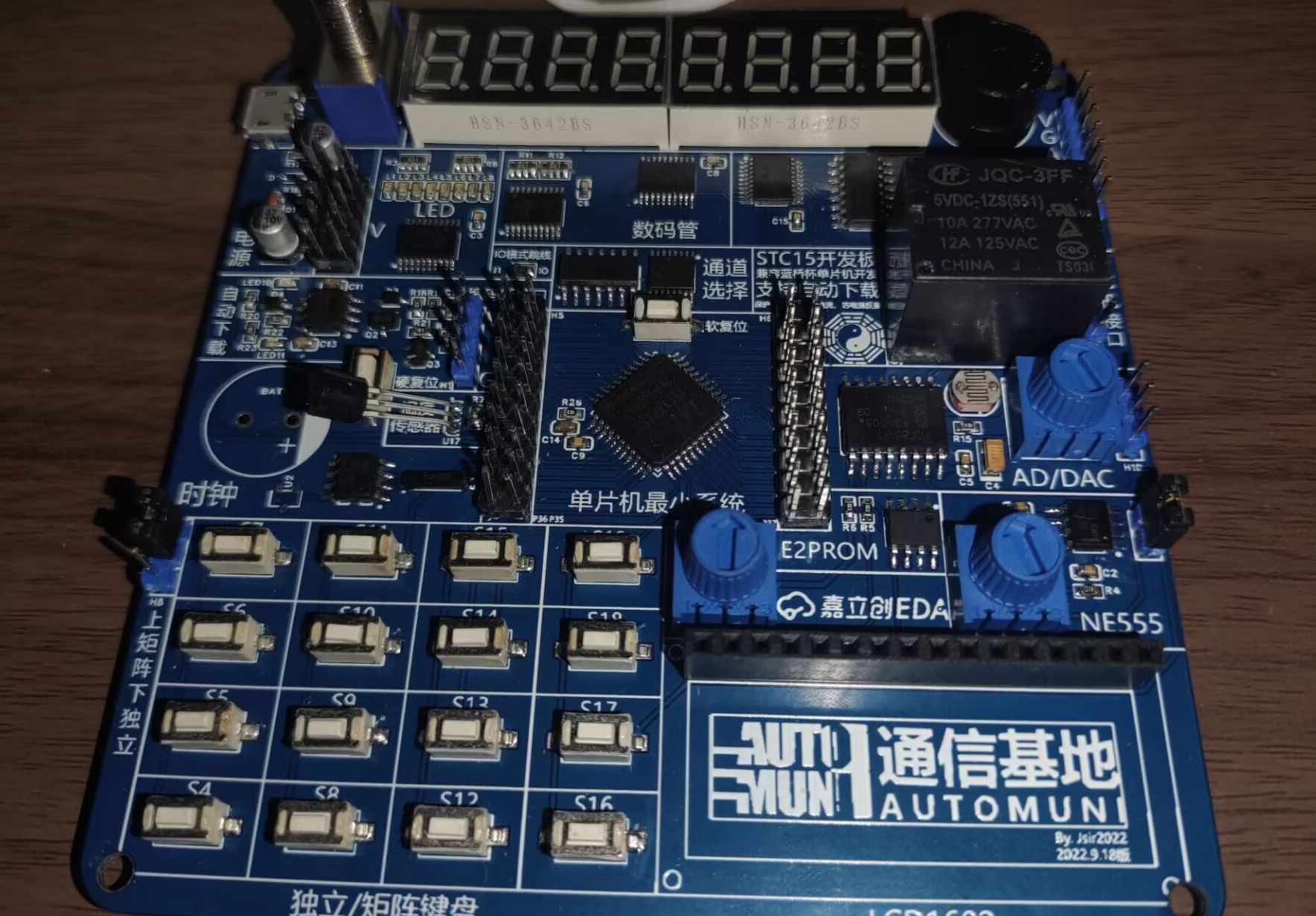

Mini Bluebridge MCU Development Board
1. Introduction to the development board
         IAP15F2K61S2 is used as the main control chip, which is functionally compatible with the Blue Bridge Cup MCU development board and has been improved. Improvements: 1. The matrix keyboard does not use P30 and P31, which solves the problem of being unable to debug online when using the matrix keyboard; 2. An automatic download circuit is added to solve the problem of frequent power switching.
2. Development board module
1) Minimum system of the MCU, with all pins brought out
2) 8-bit LED running lights
3) 8-bit digital tubes
4) 4X4 matrix keyboard, compatible with independent buttons
5) 1602LCD screen
6) Buzzer, stepper motor, relay
7) DS1302 real-time clock
8) NE555 waveform generator
9) EEPROM storage module
10) DS18B20 temperature sensor
11) Servo, encoder interface
12) Serial port automatic download
