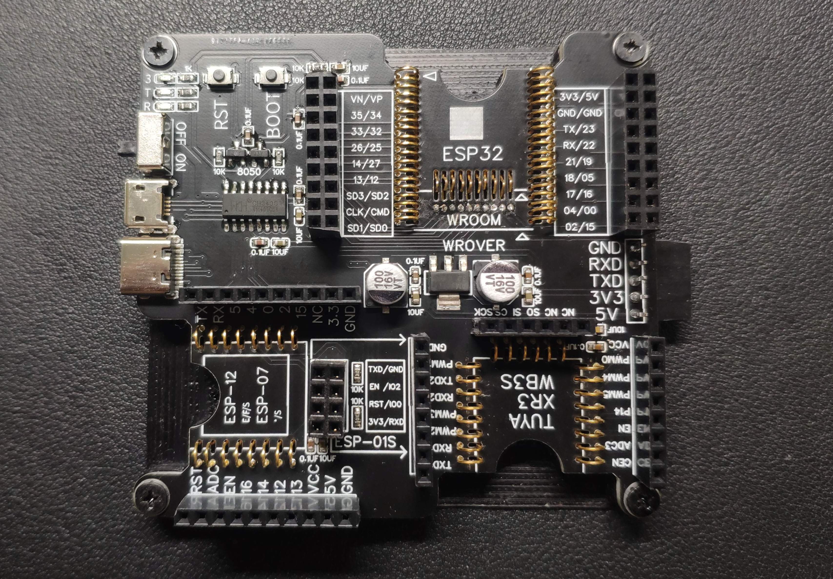

All-in-one programmer supports ESP32WROVER and WROOM
Added ESP-32 WROVER support
CH340C automatically burns, supports TTL output, TYPE-C+MicroB input, and can be used as a development board
Supported modules:
ESP-32 S/WROOM/WROVER
ESP-12 */E/F/S
ESP-07 */S
ESP-01 S
Tuya: XR3/WB3S
Modified from:
12344321A
ncfws
modified content:
Added ESP32-WROVER support
Added PCB protection board,
modified TTL output line sequence,
modified button model,
modified copper layout
, optimized IPEX antenna module burning experience,
optimized text and layout
, fixed BOM table CH340G error (CH340C)
Attached:
The contacts are made using the test ring shown in the picture below
PCB board test point test beads gold-plated ceramic test ring circuit board test pins 1000 = 65 yuan
The 10 contacts shown in the green box need to be made by yourself into the shape shown on the right side of the picture below (this item can be ignored if ESP-32-WROVER support is omitted)
