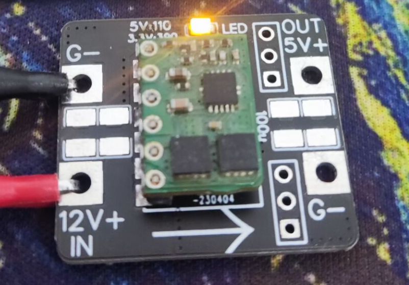

Based on ZTE ZXDN10 module,
it absorbs the open source engineering and optimization of netizens.
This module is easy to use and cheap. Go!
This module
is a server disassembly module made by ZTE. It only costs 2 yuan on Xianyu.
Input: 14V-8.3V
Output: 5.5V-0.6V
Maximum power: 24W (measured)
It advertises a maximum current of 10A, but when I tested it at 5V output, it was limited to about 4.4A.
How to use:
The leftmost foot should be connected to a voltage regulating resistor to the ground.
If the resistor is not soldered, it can only output a voltage of 0.6V.
There are two 100uF 50V capacitors for input and output respectively to suppress the interference of the upper 50hz.
It is recommended to use a 10K resistor for the LED.
Using 2K will be very bright.
It has been verified by the board
