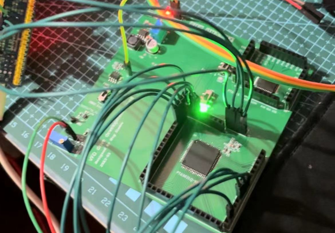

Universal VFD driver verification board
## VFD fluorescent display driver verification board
### 1. Preface
> In order to facilitate the verification of various VFD screens, such as segment screens and dot matrix screens. The power condition can be tested by writing a program.
The circuit is divided into the following parts-
Negative high voltage generation circuit, the voltage is adjustable (minimum -1.25V ~ -63.75V)
- Filament AC circuit, the potentiometer can adjust the current. PWM signals require external input-
The AC circuit is divided into two types of drivers, namely-
1. MX612E motor driver-
2. SL27517 gate driver IC-
Segment screen driver PT6315-
Dot matrix screen driver PT6302LQ (with font library)
- Dual-way switch, control the on and
off of two driver ICs- Cable lead-out
### 2. Reference driver code
**PT6302LQ: Github: https://github.com/ccy-studio/ESP32-VFD-V1**
