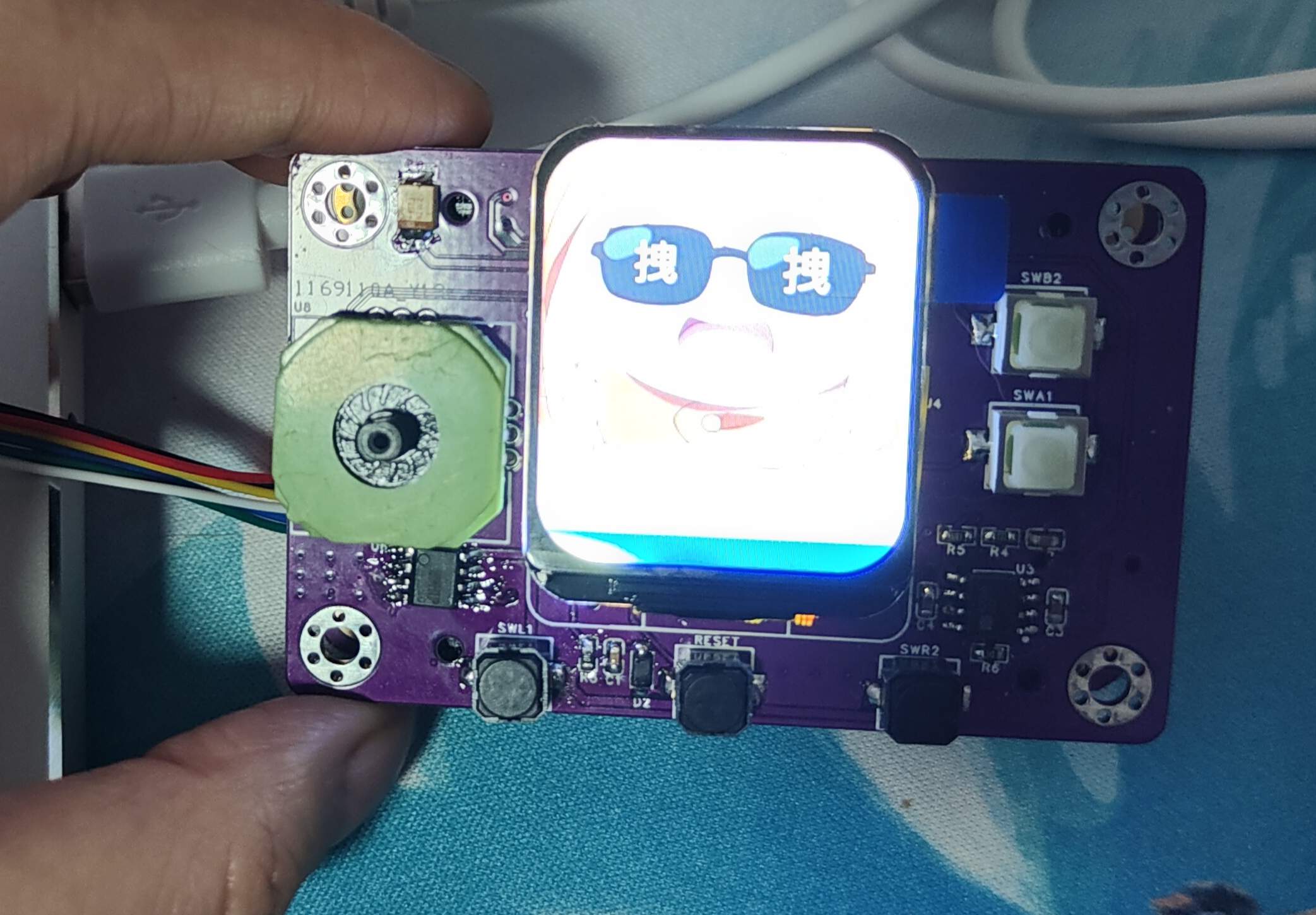

Use Liangshan School to develop a game console with buttons, touch screen, and can be used to transplant games such as Contra.
According to the official tutorial, screen pictures, text display, headphone audio playback, vibration and other effects have been achieved. The handwritten Snake is only half completed, and the NES game has not been transplanted yet.

remote sensing button was found on Taobao. It was not available in LiChuang Mall, so I had to draw a package myself; (**PSP game console 3D remote sensing button**), the directions of the two positioning holes of the remote sensing button in my PCB were drawn incorrectly, but it has little impact. When soldering, just cut off the two positioning protrusions on the button, which will not affect soldering.
Settings->System->General->Symbol Library Management->**Professional Mode**;
When drawing a package, the pin size should be slightly larger than the drawing size. For example, if the original pin hole is 1.1mm, the inner diameter should be 1.2mm when drawing the package;
The remote sensing button is essentially two sliding resistors, which determine the direction by the voltage in the XY direction;
**Button** In order to save costs, no pull-down resistor is drawn;
**Power supply**: Use LiChuang open source power supply, search: 5V charging and discharging integrated battery module; (touch to turn on, long press to turn off); Link: [https://oshwhub.com/li-chuang-kai-fa-ban/5v-chong-fang-yi-ti-dian-chi-mo-kuai](https://oshwhub.com/li-chuang-kai-fa-ban/5v-chong-fang-yi-ti-dian-chi-mo-kuai)
Diode: Classic diode 1n4148;
**Note**: The **wire-to-board converter** of the speaker and power supply in the schematic diagram is not well selected. You can change the model. Be sure to check the physical picture in the LiChuang Mall before selecting the model, otherwise it will be difficult to weld.

## If the screen does not light up, how to troubleshoot
1. Check whether the IO port is configured correctly (you can buy a screen with pin headers for welding, and use Dupont wires to connect to the screen pins of Liangshan School, which can be used to rule out welding problems);
according to my experience, the first welding only turned on the backlight, and the screen would not light up. After welding back and forth many times, the wires on the PCB board fell off... Yes, the wires fell off... Three boards were scrapped. I ordered several more screens, and finally they lit up. It is recommended that beginners must buy several sets of components (especially screens), and generally they will not succeed at one time.
2. Is the initialization successful?
3. Is the wiring correct?
