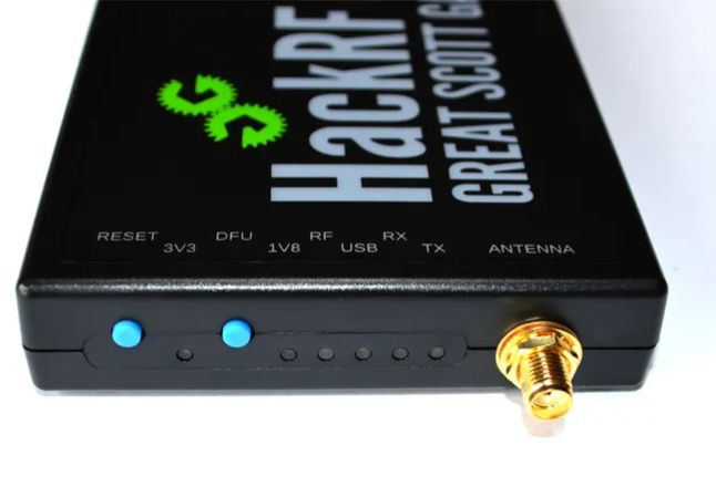

The HackRF One is a software defined radio peripheral capable of transmitting or receiving radio signals from 1 MHz to 6 GHz. Designed to enable testing and development of modern and next generation radio technologies, the HackRF One is an open source hardware platform that can be used as a USB peripheral or programmed for standalone operation.
Device Introduction1
MHz to 6 GHz operating frequencyHalf
-duplex transceiverUp
to 20 million samples per
second8-bit quadrature samples (8-bit I and 8-bit Q)
Compatible with GNU Radio, SDR#,
etc.Software-configurable RX and TX gain and baseband filtersSoftware
-controlled antenna port power supply (50 mA at 3.3 V)
SMA female antenna connectorSMA
female clock input and output for synchronizationConvenient
programming buttonInternal
pin header for expansionUSB
power
supplyHardware Design ArchitectureLPC4320
/4330: ARM Cortex M4 processor, main frequency 204MHzXC2C64A
: Xilinx, CoolRunner-II series CPLD, 1500
gatesMAX2837: 2.3GHz to 2.7GHz wireless broadband RF transceiverRFFC5072
: Mixer, providing 80MHz to 4200MHz local
oscillatorMAX5864: ADC/DAC, 8-bit, 22MHz sampling rate
Si5351C: I2C programmable arbitrary CMOS clock generator
MGA-81563: 0.1–6GHz 3V, 14 dBm amplifier
SKY13317: 20 MHz-6.0 GHz RF single-pole three-throw (SP3T) switch
SKY13350: 0.01-6.0 GHz RF single-pole double-throw (SPDT) switch
