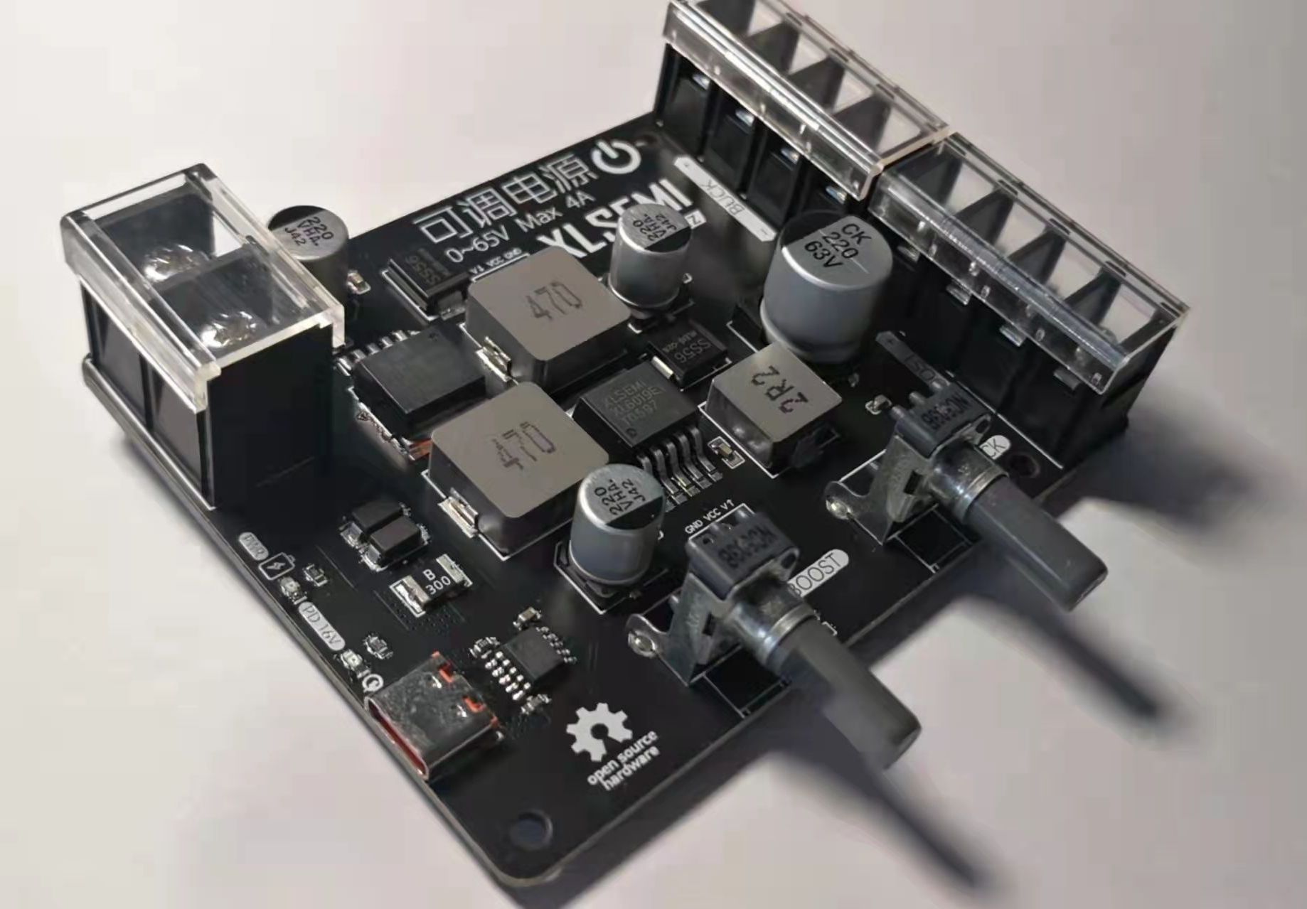

Based on this project modification, the defects such as package confusion, silk screen masking, high current routing, BOM matching, etc. have been improved.

1.0 Finished
desktop adjustable power supply, maximum 65V 4A output.
Supports external voltage meter.
The input part supports 24V terminal and PD fast charging 16V automatic deception
USB anti-backflow, 3A fuse protection
4P terminal output convenient wiring
application scenario:
electronic DIY
motherboard/notebook/mobile phone repair
high-power equipment test
electric race module
outdoor battery use
circuit part has not been greatly modified, step-down XL4015, step-up XL6019, two parts are independently connected in parallel. Fast charging deception uses Qinheng's chip, and the potentiometers are all on the same side for easy voltage adjustment. Use large-area copper plating for heat dissipation, and high power stability with heat sink.
Specific parameters:
Voltage input range: 4 ~ 37 V
Output voltage range: 1.25 ~ 60 V
Maximum current per channel: 4 A
Type-C input maximum current: 5 A (Please use 2P terminal for high power input, pay attention to heat)
Type-C loop fuse fuse current: 6 A
Input terminal: Type-C or 2P fence terminal
Output terminal: 4P fence terminal * 2 (boost/buck output separately)
Support external three-wire voltmeter
Boost part line sequence: Buck part line sequence:
Assembly: This is actually optional. Use silicone thermal conductive glue to stick the heat sink on the back (Figure 2), then put the two pieces together and connect them with copper pillars. For high power, you can also put a fan underneath.
The cable can be fixed with a crimping terminal (cold-pressed terminal), which is more beautiful.

C3032484 10 C237245 5 C203390 50 C192668 20 C51661 1 C3002735 2 C3002693 1 C73018 1 C2909608 1 Some details: The inductor uses an integrated closed type, so the wiring is routed below. The two parts of the GND loop are completely connected, which will not affect the DIY power supply, but be careful when using it in other occasions. GPL 3.0 agreement, all commercial use is prohibited. I made it in my spare time when leading a club in the second year of high school. I am not very knowledgeable, so I hope you can give me some advice.
