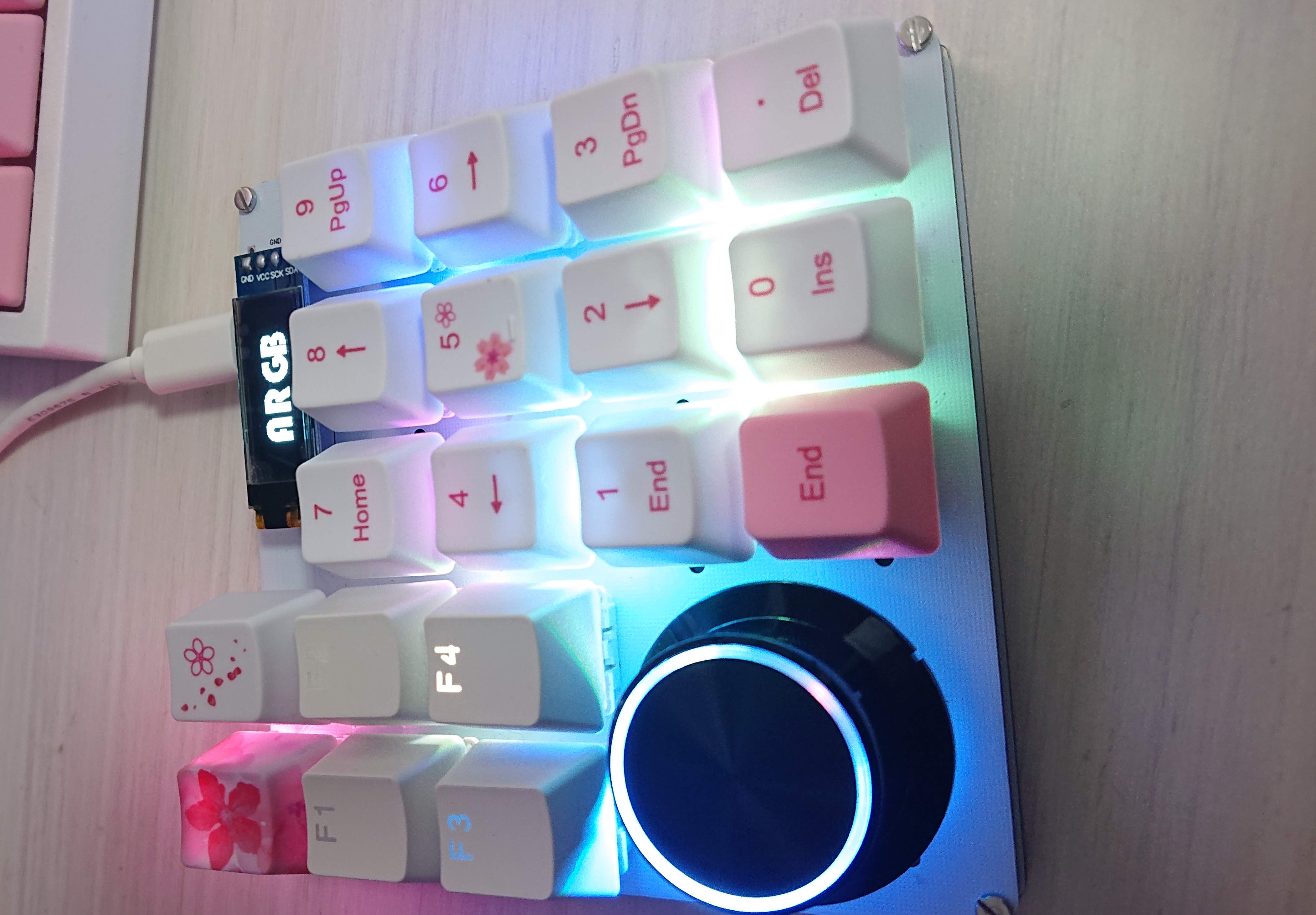

OLED knob keypad
The schematic diagram is modified based on https://oshwhub.com/hearme/ke-zhi-hua-xiao-xuan-niu-pad  , modify the matrix, add oled, remove 5050rgb, remove monochrome LED, add 3528 reverse sticker rgb.
There is no positioning plate installed in the picture, and the RGB is a bit overflowing.

A few points of disclaimer: The wiring is lacking, but the actual tests are all ok. Don’t criticize me for pad drilling, poor wiring, etc. I am open source and let you rewire it yourself.
Due to firmware size limitations , the fourth layer needs to be set in via to be effective. OLED has no display, it is recommended to put the power off button, keyboard reset button, etc.
Turn off mouse keys
New lite firmware will automatically clear eeprom, F24 implicitly clears eeprom. Suitable for matrix confusion and rgb confusion (there is a problem with the new version of via key mapping)
The firmware in the compressed package is normal firmware and will not be cleared automatically.
2021/03/19 Update firmware
Modify oled display, image + text
Modify lnksy to pad ( image created by yourself .
Modify bios to tool (image inspired by Microsoft Remote
argb (image comes from the Internet
2021/03/29
The r3r4 resistor is 22 ohms, not 22k. Wrong writing
2021/04/07
A self-restoring insurance has been added to the pcb, and the schematic diagram and BOM have not been updated (be sure to clean it after soldering, some soldering oil conducts electricity, causing the main control to burn)
2021/04/28
Optimize the code and add dial related (win10 roulette
2021/05/01
Add caps lock
dial add part. . . . .
(Only add, I don’t care if you can use it or not)
