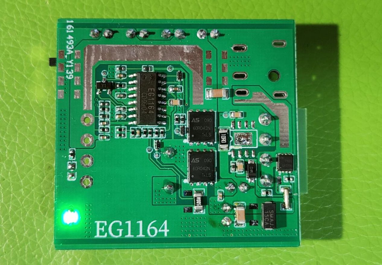

EG1164-based boost power module
Design parameters of this module (only for the current module design, the actual input and output parameters can be wider, the chip power supply is up to 20V, and the input greater than 20V requires a step-down circuit)
Input voltage: 10-16V
Output voltage: 15V, 19V, 24V Three-speed output
measured data:
Input voltage: 12V (11.52V on the board, 11.44V on the chip)
Input current: 4.942A
Output voltage: 24V (23.71V on the board)
Output current: 2.3A
Conversion efficiency: 95.8% (board efficiency)
Static power consumption: 12V, 0.041A
