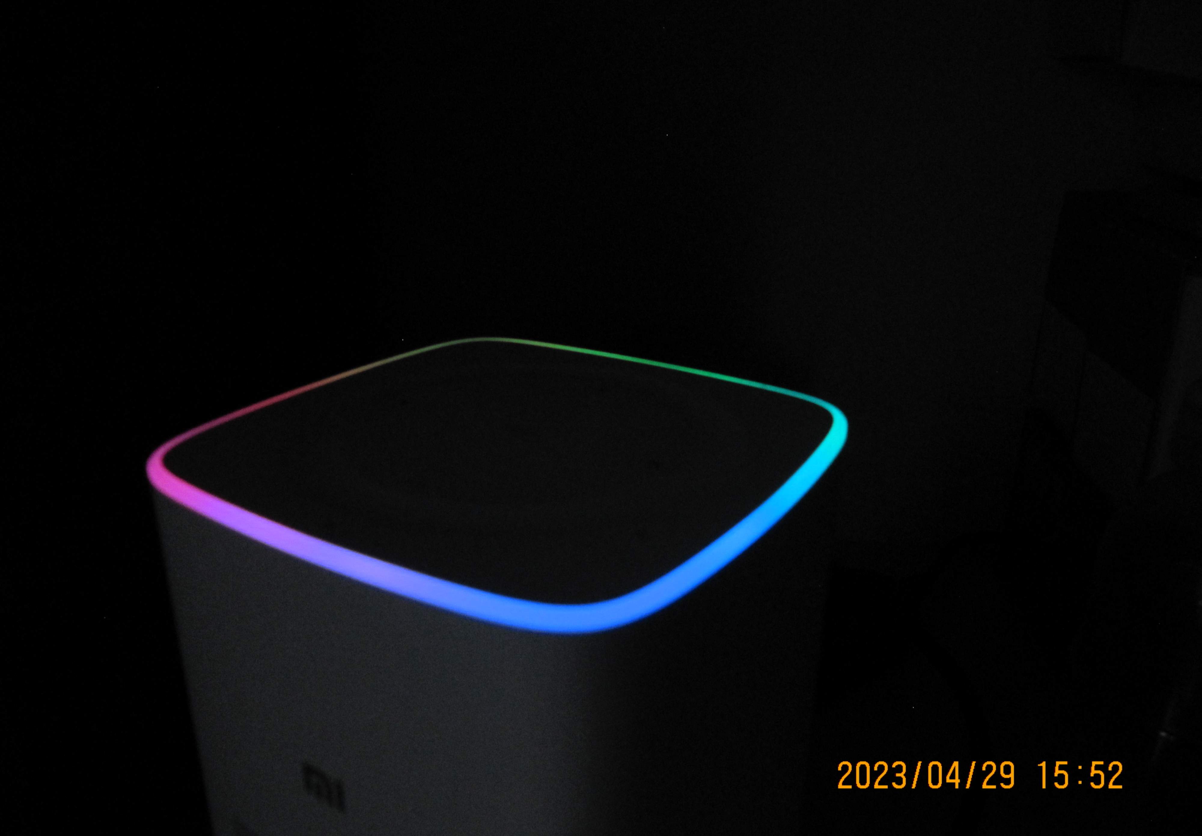

The light board has been successfully verified. (The total cost is less than 20 yuan.)
This modified light board is suitable for the classic version of Xiaoai speaker:
(that is, there are 5 touch buttons on the top and a touch ring for adjusting the volume, and there are light strips around it)
Note: All the directional words (up, down, left, right) in the text are the direction of the PCB on the computer display, that is, the direction of the PCB when the antenna of the ESP-12F module is placed to the left. It is currently found that the atmosphere light board will affect the networking process of the Xiaoai speaker when it is turned on. The solution is to not power on the atmosphere light board when the Xiaoai speaker is started, and the atmosphere light can be started after the Xiaoai speaker is successfully connected to the network (starting the atmosphere light after the network is successfully connected has no effect on the Xiaoai speaker responding to calls, playing music, etc.).
Instructions for use:
1. Use WLED firmware (provided in the attachment), and you can use mobile phones, computers and other devices to connect to the network after powering on.
2. It comes with an infrared receiver (either TSOP38238 or VS1838B, located at GPIO12), which can be controlled by a common 24Key or 44Key flat film RGB remote control (see the official website for the corresponding settings). It is recommended to weld, but it is also possible not to weld. When using the remote control, you need to be as close to the position of the speaker light strip as possible, so that the success rate of remote control reception is higher.
3. It comes with Hall (HALL), and an external magnet can be used to control the switch. A physical switch is required for the power input section, because the Hall can only disable the ESP8266 but not turn off the WS2812 colored lights. The Hall element can be welded.
4. The onboard ESP-12F module is used as the main control, and 12 WS2812b-5050 lamp beads are used as the light source.
5. The VIN-12V port at the notch on the left can directly input 12V, where the pin close to D1 is the positive pole, and the other side is the negative pole (reverse connection will not burn).

Usage effect:
