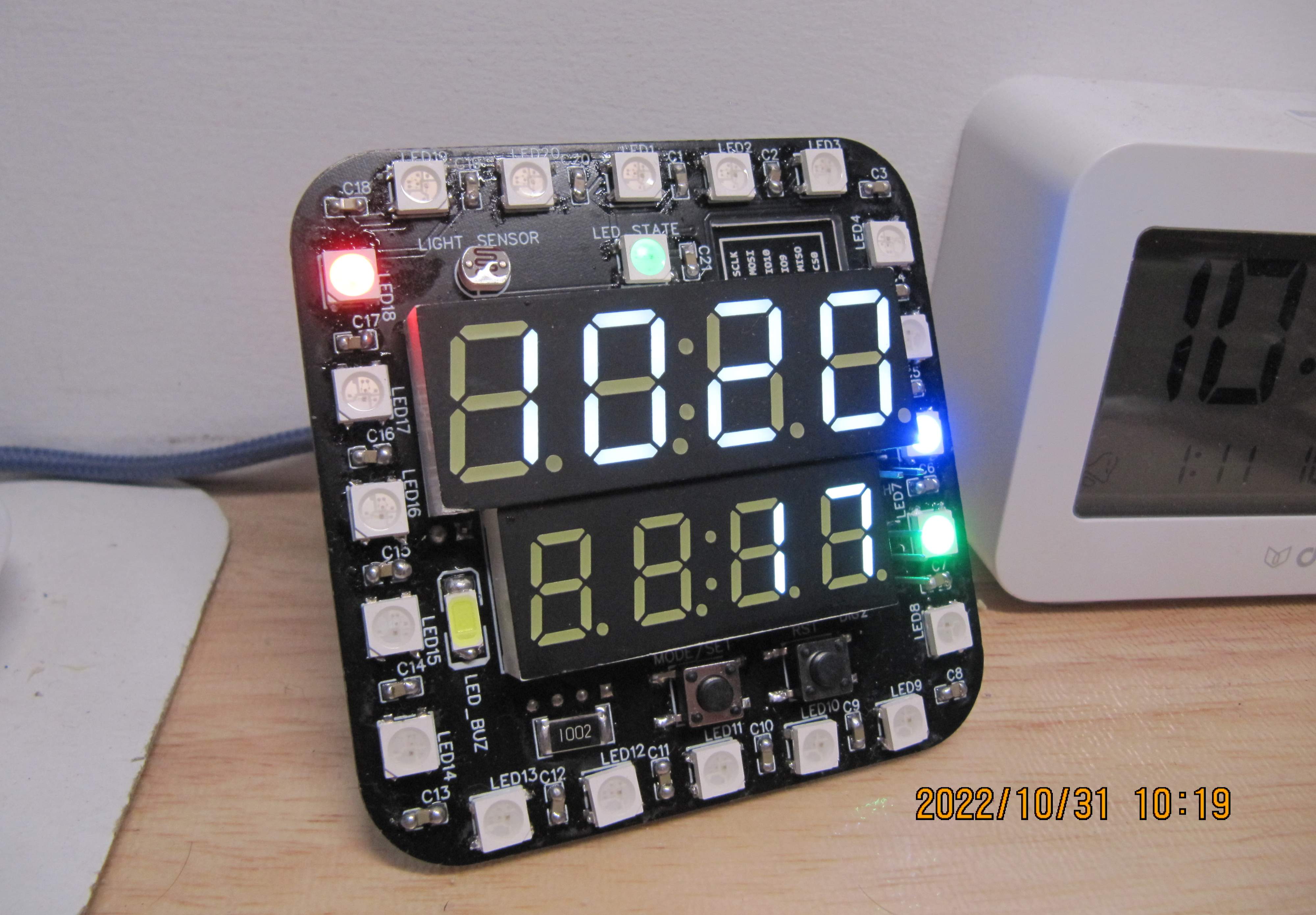

[Discontinued] WS2812 Ring Clock
Onboard resources:
  1 MAX7219
    (DIN-GPIO13; CLK-GPIO14; CS-GPIO15)
  1 DHT11
    (GPIO2)
  1 buzzer
    (GPIO4)
  1 22 WS2812b colored lights
    (GPIO5)
  1 photosensitive sensor
    (model: GL5528 (10K-20K), connected to the A0 pin of ESP-12F through a two-stage voltage divider circuit
        (first-stage photosensor + 10K resistor, second-stage 220K resistor + 100K resistor))
  2 buttons
    (one MODE/SET "universal" button (all functions are controlled by it, this button is a pull-up input, connected to GPIO12, can be set to INPUT_PULLUP),
          one RST reset button)
  Master control ESP-12F module
    (TTL TX, RX, GND are already brought out, GPIO0 and GND are connected to the "FLASH" jumper, and the power supply pins are also brought out on the back (with SS34 anti-reverse connection)
        to solve the problem of difficult soldering of MicroUSB vertical sockets)
The code has been attached and can be downloaded if necessary.

m=9:
The above is a schematic diagram of 10 modes.
How to use:
1. Solder or SMD components. (DIG1 is a 0.56-inch common cathode clock digital tube, DIG2 is a 0.4-inch common cathode clock digital tube. If a white digital tube is used, R1 should be above 100K instead of 10K, otherwise the brightness will be too high (I use 220K, the effect is good, if used at night, 680K is recommended; when soldering DHT11, please bend the pins 90° downward from the root (with the opening facing up), and then align them with the hole for soldering. If all goes well, DHT11 should cover the rectangle in the figure below))
2. First, use a jumper cap or Dupont wire to short-circuit the 2-pin pin with silkscreen "FLASH" (the new version uses the button with silkscreen "FLASH", press and hold the "FLASH" button and then power on, and release the button after the blue light of ESP-12F flashes; you can also press and hold the "FLASH" button and short-press the "RST" button after powering on, and release it after the blue light of ESP-12F flashes), then power on the clock, the blue light of ESP-12F will flash, indicating that there is no problem with the circuit construction.
3. Plug the USB to TTL module into the computer, and connect the TX, RX, and GND of the TTL module to the R, T, and G (cross connection) of the 3-pin pin with silkscreen "TTL" on the front of the clock (the new version of the TTL pin header is on the back), and open the device manager to record the port number of the current TTL module.
4. Open the Arduino IDE software with the ESP8266 development environment configured, press Ctrl+O to open the program file (MAX7219_PCB_Clock.ino), open the library manager, search and install the following libraries:
        AceSegment (0.12.0)
        AceSPI (0.4.0)
        NTPClient (3.2.1)
        DHT sensor library (1.4.3)
        Adafruit NeoPixel (1.10.4)
        WiFiManager (0.15.0)
5. After installation, first select the port just recorded ("Tools" > "Port"), then click Upload. If it prompts that there is no library file, copy the library in the attachment to the "Project Folder Libraries" folder and replace it, or modify the parameters according to the error message. (Sometimes you will encounter strange problems, such as "Error when compiling for xxx". The solution is to copy all the code, create a new draft, paste the code in, then save and upload)
6. Wait for compilation and upload.
7. After the upload is successful, unplug the Dupont wire or jumper cap that shorts the "FLASH" jumper (the new version uses the "FLASH" button, so you can skip this step), then press the "RST" button, the system should restart, both digital tubes will display "88:88", and all LEDs will light up in white. If any light or digital tube does not light up, check whether the solder joints are cold, especially the pins at the four corners of the MAX7219 (those four are signal pins, namely DIN, DOUT, CLK, and CS. The capacitor next to the WS2812 can be left unsoldered, but C22 next to the MAX7219 chip must be soldered! Due to signal communication reasons, the MAX7219 must have a filter capacitor. I once forgot to solder it, and the screen only flashed once. I thought it was broken at the time, but it was immediately fixed after connecting the capacitor) and the four pins of the WS2812 (the pads are very small, and it is difficult to solder with a soldering iron. The pad size can be changed as needed). Sometimes the digital tube will always be fully displayed when powered on, because the noise in the circuit mistakenly triggers the detection mode of the MAX7219. At this time, just turn off the power and then turn it on again. (The signal line in the PCB is bold)
8. If snd=false, DIG1 will display NS (No Sound) after powering on, and after waiting for a few seconds, all LEDs will go out; if snd=true, the buzzer will sound a prompt. Then LED_STATE lights up red and DIG1 displays "AP". After waiting for a while, you can use your mobile phone or computer (even Kindle) to search for the AP access point named "ESP8266_Clock" in the WiFi settings, connect and wait for the page to jump to 192.168.4.1. If not, manually enter the IP address. After the interface is loaded, click "Configure WiFi", select the name of your WiFi network (SSID) and enter the password, then click "Save". If the password is correct, DIG1 will display "GO" soon, and if the environment is bright enough, LED_STATE will light up green. If snd=true, the buzzer will ring 4 times after the network is successfully connected.
9. If there is sound and you want to mute it, or there is no sound and you want to turn it on, press and hold the MODE/SET key, then short-press the RST key, and release the MODE/SET key after the content displayed on the screen changes. At this time, ESP8266 will reconnect to the network and mute or turn on the sound. In other words, pressing and holding the MODE/SET key when booting can change the current sound settings.
10. If all the above steps are completed, then congratulations, you can now start using the clock. Press and hold the MODE/SET key until the screen displays the mode you want (see the table above for the mode code), then release it immediately (there is a 500ms mode switching interval in the program), ESP8266 will switch to the corresponding mode and write it to the EEPROM. The last mode will be remembered the next time it is started, and there is no need to reset it.
11. If the WiFi is disconnected in the time display mode (mode 0~mode 7), the screen and colored lights will go out, and LED_STATE will flash slowly in red. At this time, the system does not accept the MODE/SET key signal (that is, the key does not respond). After the network connection is restored, it will automatically reconnect and display the time (this clock does not have an RTC real-time clock module). If you want to change the network, press the RST key, the system will restart and display "AP", then you can use your mobile phone to re-configure the network. If the network is disconnected in other modes, LED_STATE will light up light red, which will not affect the current mode. In normal use mode, if the ambient light is bright enough, LED_STATE will light up light green.
12. The program has set the hourly time. If snd=true at the hour, the buzzer will sound 10 times (00 seconds to 09 seconds); if snd=false, the front LED_STATE and the back LED_BACKGROUND will flash blue for about 10 times (the original program will only flash about 7 times, and the video in the attachment is the original program). Note that this clock does not support setting the time range, so if you need to use it at night, please set snd to false to avoid disturbing your sleep, or change the program. (The time function in the program can be set in the variable definition (previous article))
