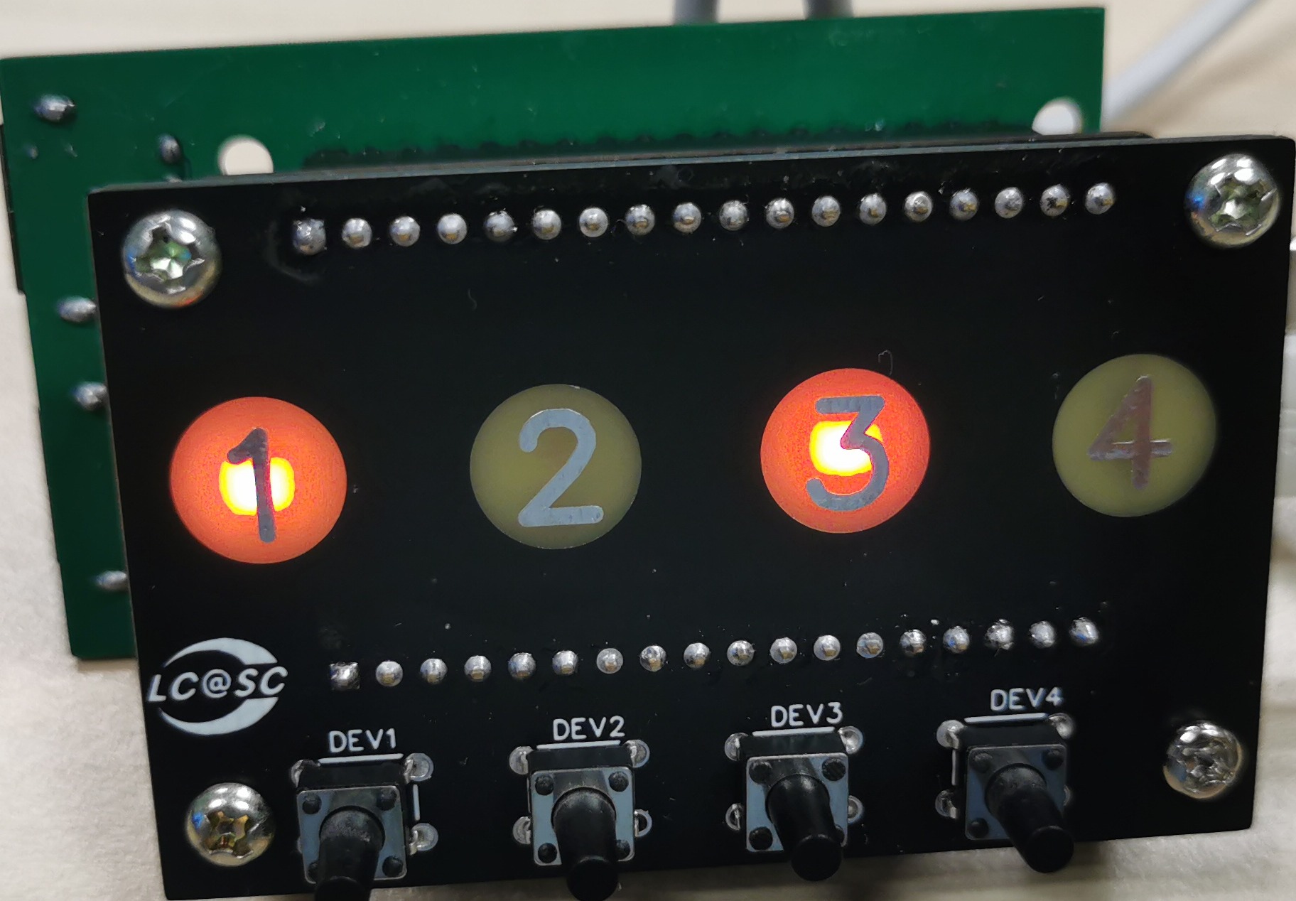

Next, we also need to design the part that interacts with the user. This part of the circuit is relatively simple. There are four buttons for selecting the currently working receiver, and four indicator lights for indicating the currently working receiver.
The PCB design is as follows. What is more interesting is that the LED is reversely pasted (the luminous part faces the PCB direction) on the back of the PCB, and then a solder mask is used here, so that light can pass through the PCB to illuminate the writing on the front.
It is a pity that the 3D preview cannot show this effect.
Real-life photography:
So we have three cards: FireBeetle, USB keyboard and mouse Shield and the user interface card above. Plug the three together to work normally. The above is the transmitter.
