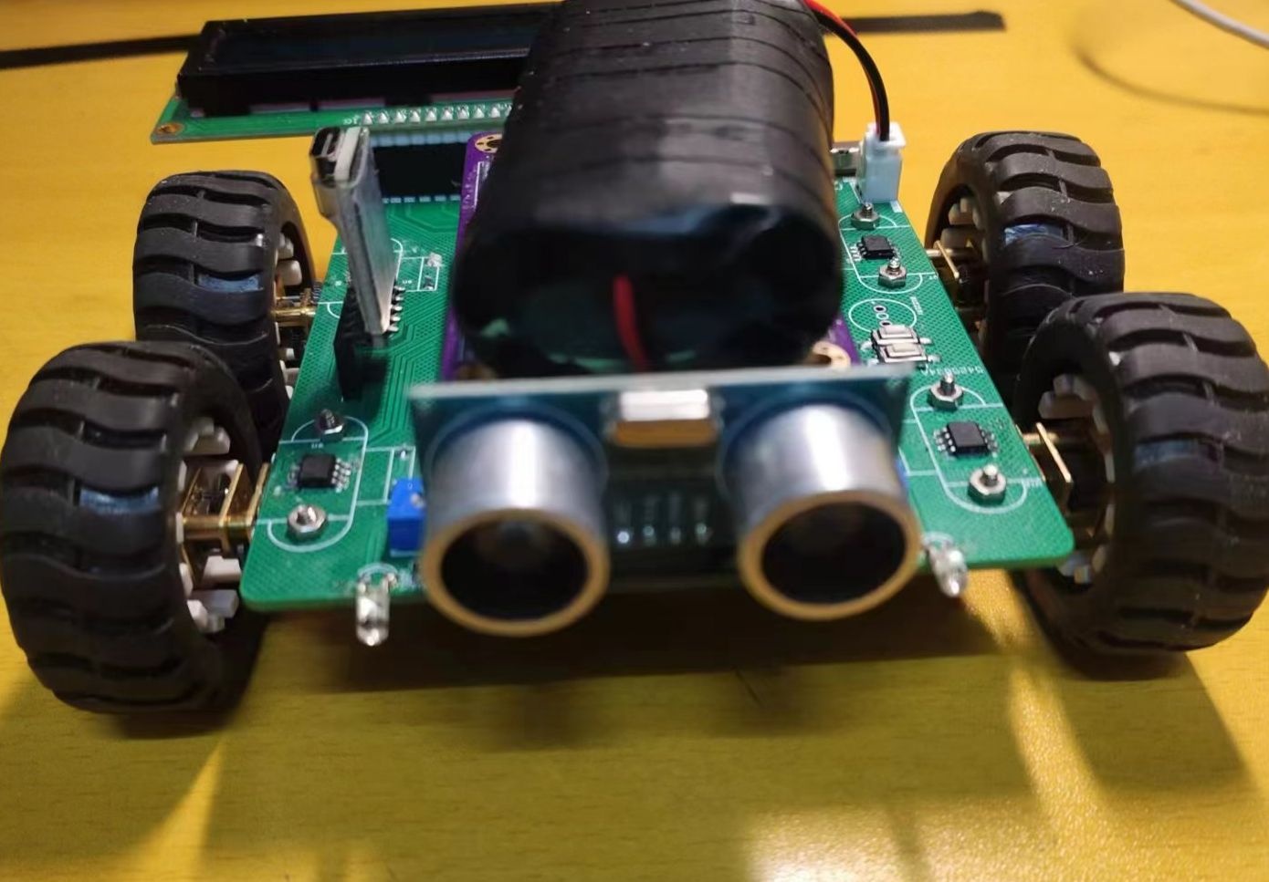

[Lichuang Development Board] Lichuang Liangshan School Intelligent Car
1. The smart car 2 based on Lichuang Liangshan School
is powered by a 7.4V lithium battery and driven by a motor. The chip uses L9110SM/TR
3, which has ultrasonic obstacle avoidance function
4 and two-way tracking! [Screenshot 2023-02 -23 231259.png] 5. An eight-wire LCD1206 module can be installed on the car. The data is displayed (successfully driven by STM32. RS, RW, EN need to be connected with pull-up resistors to drive. Lichuang Liangshan School is debugging Center)
6. Bluetooth remote control is integrated on the board (not verified)
7. The program implements tracking and obstacle avoidance
