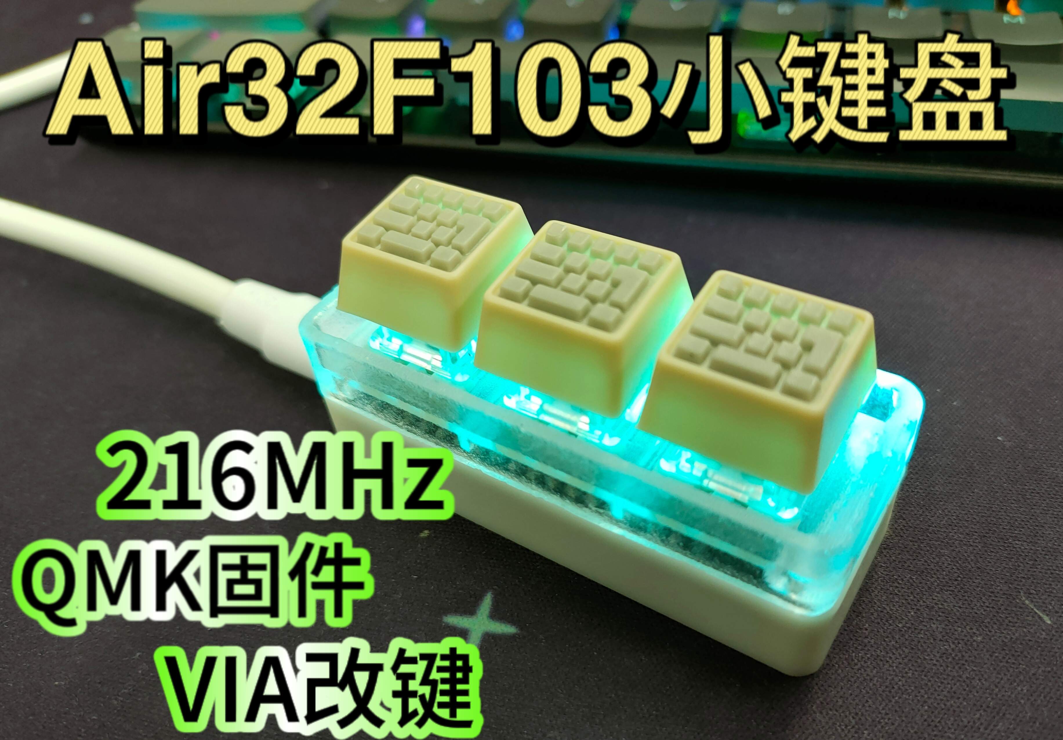

1. Finished product effect display
B station video link: [DIY] Colorful lights/custom key changes for quick use of three-button small keyboard_哔哩哔哩_bilibili

3.2 Hardware production
(1) Solder the Air32F103 development board as shown below. Note that due to the design of the shell, the two pins close to the USB do not need to be soldered. Because the work uses few pins, some unused pins can also be left unsoldered. It is good as long as the whole can be fixed.
(2) Put the board into the bottom shell and align it with the type-c port.
(3) Solder the components on the keyboard board as shown below
. (4) Install the soldered keyboard board on the bottom shell and solder it to the pin header of the development board. Screws can be added at the four corners to fix it.
(5) Install the keyboard shaft on the top shell. Note that the side with AIR32 inside faces the USB opening side of the bottom shell. Also pay attention to the direction of the shaft. There are magnets at the four corners that can be installed with magnets (not installed here). The imagined magnets can be attracted to the bottom shell screws to fix them.
(6) The top shell and the bottom shell are inserted together through the shaft (before installation, pay attention to whether the shaft is installed correctly again)
(7) It can be used after connecting to USB. The default keys are CTRL C V
