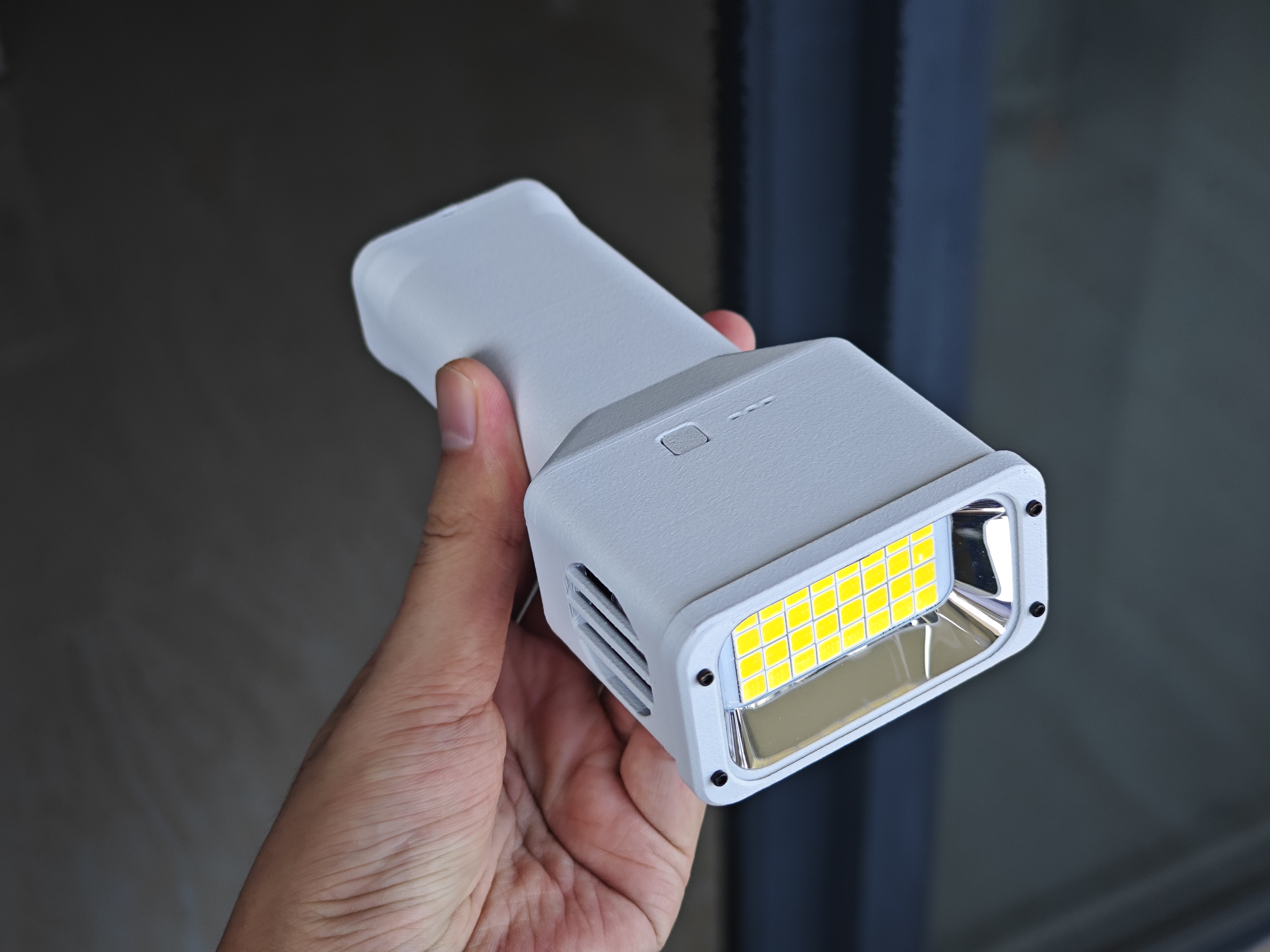

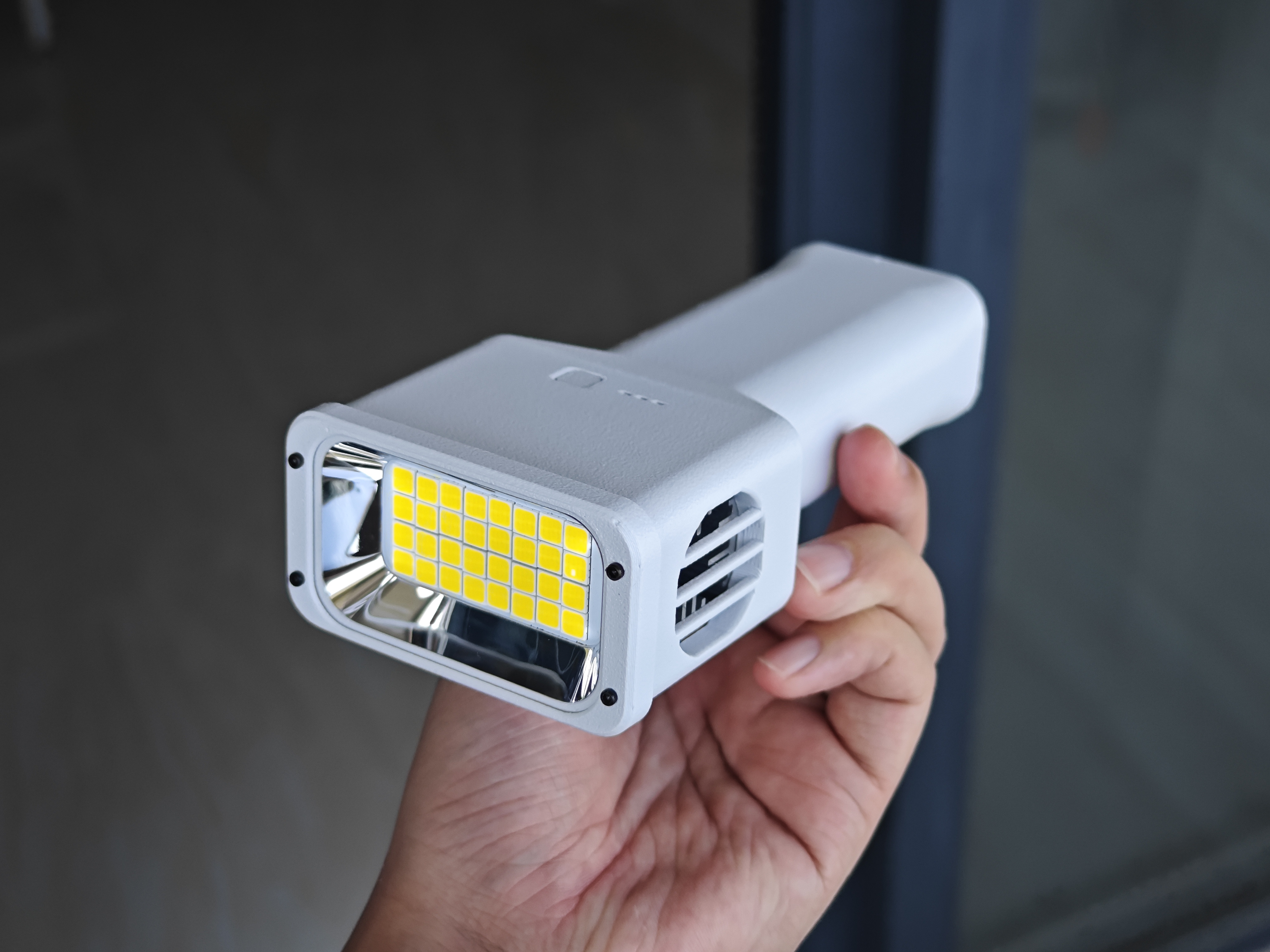

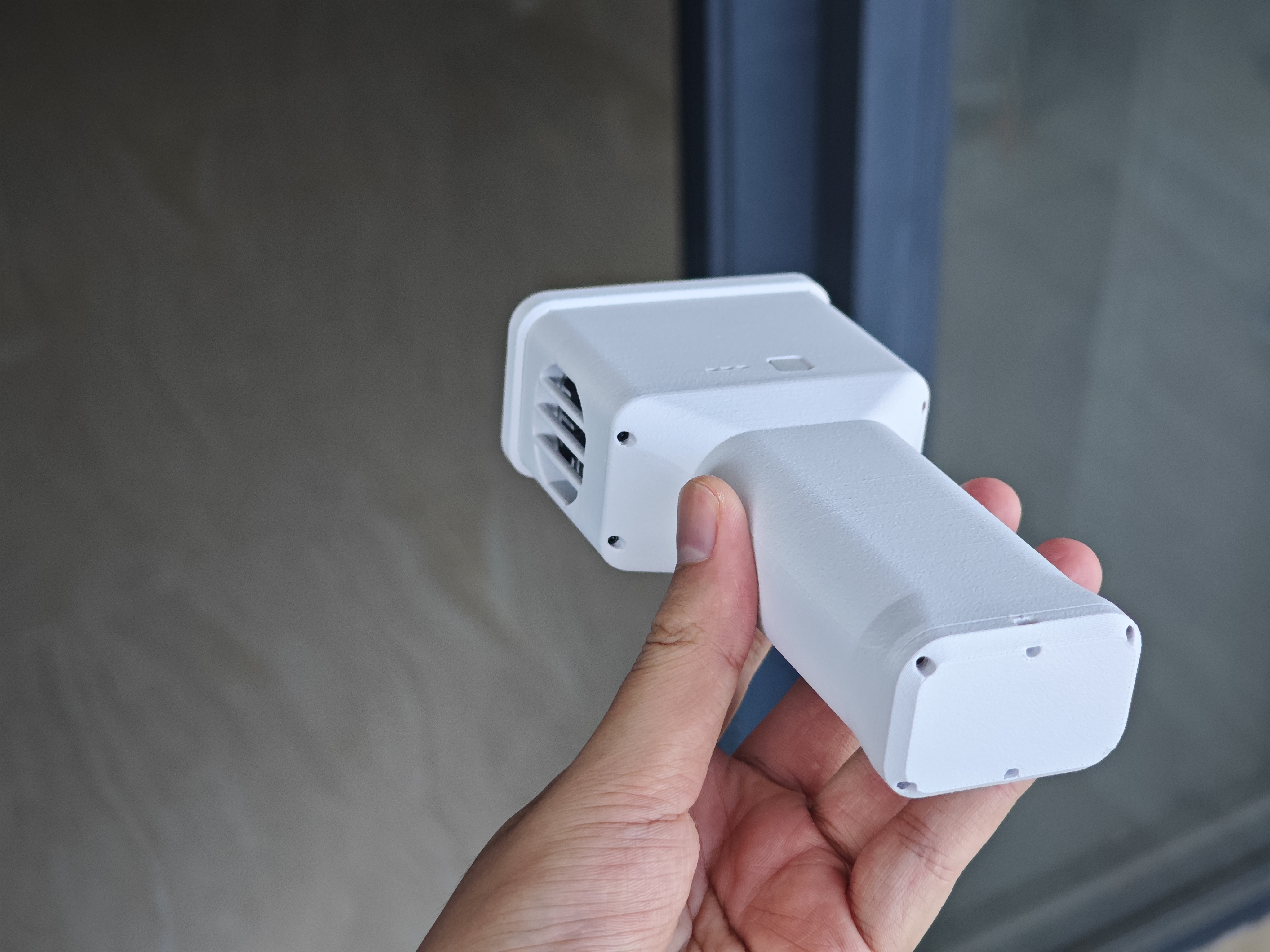

A constant 60 watts 10,000 lumen mini flashlight with a 60-watt beam.
The flashlight is named Light Hammer 60. It supports 45W Type-C charging and discharging, taking about one hour to fully charge. The 60W 10000lm setting doesn't drop in brightness or get hot to the touch. The 60W setting lasts about 27 minutes, the 30W setting about 54 minutes, and the 3W setting about 8 hours. The cost of replica materials is approximately 110 yuan.
Important: Mainboard thickness 1.0mm, LED board thickness 1.6mm.
Replica discussion group: 522608529.

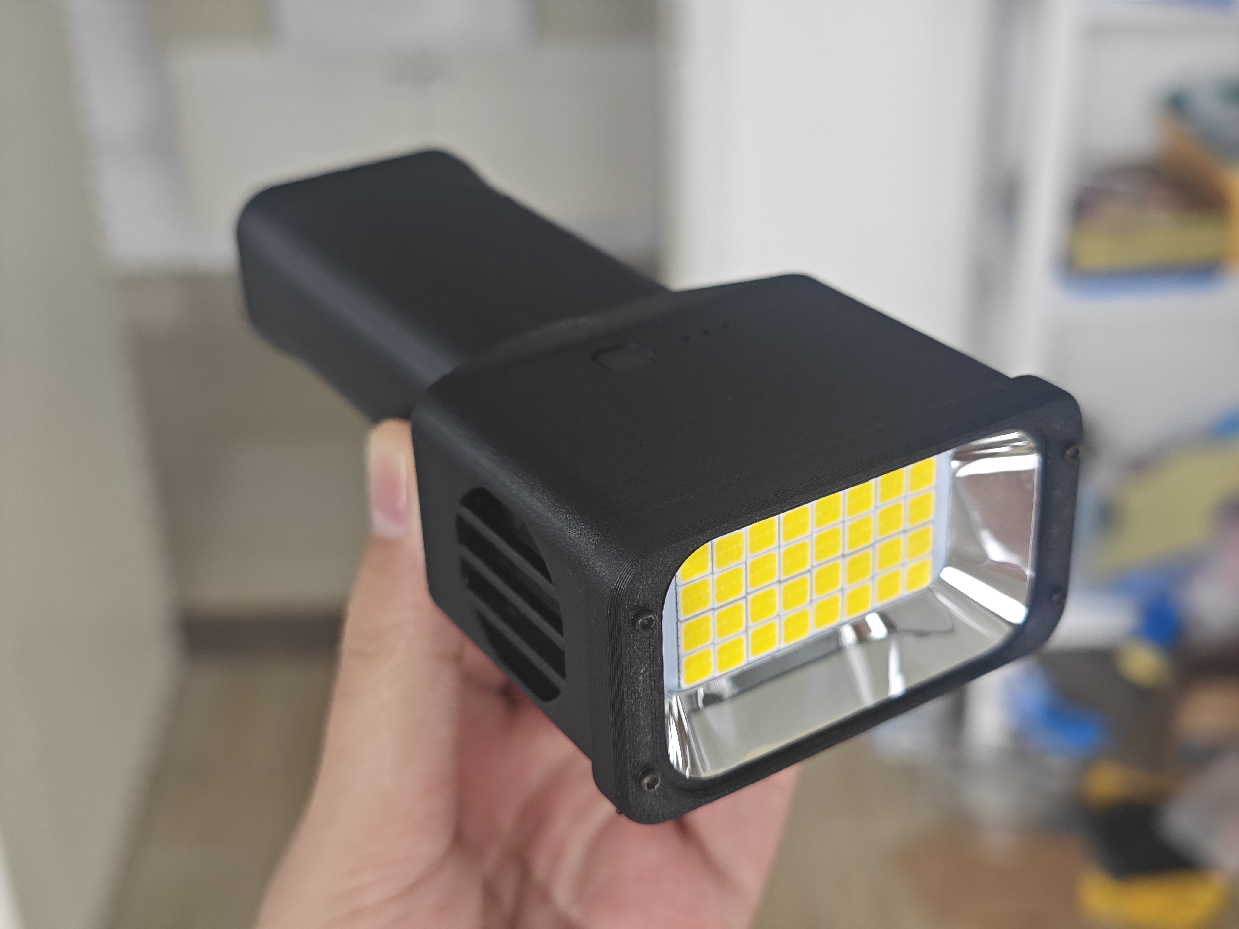

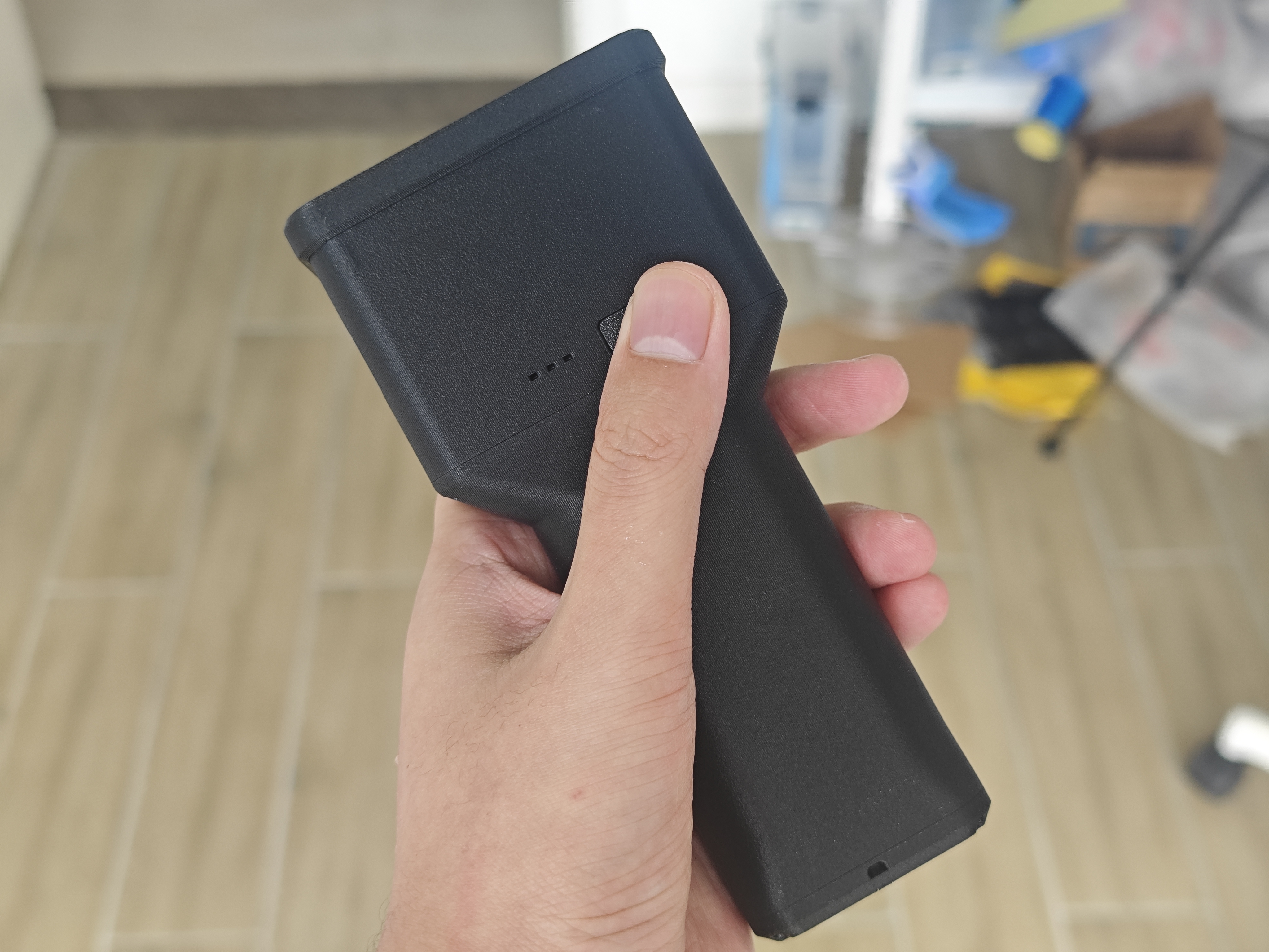

I. Finished Product Showcase
II. Related Videos:
The old man next door thought it was dawn again, hand-crafting a 60W 10000lumen mini-cannon: https://b23.tv/3IoZmZI
Light Hammer 60 Ultimate Wide Floodlight Night Road Test: https://b23.tv/5N2dky4

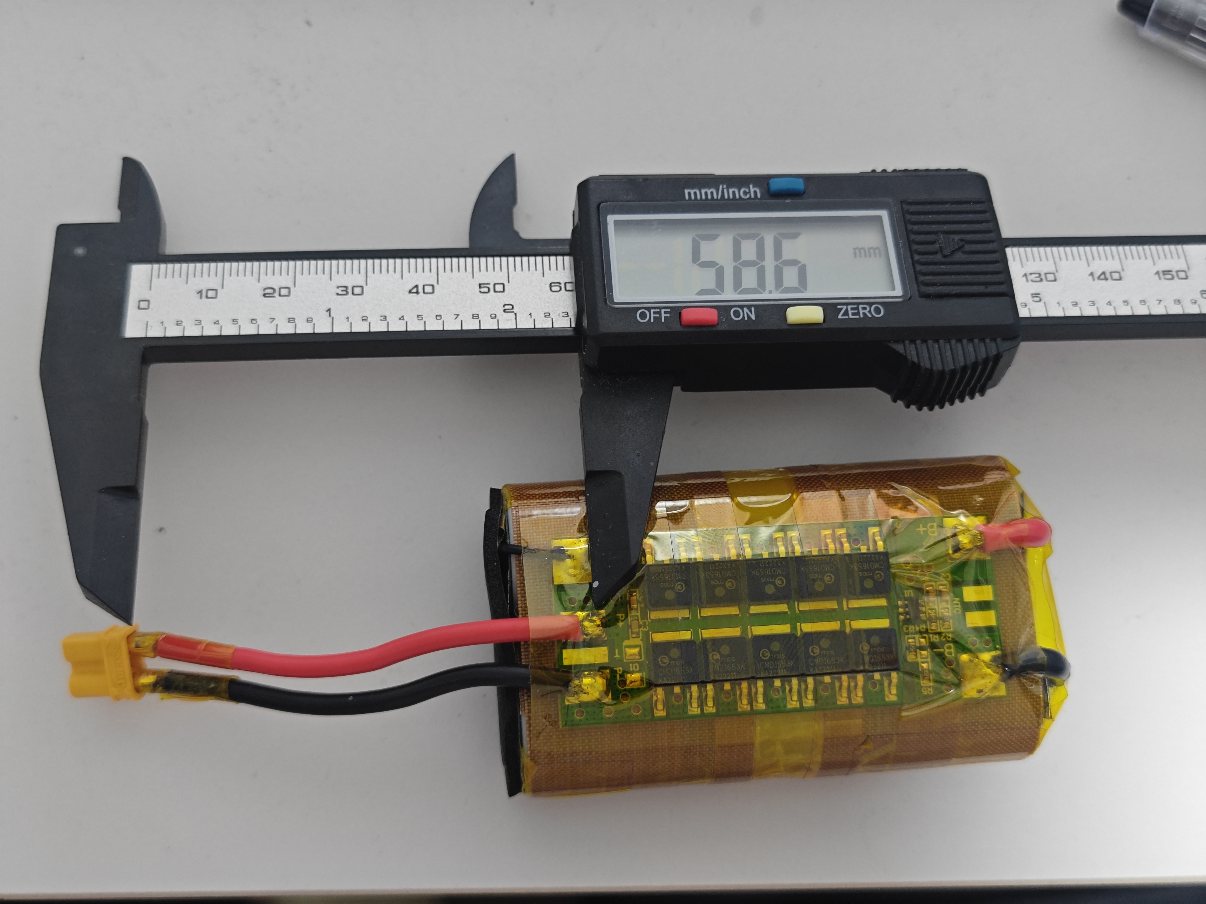

Battery Pack Materials:
If you don't want to make your own battery pack, you can search for "Light Hammer 60 battery" on Xianyu (a second-hand marketplace); there are pre-made ones available
. 2.1 Two 25A protection boards, 1 unit, 11.8 yuan: http://e.tb.cn/h.gs5WxIlzN5z2Jqd?tk=aOYw38mZktU
2.2. Two 21700 power batteries, such as Xinnengan JP40 and EVE 40PL.

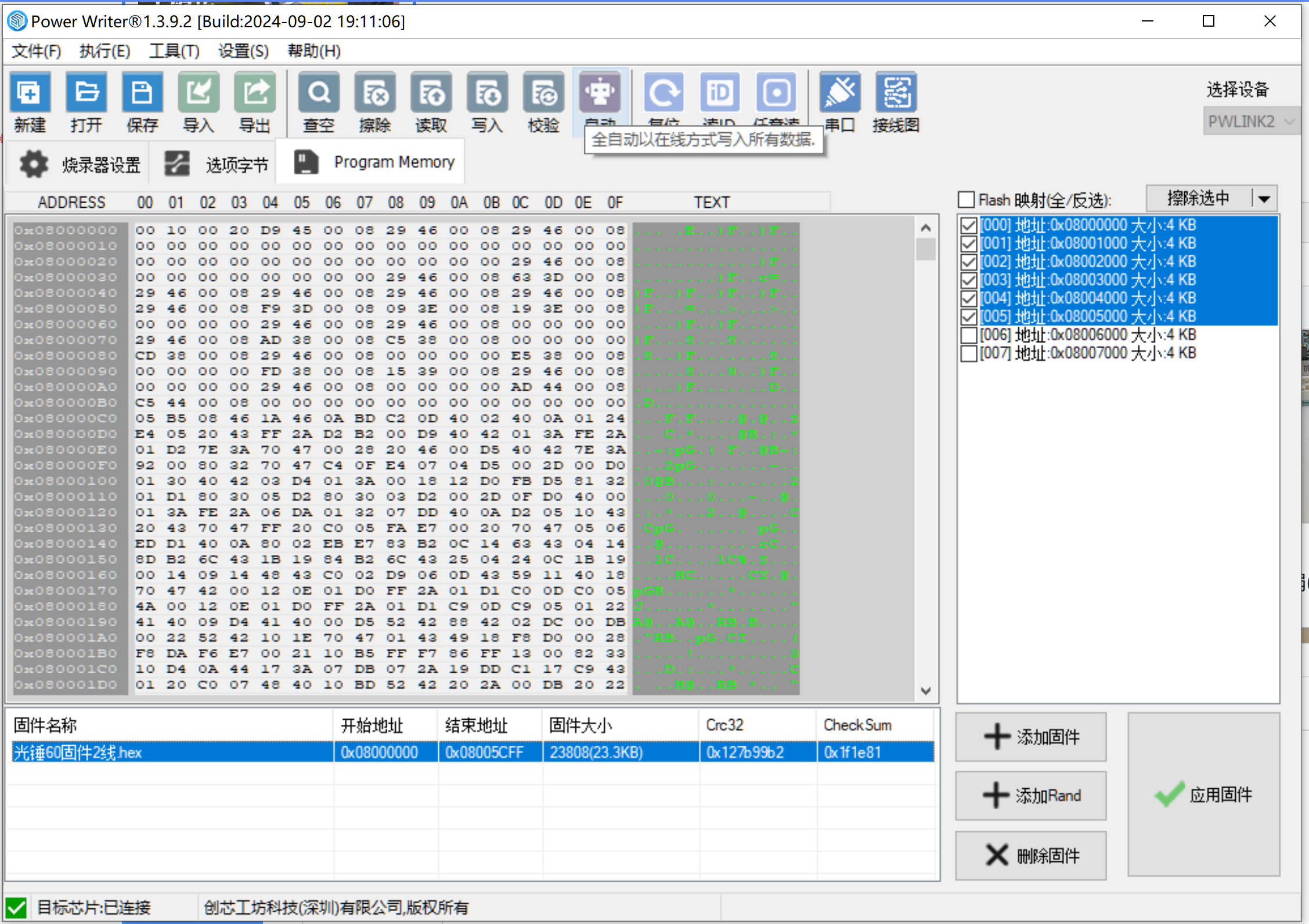

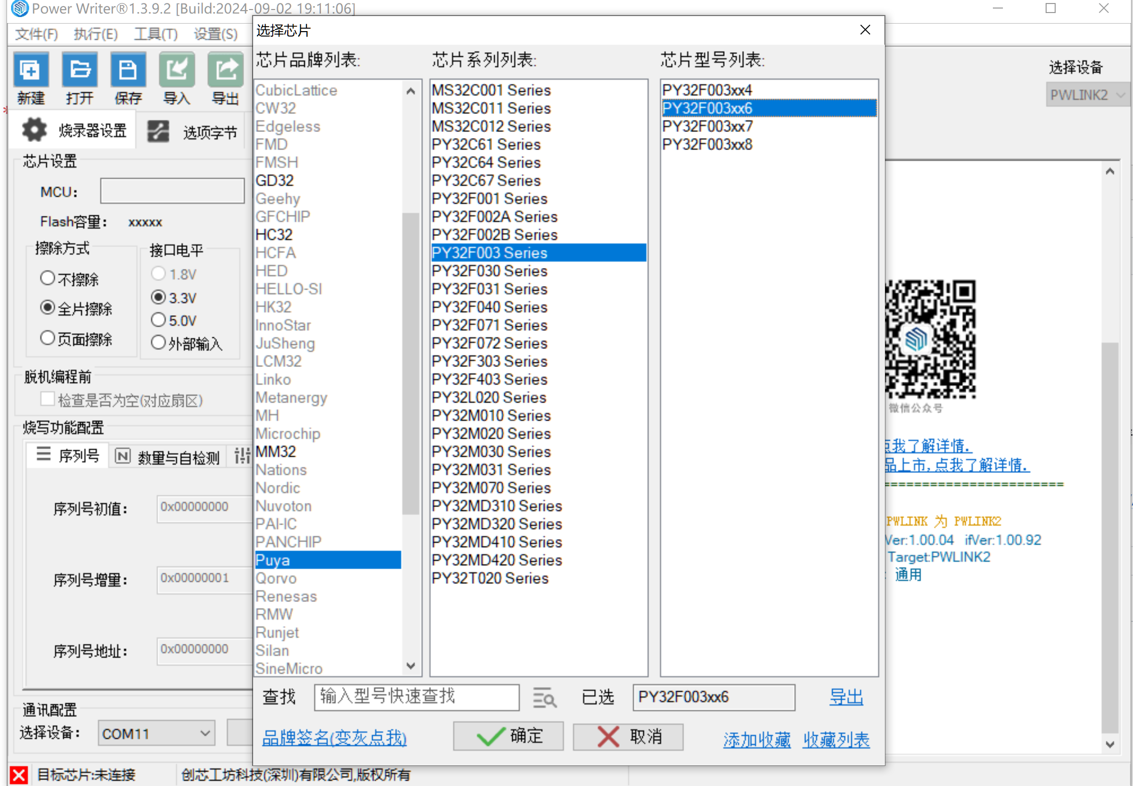

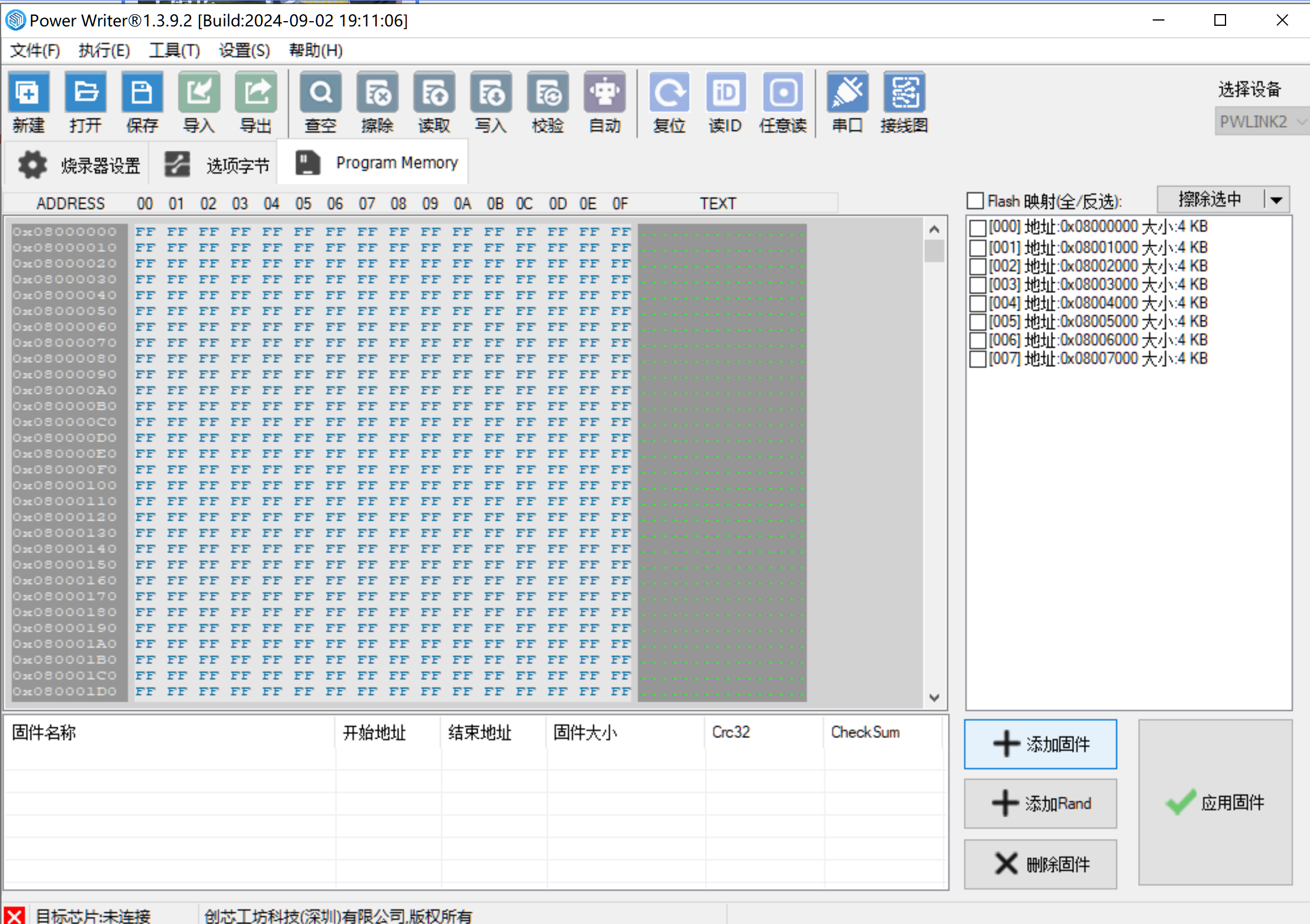

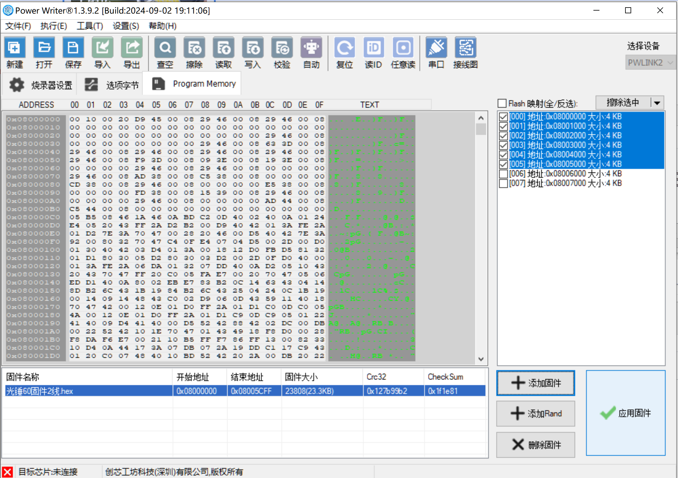

First, flash the firmware:
Download and install the PWLINK2 LITE (4.1) software Power Writer. Insert the PWLINK2 LITE into your computer and select the chip PY32F003xx6. If you cannot select this chip, please consult customer service.
Click Program Memory, click Add Firmware,
add the attached Light Hammer 60 Firmware 2 Line .hex, then click Apply Firmware.

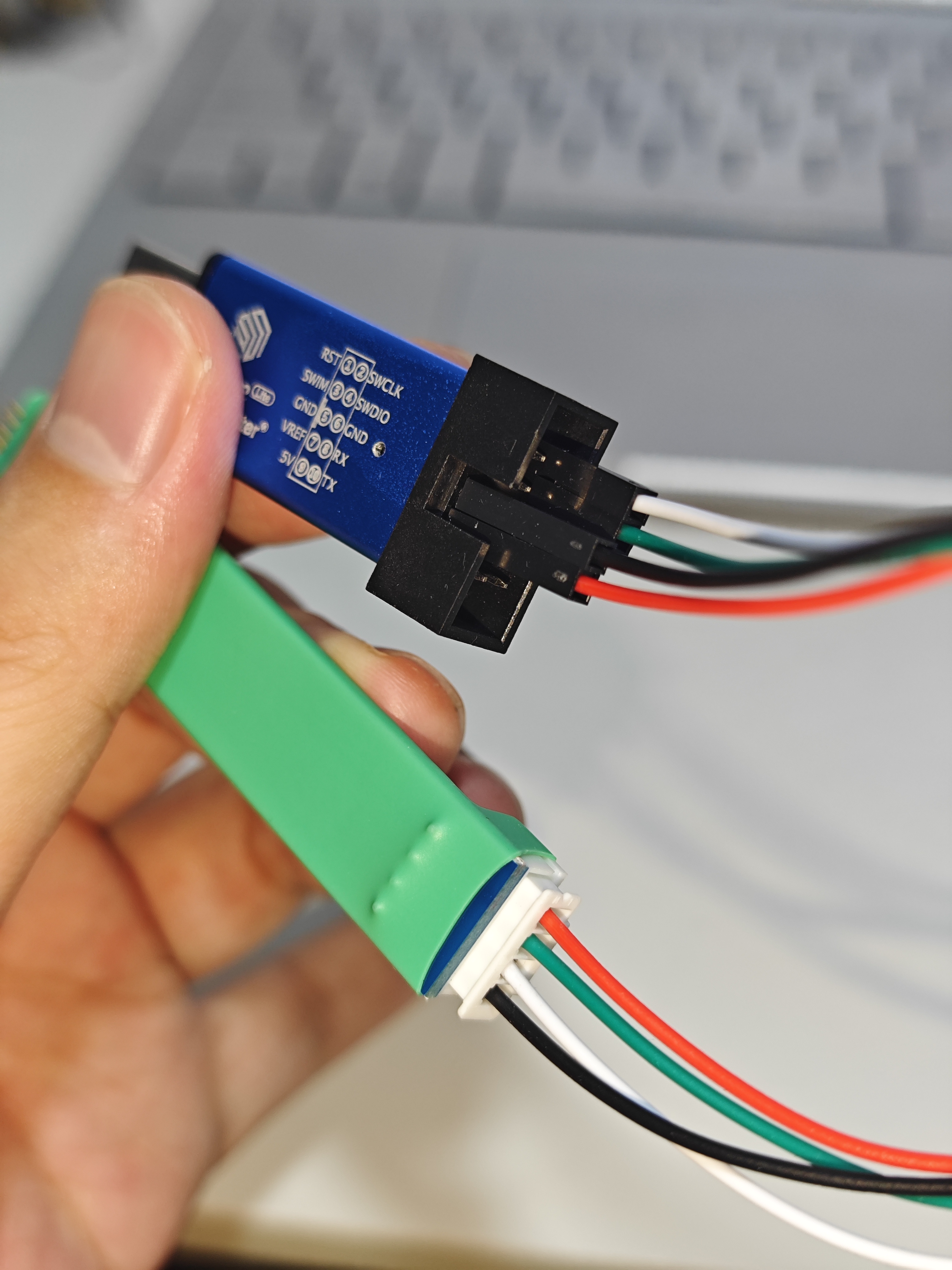

Connect the PWLINK2 LITE to the download probe (4.2). The wiring sequence is shown in the figure.
Attach the download probe to the motherboard download contacts. Note that the probe corresponding to the red wire should be aligned with the V contact, and the probe corresponding to the black wire should be aligned with the G contact. Reversing the alignment will cause the board to burn out.
After the target chip is displayed as connected, click Automatic to complete the flashing.

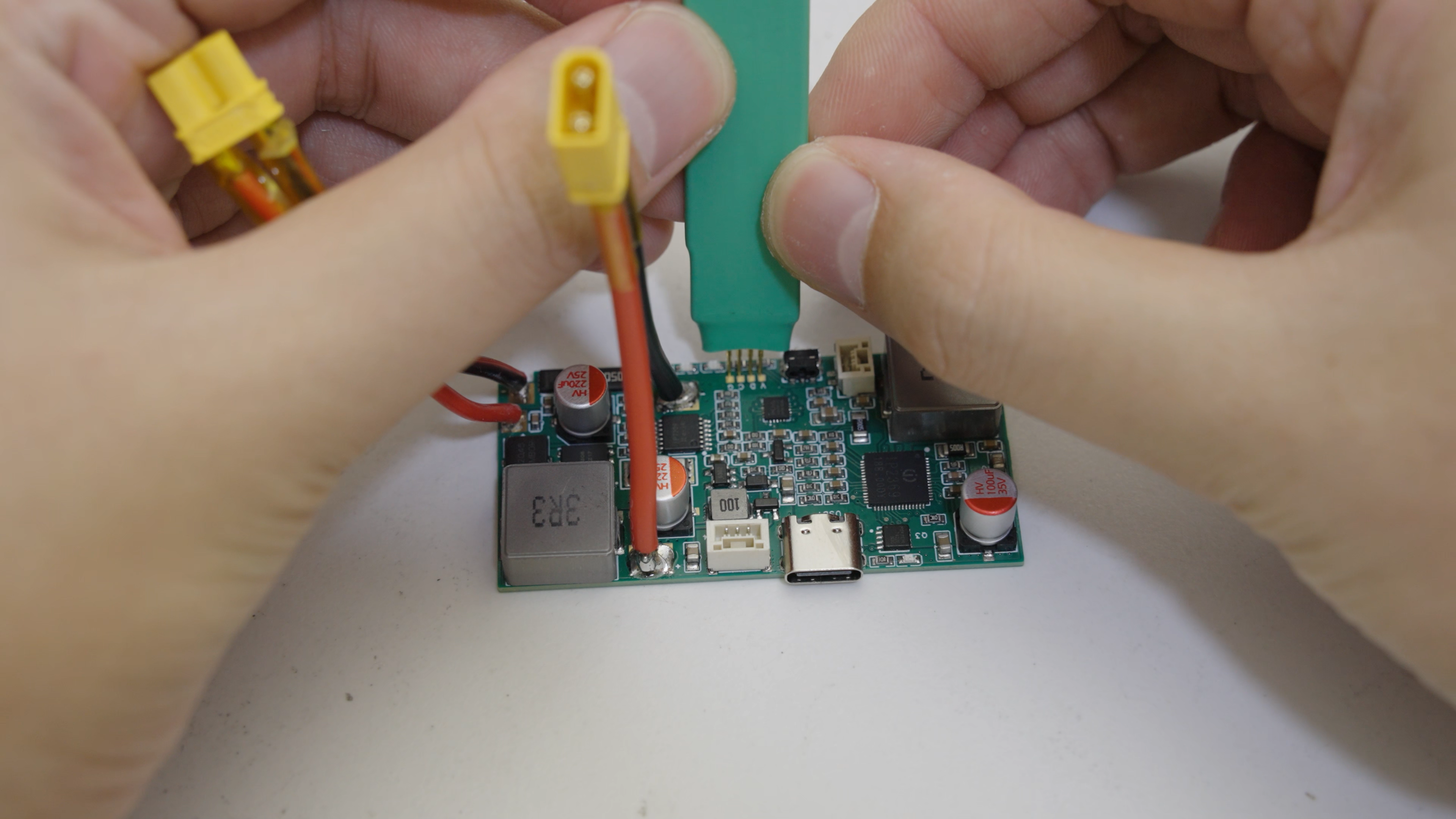

Solder the motherboard input line.

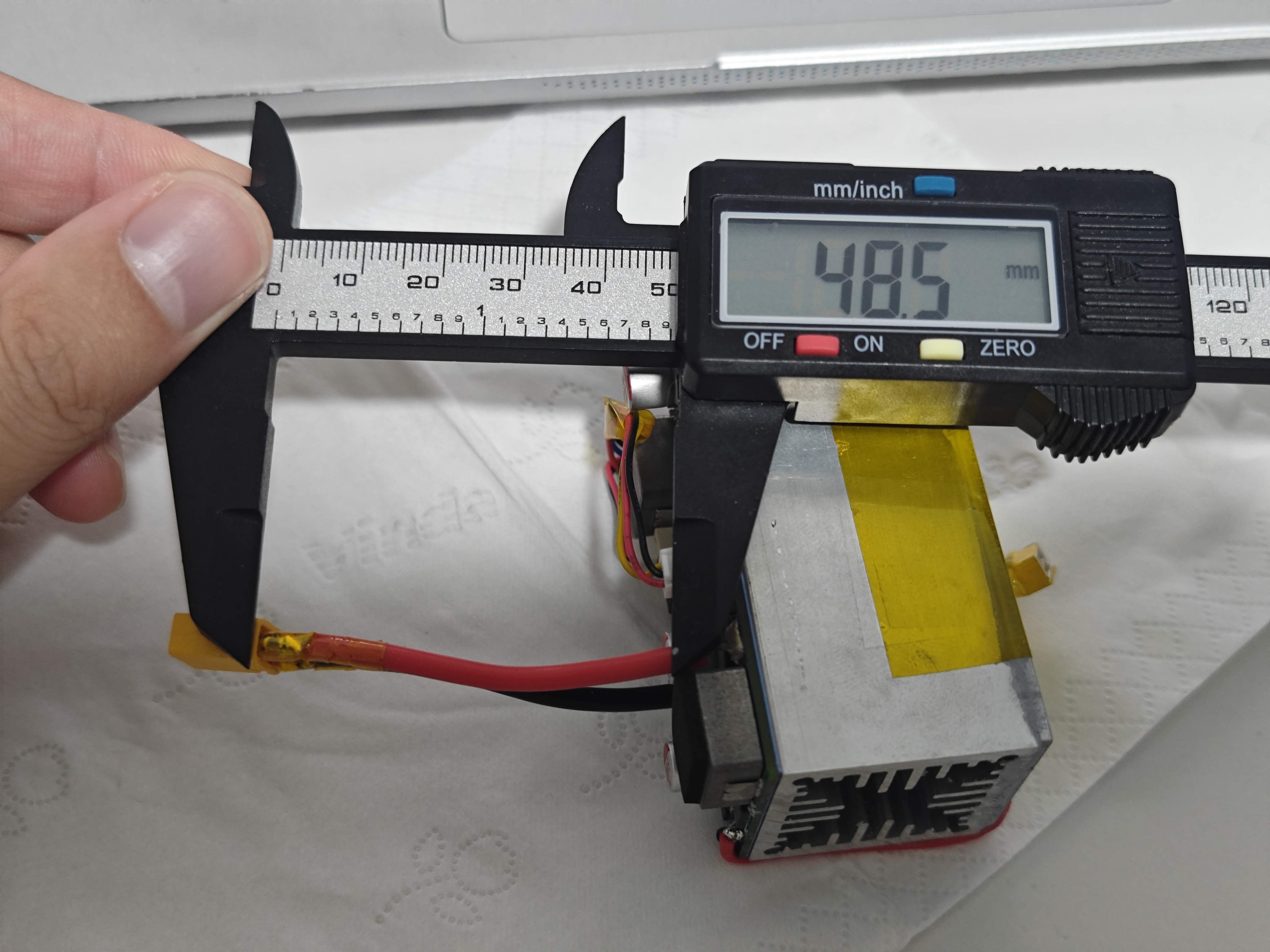

Use a 48mm long 16AWG silicone wire (3.8) to connect to the XT30 male connector (3.4). This length is just right.

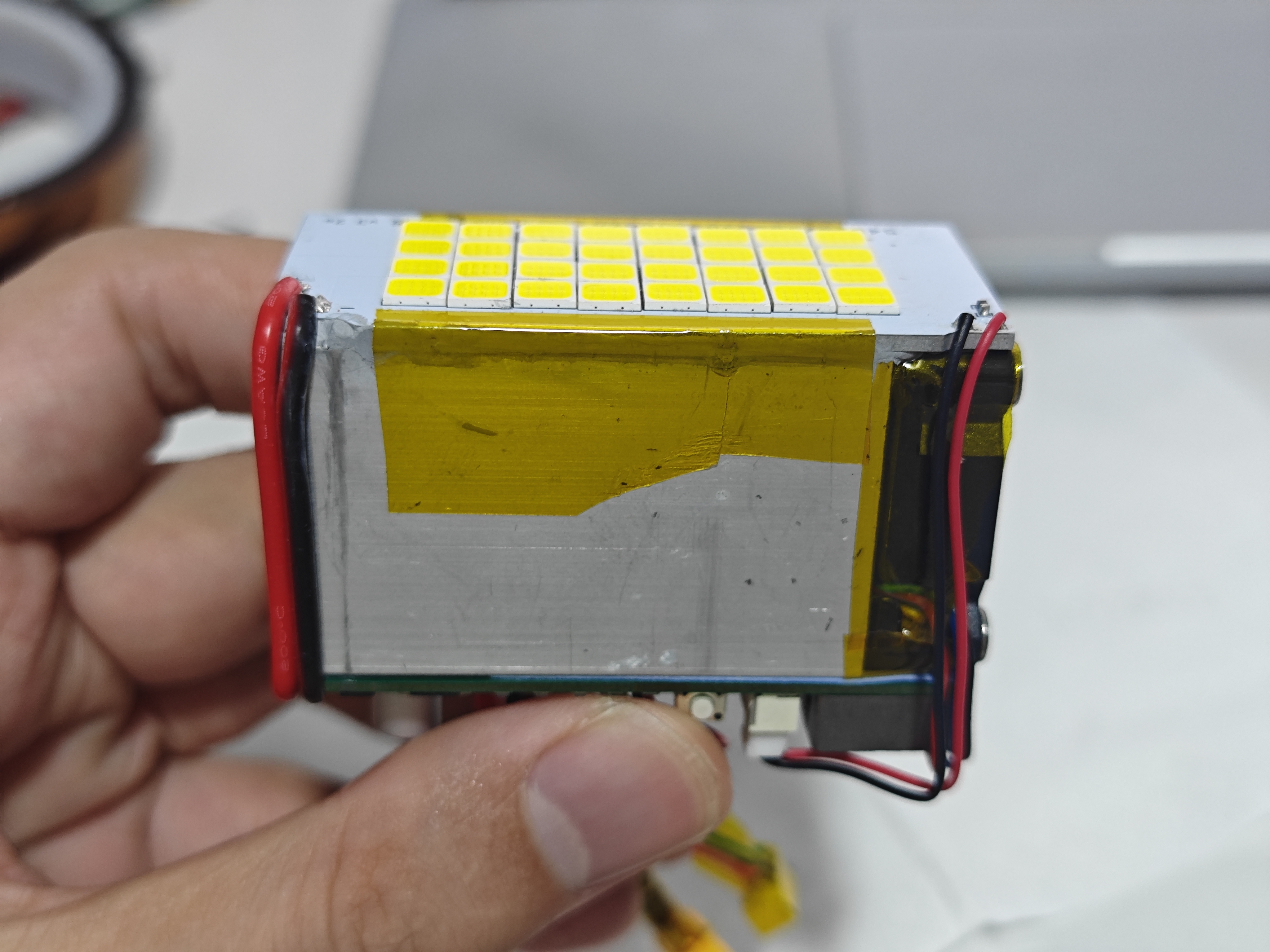

Solder the LED board wire.
Solder the 20AWG silicone wire (3.7) and GH1.25 2P wire (3.6) to the LED board.

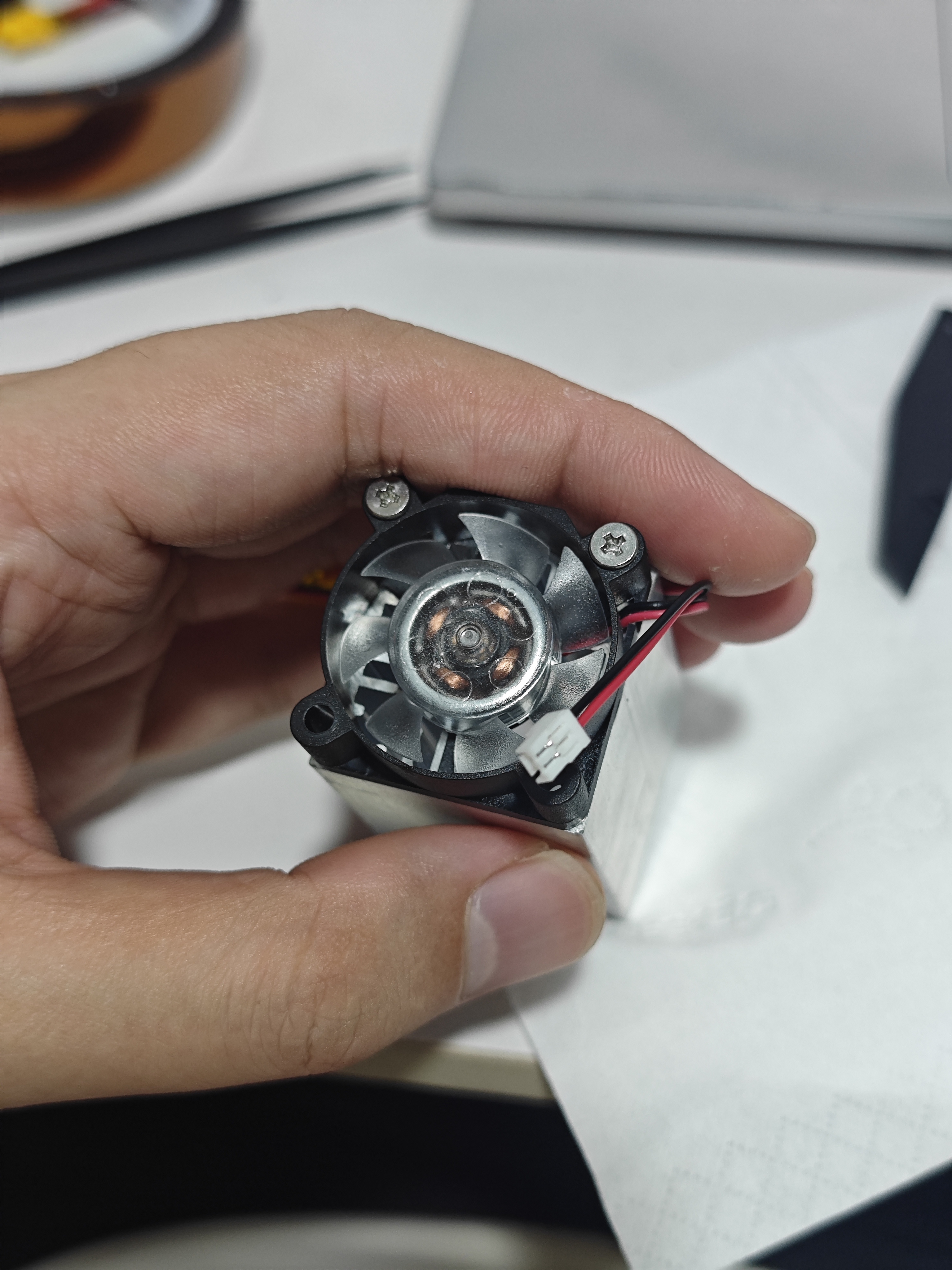

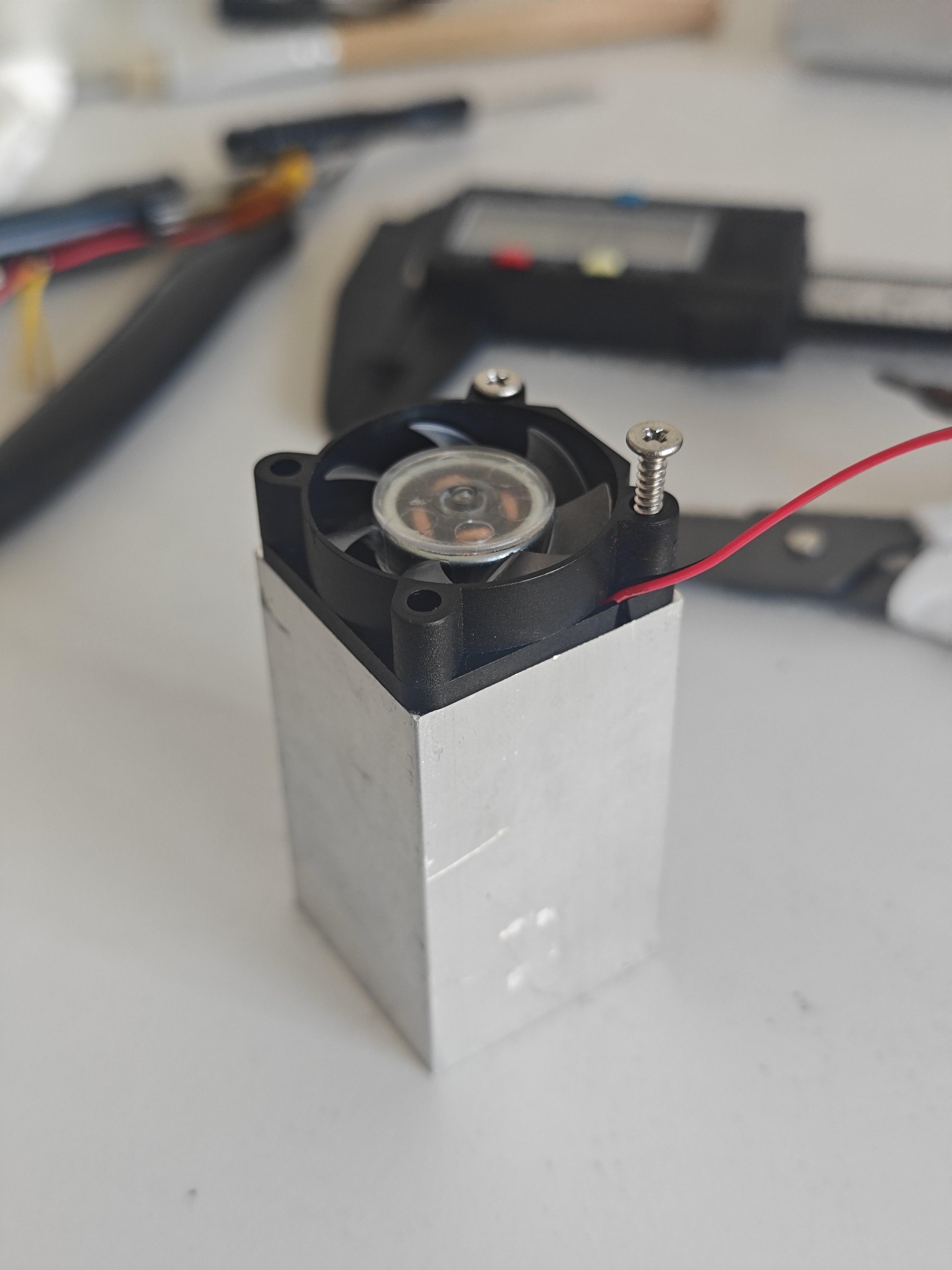

Fan Installation:
Use 4 self-tapping screws (3.13) to install the 3010 cooling fan (3.2) onto the heatsink (3.1).
Fan Modification Interface
: Connect the GH1.25... Solder the 2p wire (3.6) to the original 2 wires of the fan. The 4-wire fan in the video was too expensive at 18 yuan, so it was replaced with a 2-wire fan.

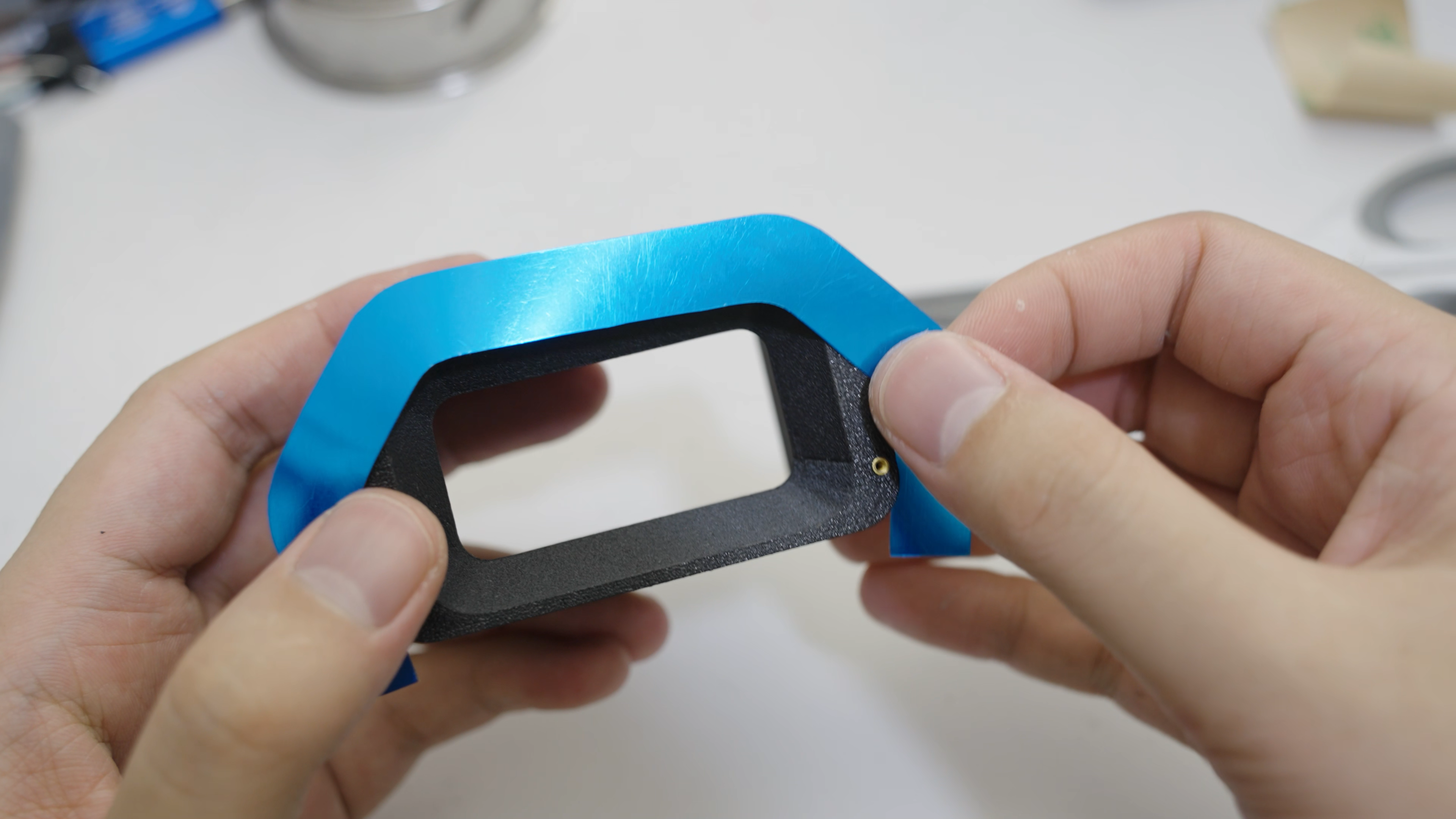

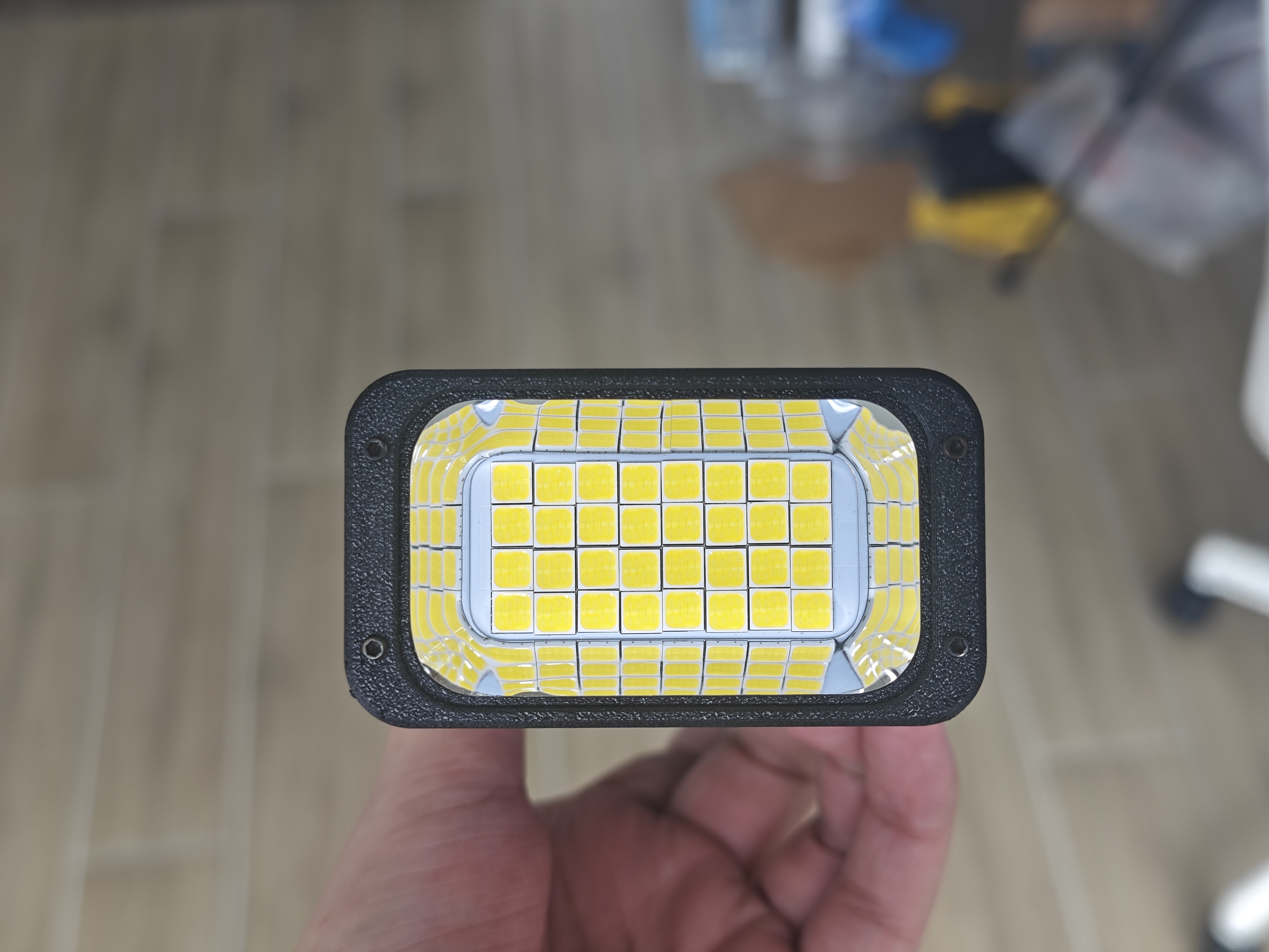

Apply the reflective film
. First, use a polishing stick (4.4) to polish the cup wall, and then use a reflective film mold to cut out the reflective film (3.14). If you don't polish it, it may not stick well.

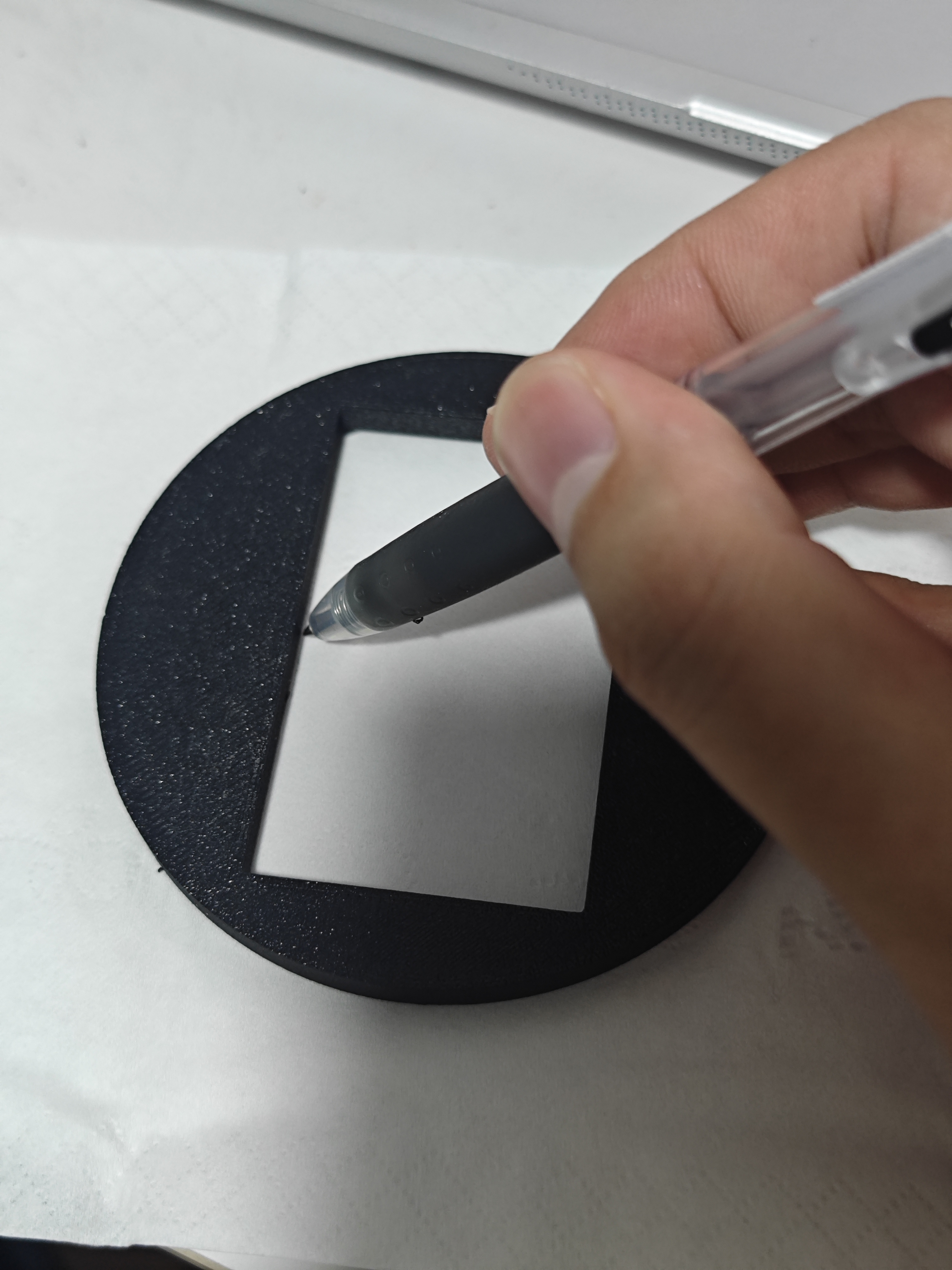

Cut the protective glass.
After fitting the protective glass (3.3) into the cutting mold, draw the marks with a pen. After cutting with a glass cutter, polish the edges with a polishing stick (4.4).
If you don't want to cut the glass, you can buy pre-cut glass from my Taobao store, Guangchui Lighting, for 12 yuan.

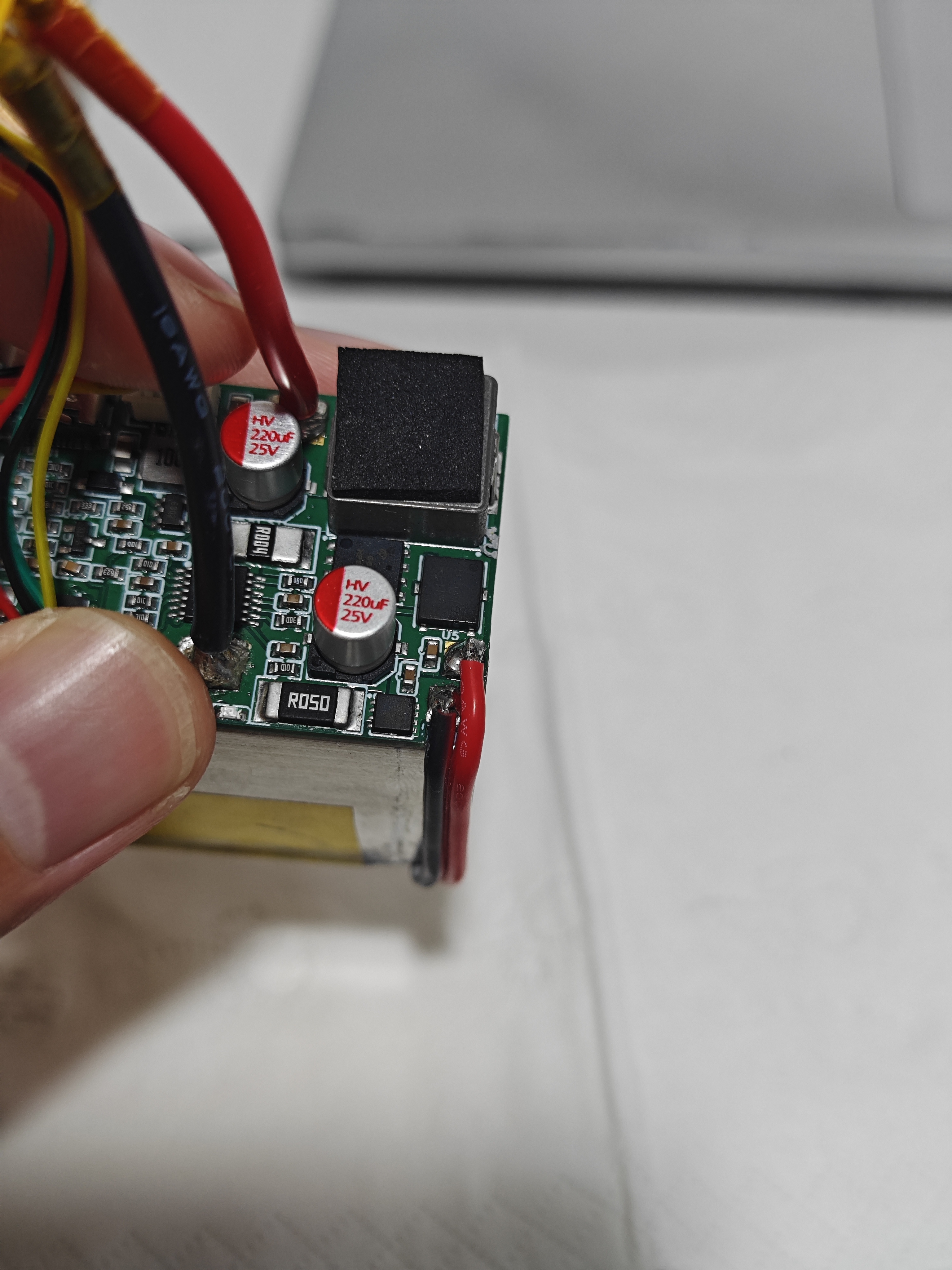

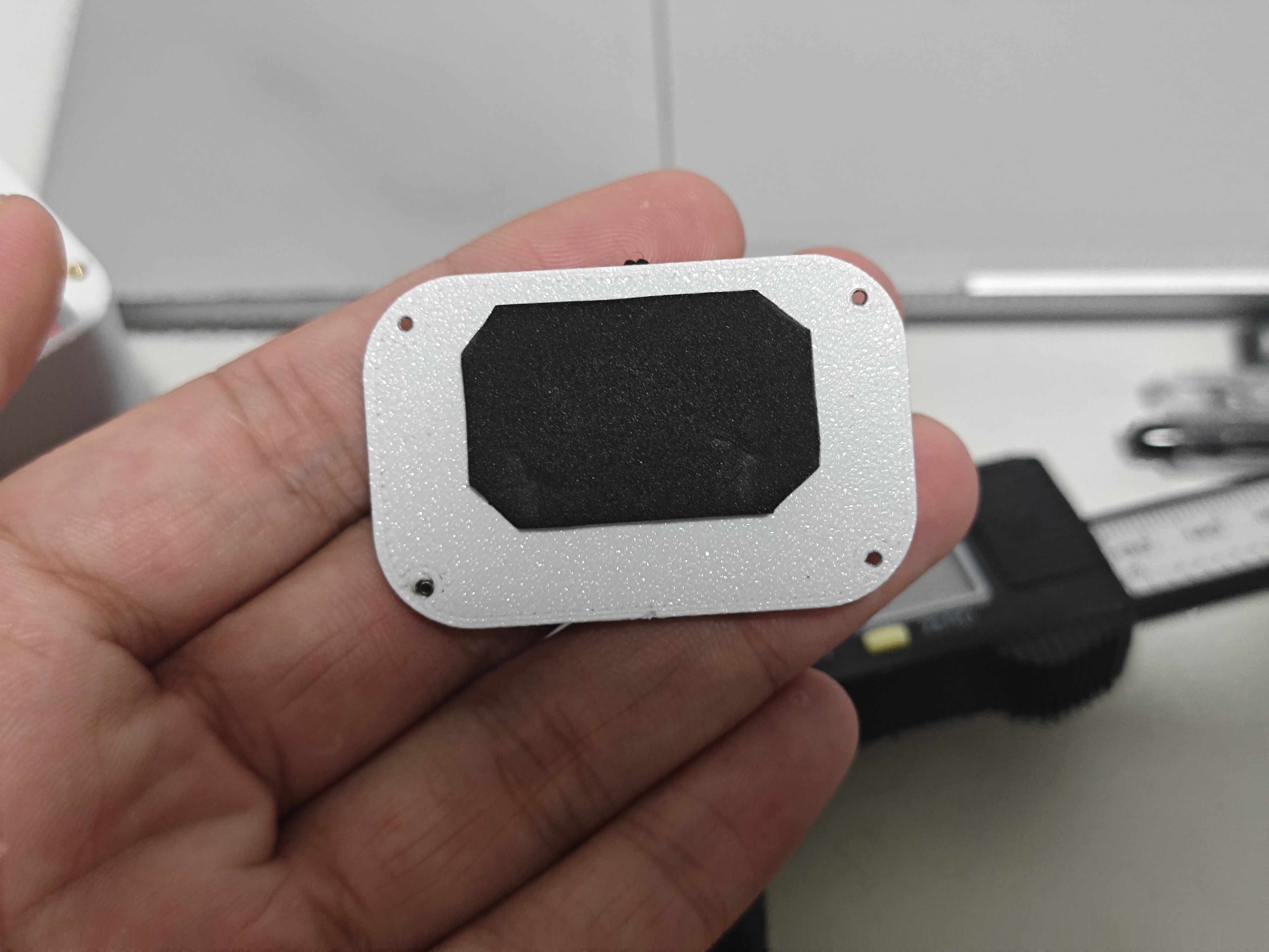

VII. Handle Assembly and
Protection Plate Installation:
Place the protection plate (2.1) in the center and leave an output wire length of 58mm for best results. Use a soft silicone wire (3.8) to connect the output wire to the XT30 female connector (3.5). Attach buffer foam (3.16) to the battery pack output side.
Also attach buffer foam to the tail cap.
