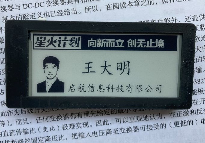

Project Functionality: The name
tag uses an e-ink display, showing the meeting name and personal information on the
front. Each name tag has a button; pressing it displays a QR code, which can be scanned to input relevant information (name, organization, photo, etc.). Releasing the button restores the displayed meeting name tag content .
Staff can pre-enter attendee information, scan the name tag directly, or allow users to enter information themselves.
Due to the uniqueness of the displayed QR code, future development can include functions such as meeting accounting.
The back of the name tag has a magnetic clip for attaching to clothing. Project Attributes:
This is the first public release of this project, and it is my original work. This project has not won any awards in other competitions.

Physical Display
