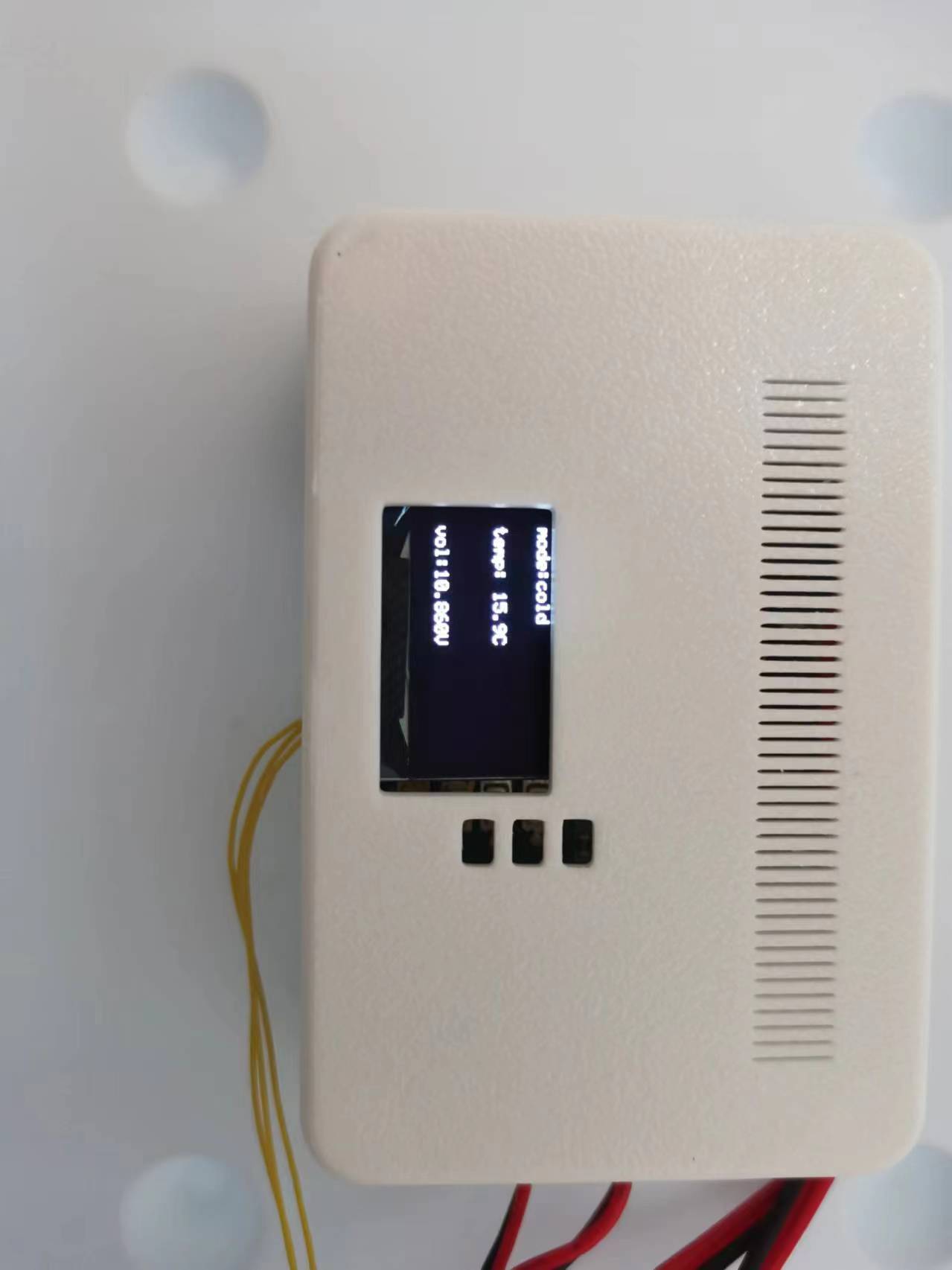

Interactive functions: 1) Implement heating and cooling switching
                  2) Implement constant temperature control

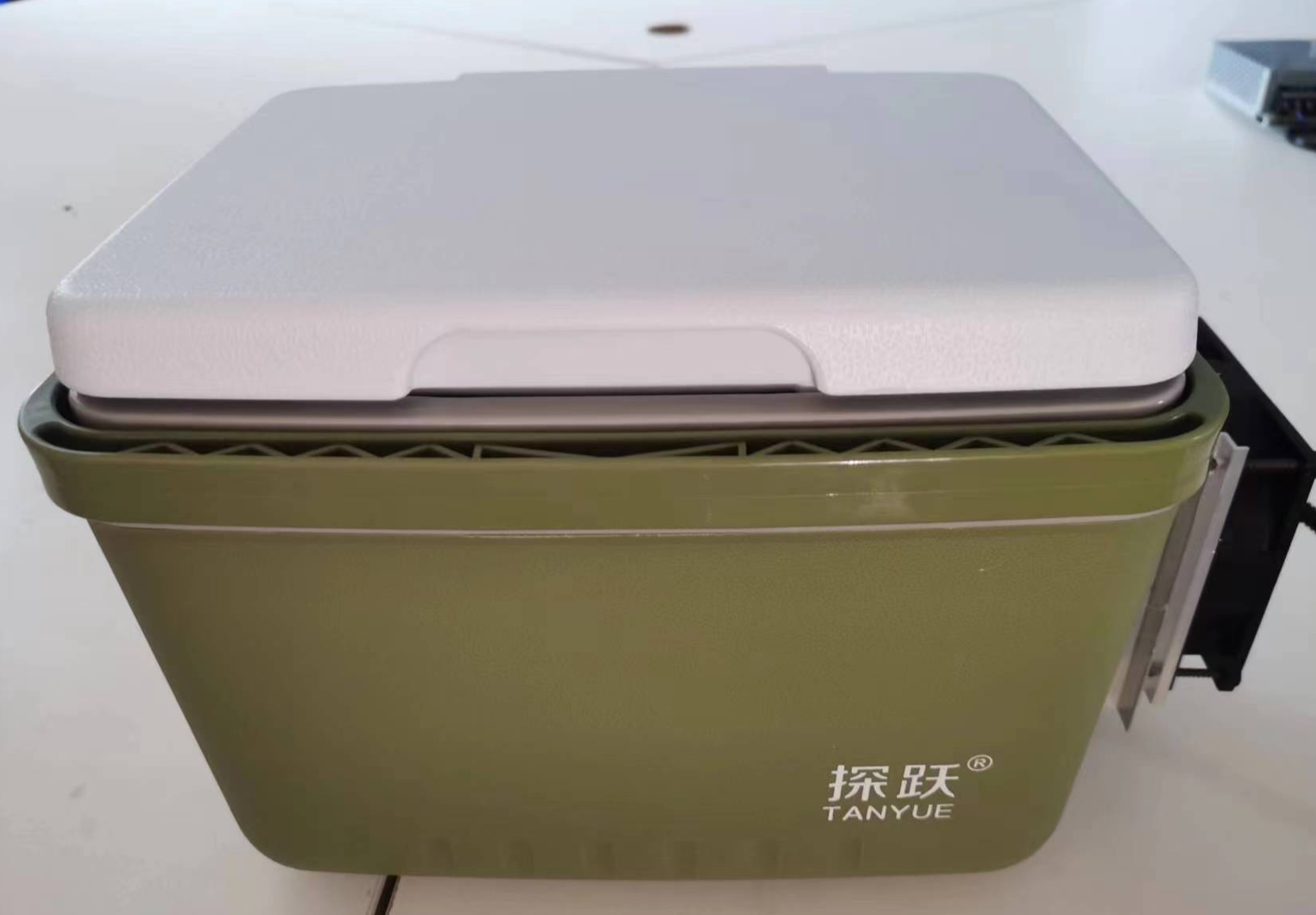

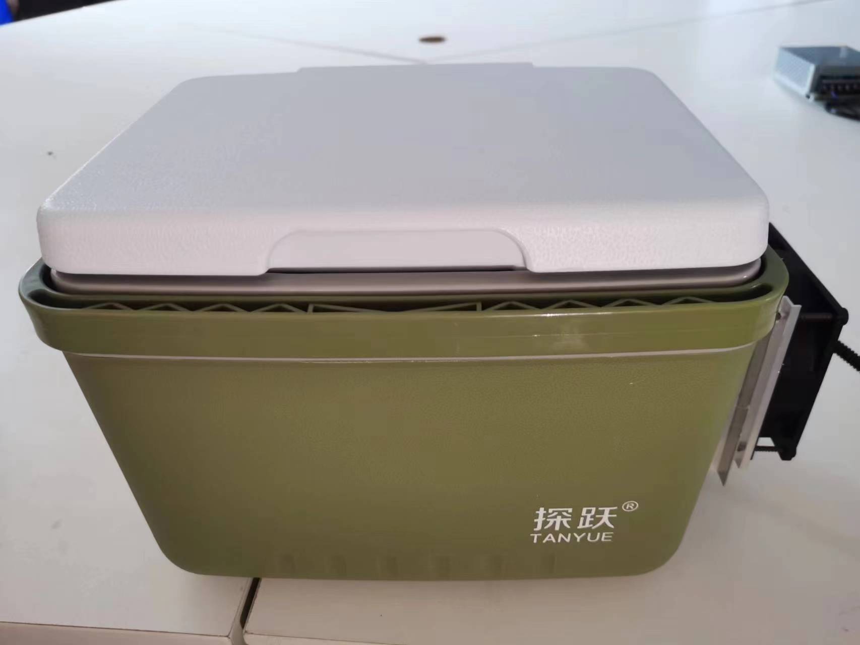

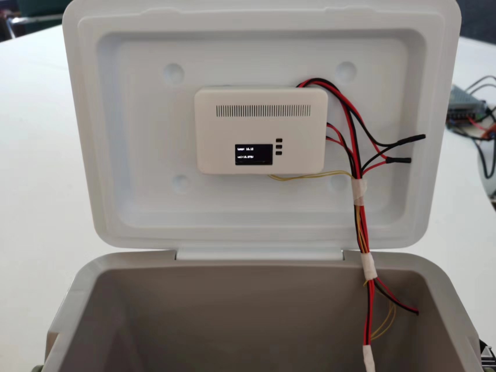

2024.6.28
(1) Test prototype setup completed.
2024.7.10
(1) Finished prototype setup and operation completed, some details to be optimized.
2024.7.12
(1) Complete program uploaded.

The RTT operating system is used to implement thread parallel tasks, and a detailed tutorial will be updated later.
The program has been uploaded!
