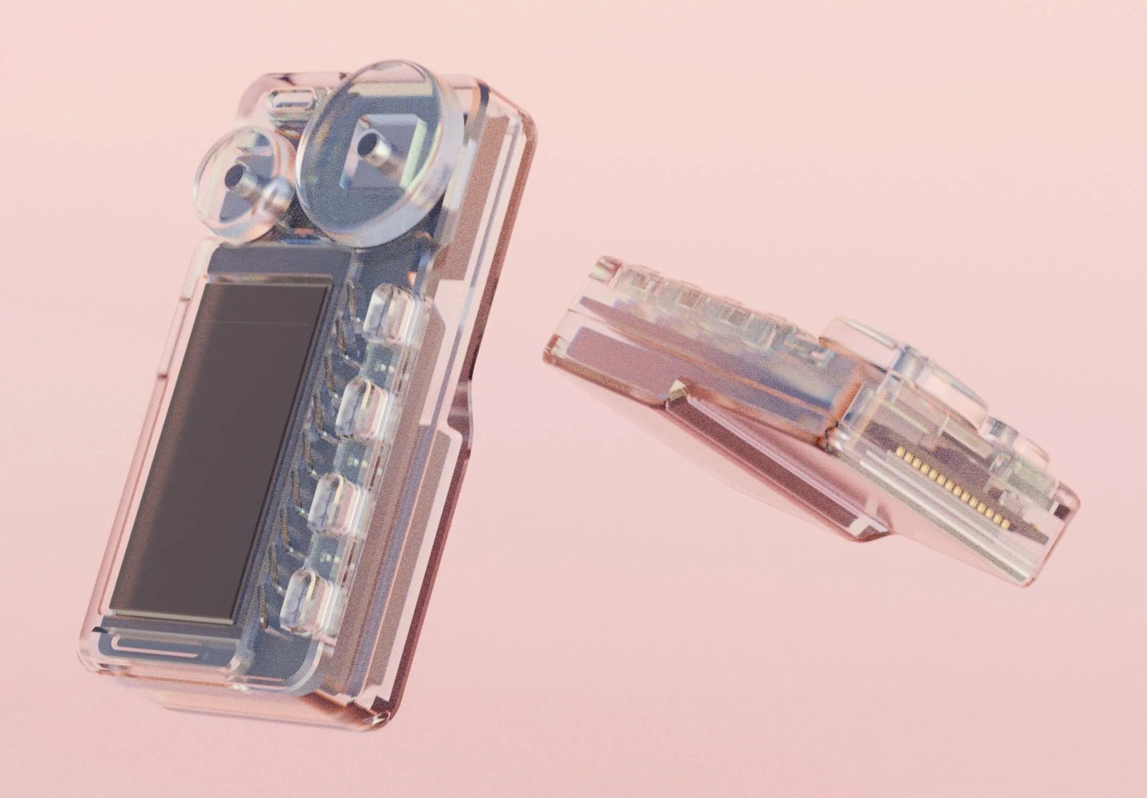

The first pager for young people~
image( ̄へ ̄) This is garbage... Just a quick
video link -> Click me :)

hardware
LCSC link -> Click here :)
1mm board thickness
; Main controller: ESP32C6;
Screen: 1.3-inch OLED from Zhongjingyuan;
Encoder switch: 7.4-inch SMD, with handle, 16 levels;
Battery: 402728 400mAh;
Power management: Mondraker/AXP202 ( sold by a pro)
. It should be relatively easy to solder. If you want to be lazy, you can skip soldering the RTC, IMU, and MIC.
I soldered the screen side incorrectly.
If the encoder switch is soldered in the wrong direction, you can reverse it in the program. Specifically, in the BLE interface system configuration section.
The microphone is an analog microphone; I don't know if I soldered it badly or if the circuit is wrong, but the waveform is unusually flat.
Structure
STL file -> Click here :)
This time there are no screws. The back cover is fixed with a sliding groove and clips.
The gaps are adjusted according to the Tuozhu A1 Mini 0.4 nozzle. It might be a little loose if using resin printing. I haven't tried
assembling it; the sliding groove slightly presses against the PCB, requiring some skill.
