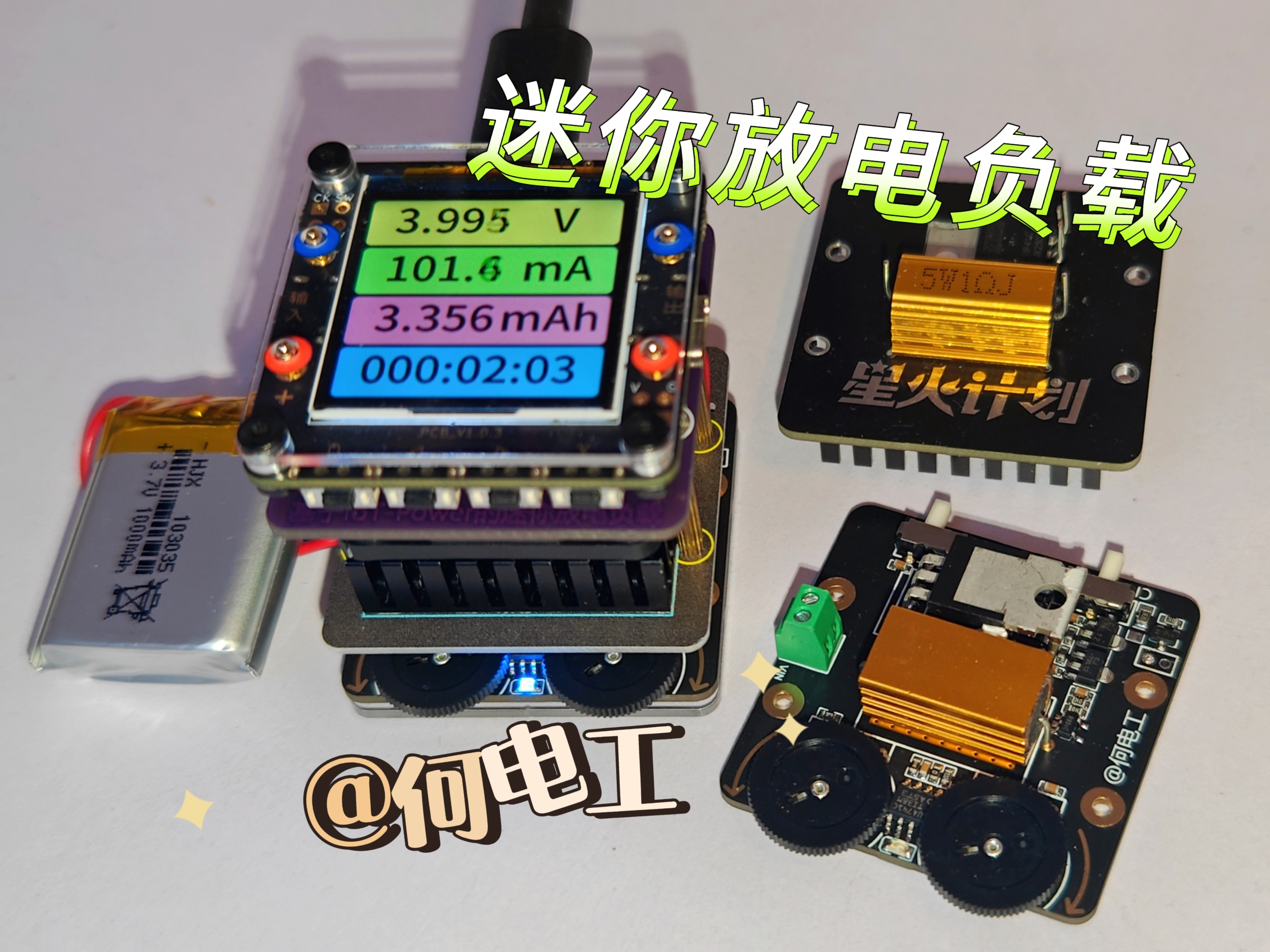

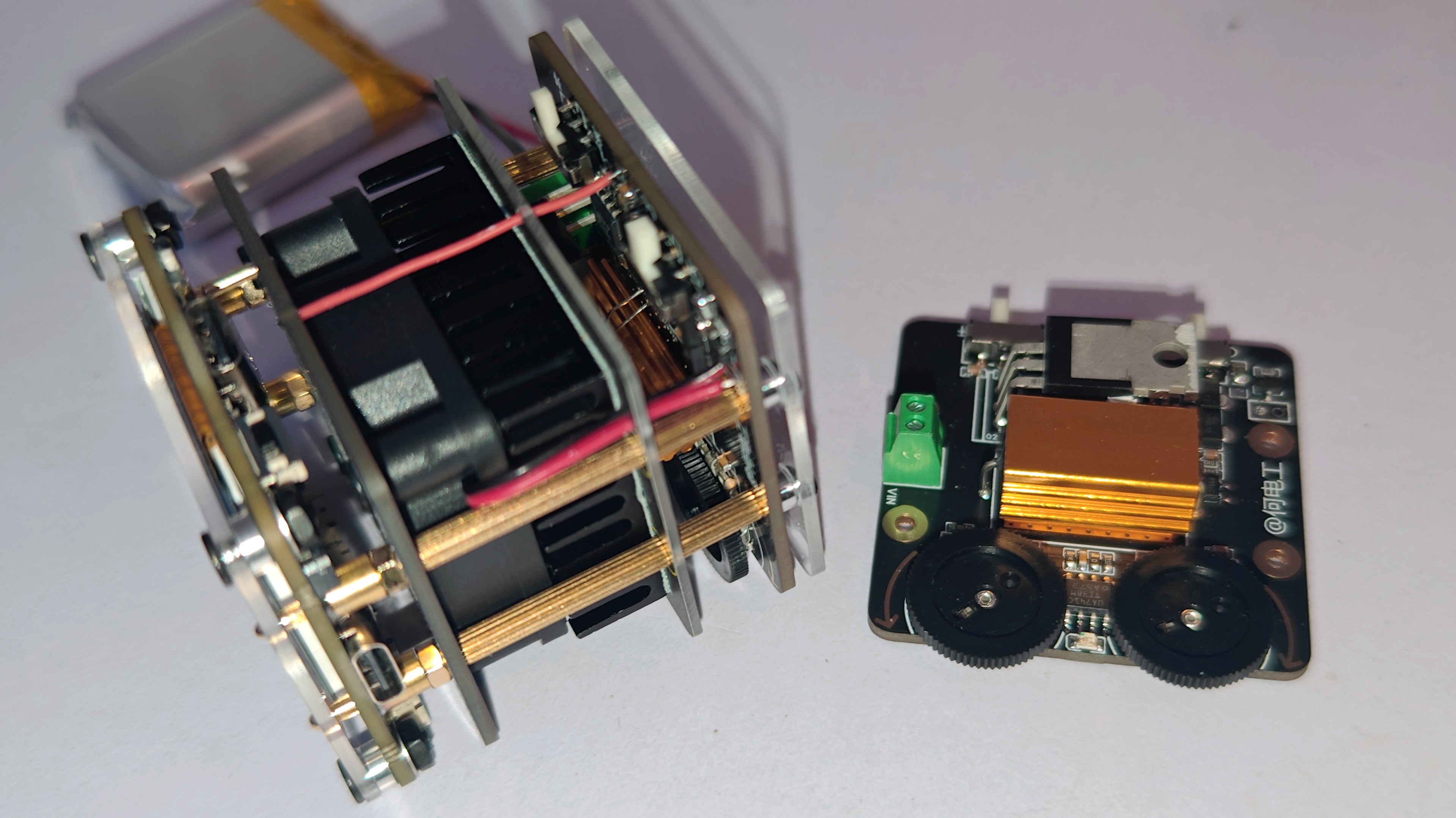

1. This load module has constant current/constant power load modes, which can be switched via a toggle switch;
2. The overall design uses a stacked structure to reduce size, while retaining sufficient area for heat sinks and cooling fans;
3. It connects to the IOTpowerCC meter head using a banana plug and spring pins, allowing the meter head to be removed when not in use.

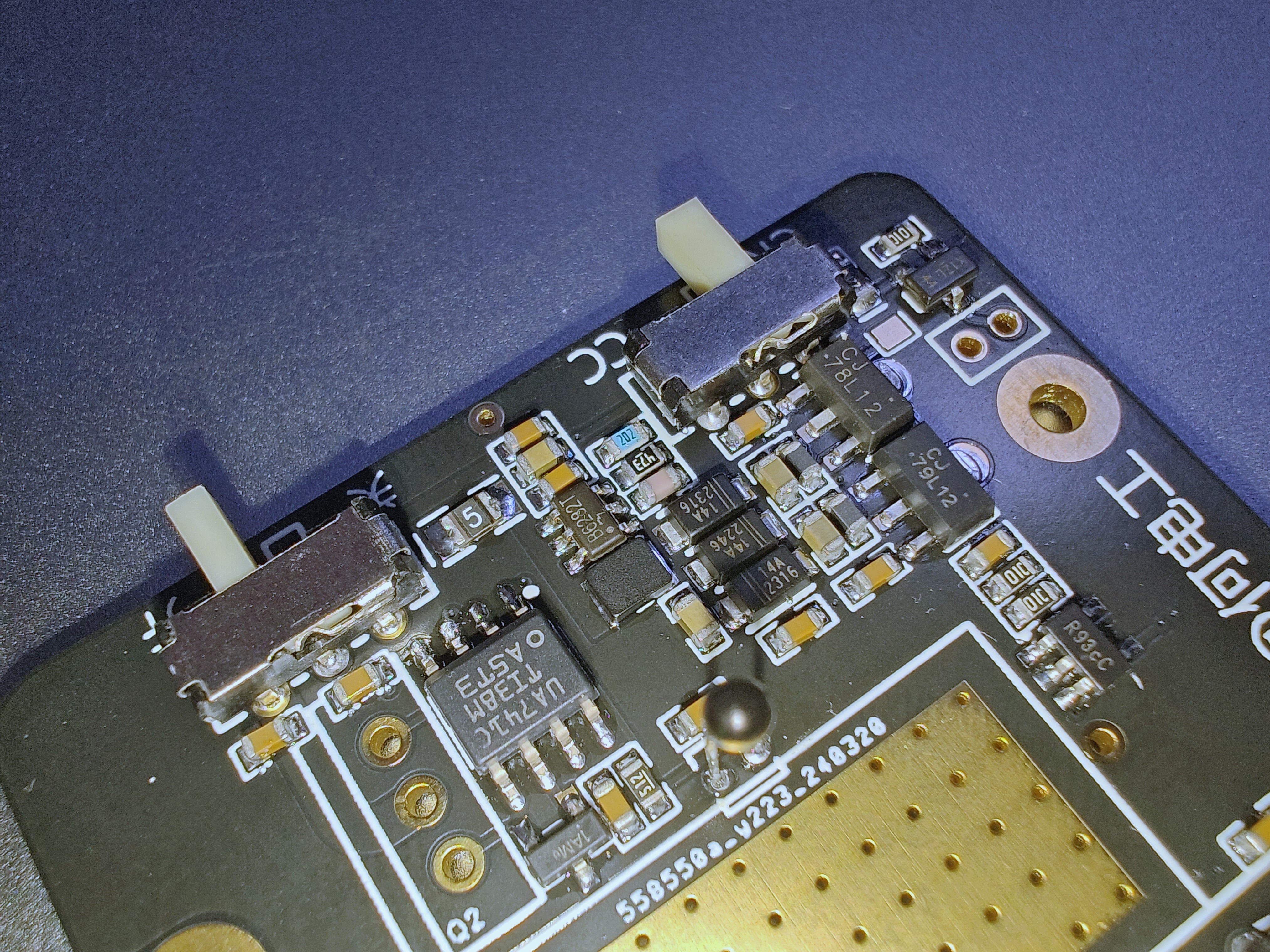

The circuit of this project is mainly on the control board (left in the figure below), and some through-hole components are mounted on the heat sink bracket board (right in the figure below).
The circuit of this project is relatively simple, mainly divided into two parts: the power supply circuit and the load control circuit. The core of controlling the load is the negative feedback of the operational amplifier.

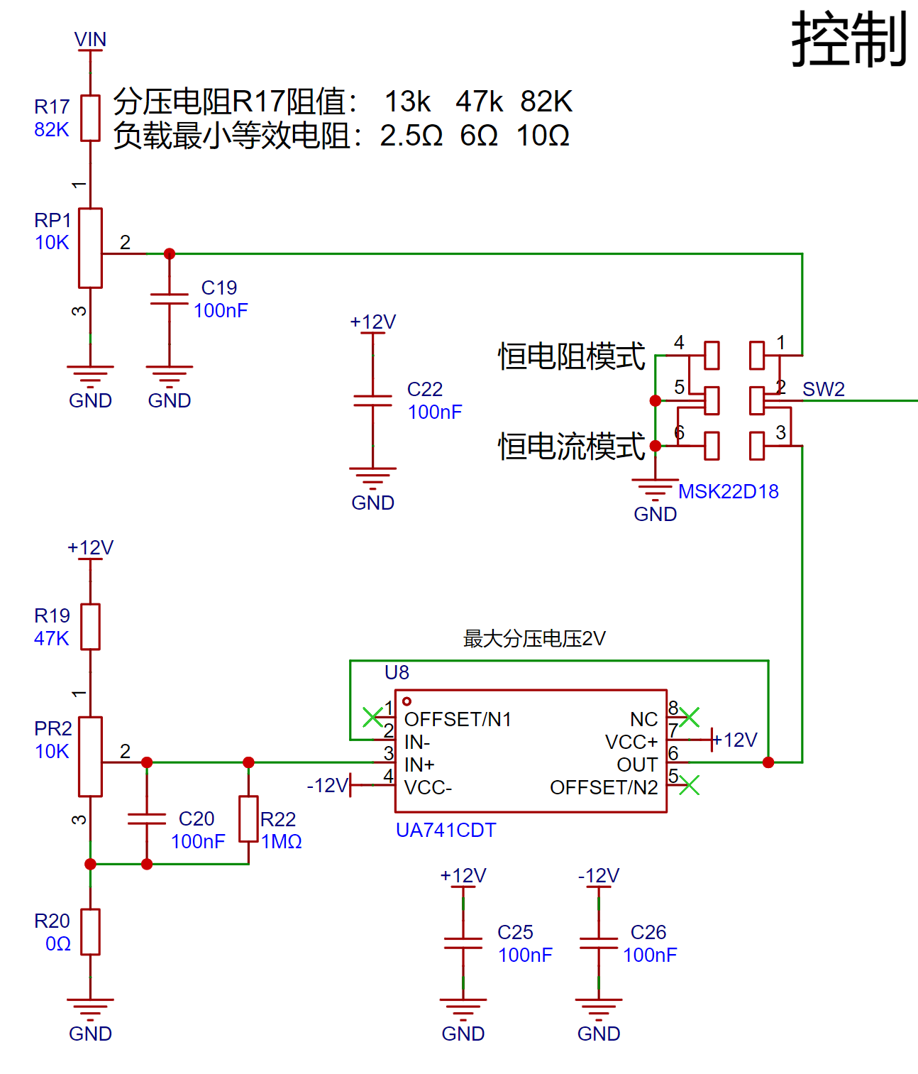

3. Parameter setting circuit:
This module has constant current/constant resistance load modes, which can be switched by a toggle switch, as shown in the figure above. CC and CR are marked on the PCB for easy identification.
In constant resistance mode, RP1 is used for voltage divider output reference value, and R17 above is used to limit the upper limit of the reference voltage. The minimum equivalent resistance of the load corresponding to different resistors is marked in the figure, which is convenient for users to switch according to actual needs. The default is to use an 82k resistor. It is not recommended to use the load with high current for a long time to avoid overheating.
The principle of constant current mode is similar, where R19 is used to limit the minimum current. The main difference between constant
current and constant power modes lies in the feedback source. Since the load itself provides current feedback, a fixed reference voltage is used in constant current mode, while a constant resistance mode is one where the reference voltage changes linearly with the input voltage.
Similarly, a constant power mode can be designed.

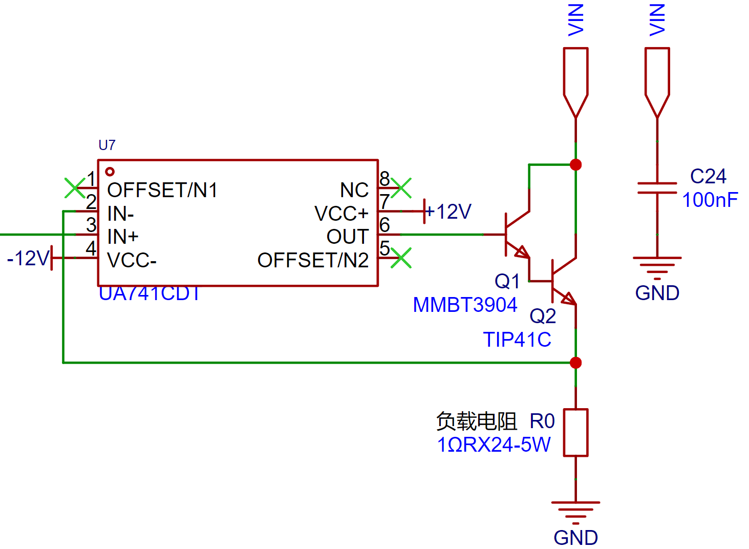

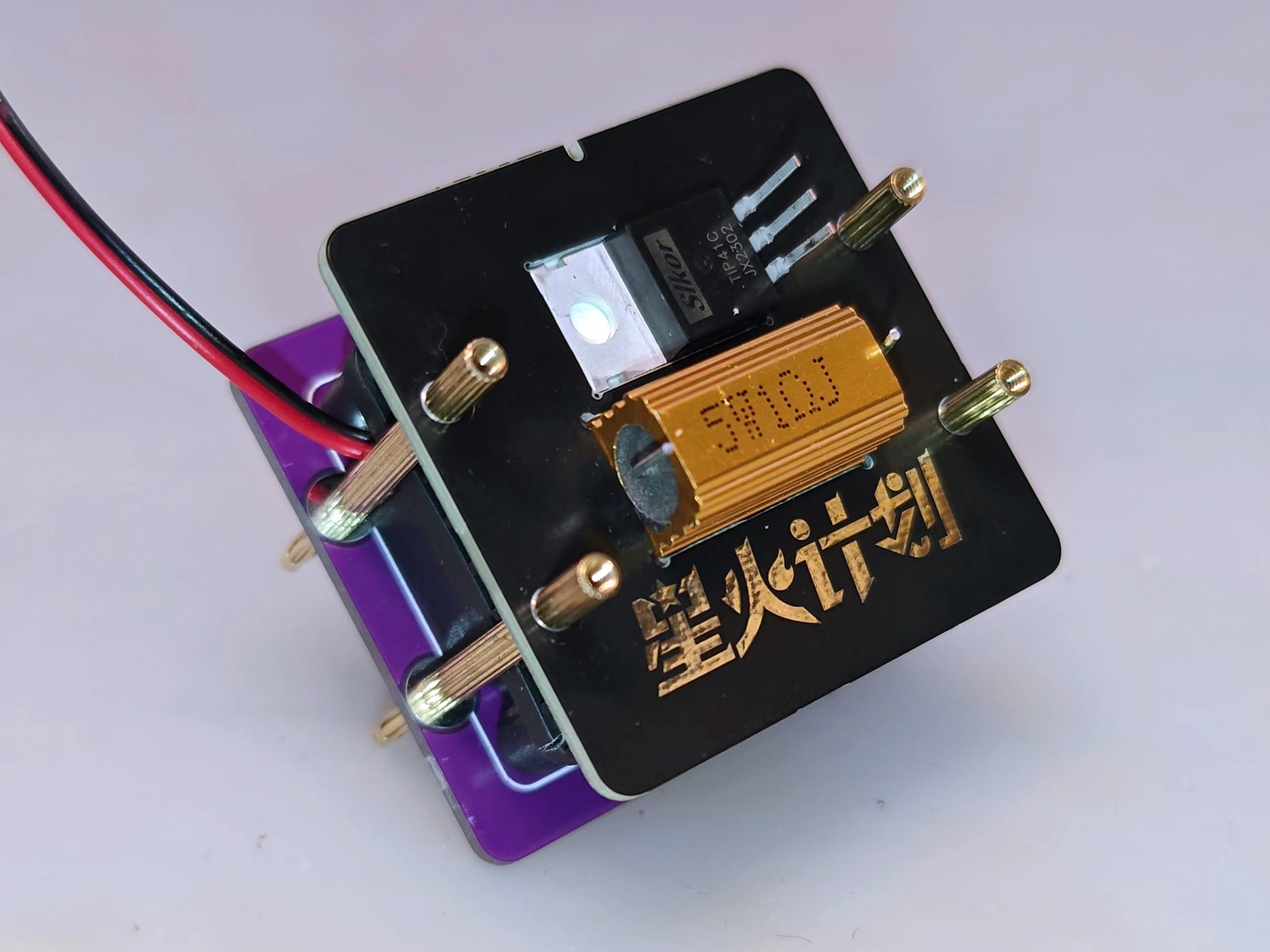

4. Load Circuit:
The load section uses a 741 op-amp to construct negative feedback. Resistor R0 not only serves as the load but also acts as a current sampling resistor for feedback; therefore, a high-power RX24-5W package resistor is used.
TIP41C is a high-power transistor, which is inconvenient to control directly with an op-amp; therefore, a 3904 is used.
During operation of the Darlington circuit under load, both the power resistor and the TIP41C will generate significant heat. Therefore, an active cooling system is required to prevent overheating.
The assembled power and heatsink components are as follows: (The purple component at the top is the fan bracket).
The power resistor and power transistor are mounted in reverse on the back of the heatsink, as shown in the diagram below.
During installation, first attach the heatsink to the heatsink bracket (PCB or acrylic), bend the component leads as shown in the diagram, and then attach the components to the corresponding openings in the heatsink bracket.
After completing the above assembly, soldering, and testing of the control board, the power and heatsink components can be inserted into the control board (note that soldering should not be done at this stage).
The stack-up of this project is relatively complex. The stack-up structure during assembly is as follows:
1. Top panel;
2. 2mm thick gasket (M2.5)
; 3. IOTpowerCC meter head
    ; 3.1. Copper post for meter head connection;     4.
Gasket, nut; 5. Banana plug (M2 thread)     ; 6.1. M2 screw; 6. Fan bracket plate;     6.2. M2*7 stud;     6.3. 3510 fan.
    6.4. M2 countersunk screws,
    above 6.1-6.4, are fixed to the fan bracket plate.
7. M2*2 1+3 ​​studs.
8. Heatsink bracket.
9. M2*9 double through studs
. 10. Load control board. 11.
2mm thick washers (M2)
. 12. Acrylic base plate
. 13. M2*8 screws.
For detailed assembly instructions, please refer to the article: Low-Cost Mini Discharge Load Assembly Instructions - JLCPCB EDA Open Source Hardware Platform (oshwhub.com).

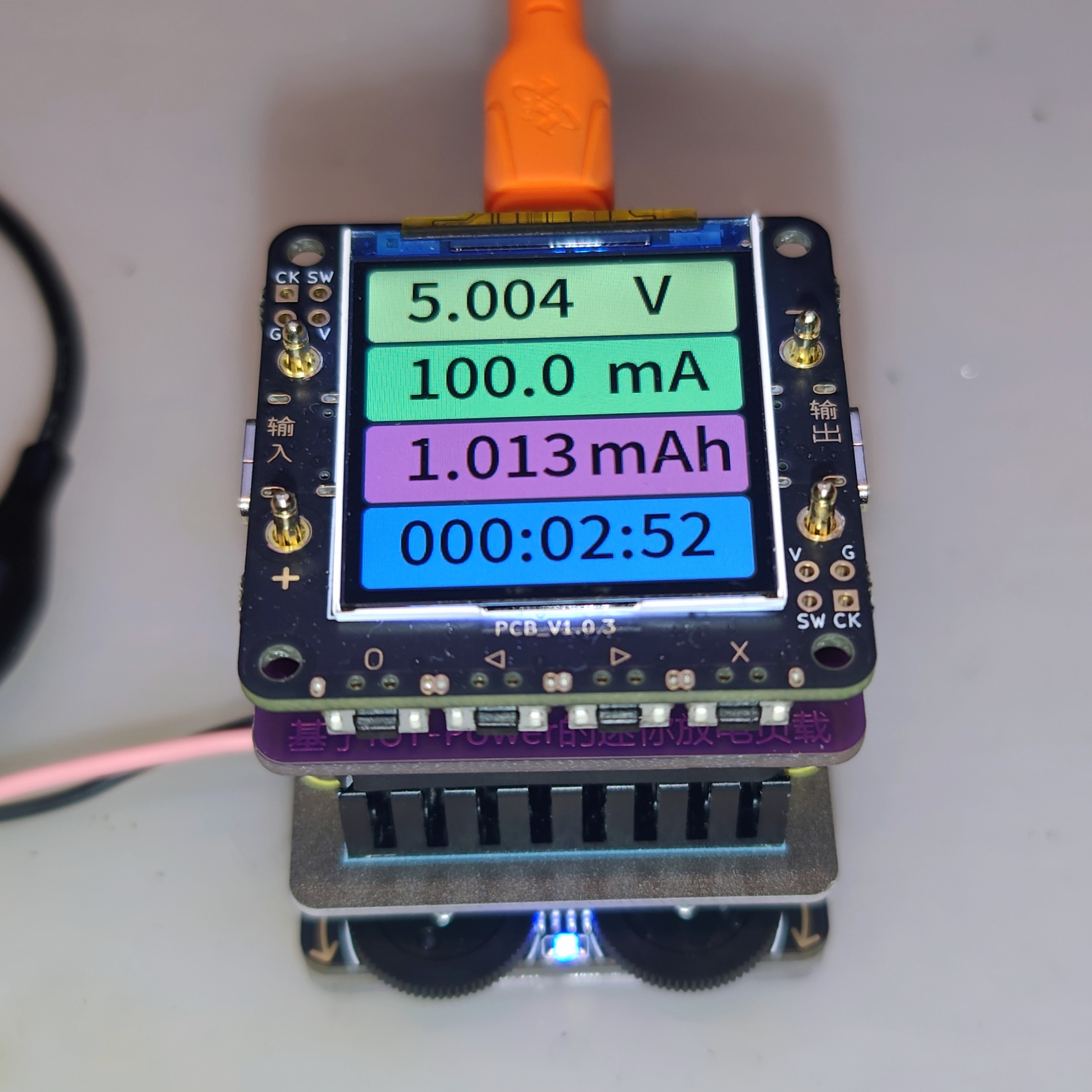

Circuit Function Test:

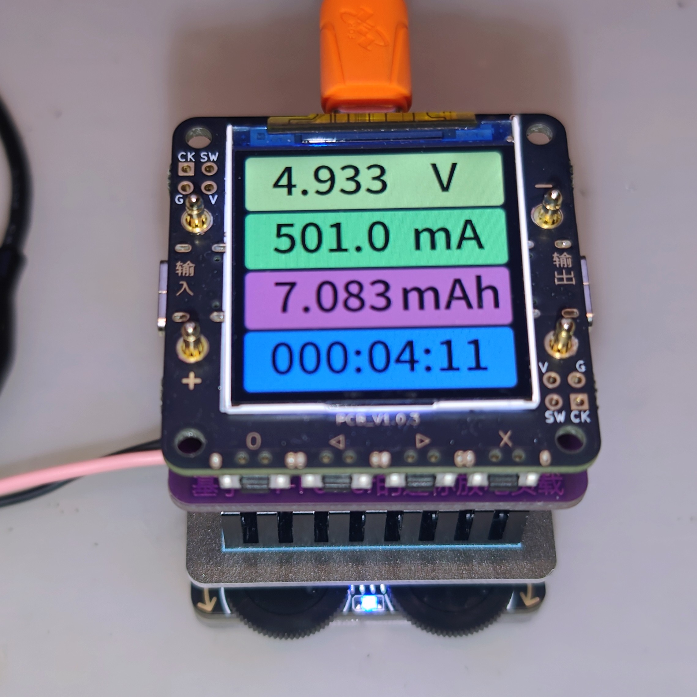

The following are actual test photos. To facilitate testing under different voltage conditions, a digitally controlled power supply is used instead of a battery input load.
1. Constant resistance mode:
Change the input voltage, keeping the load resistance constant.
2. Constant current mode:
Change the input voltage, keeping the load current constant

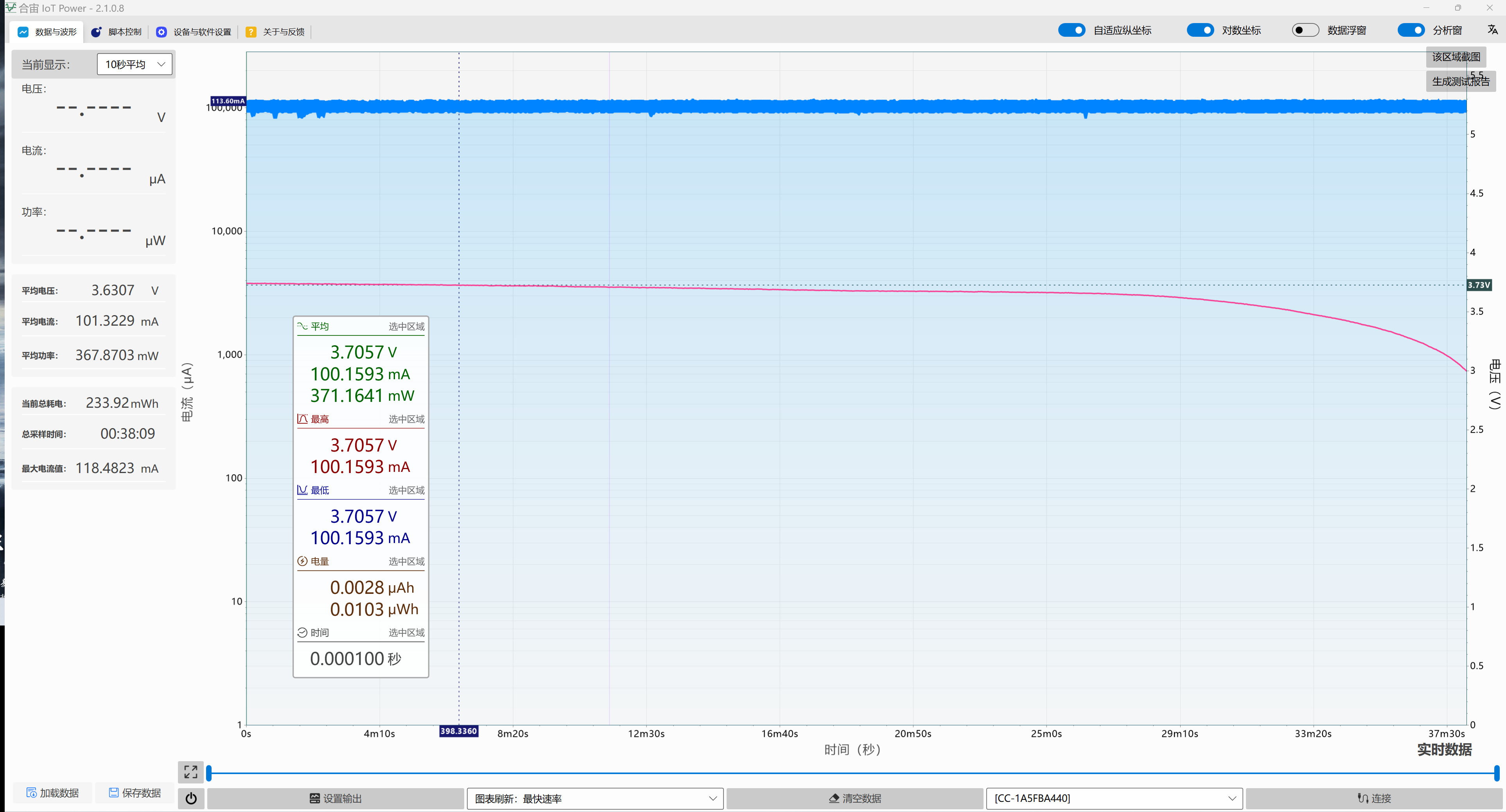

. 3. Battery discharge curve test:
Use an IOTpowerCC meter in conjunction with a host computer to record the battery discharge curve. This is the main function of this module, achieving precise low-current discharge to obtain the accurate discharge curve of a small soft-pack lithium battery. This allows for more accurate deduction of the battery
capacity from the voltage during product manufacturing. The sample battery discharge curve is shown in the figure (discharge current set to 100mA).
