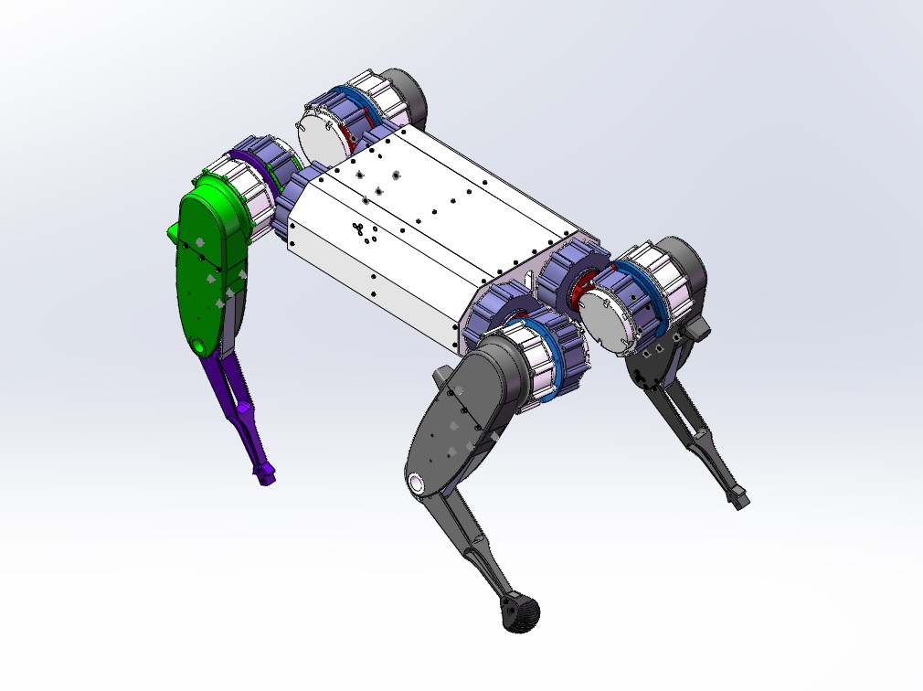

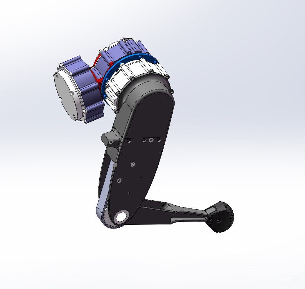

Mechanical Structure:
The mechanical structure consists of four mechanical legs, the robot body, and internal and external equipment mounting frames.

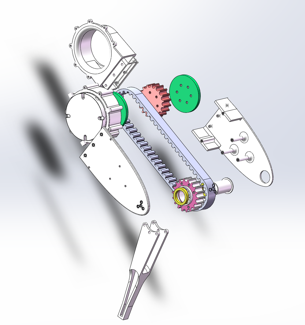

The design of the mechanical legs will be explained in detail below:
The mechanical legs consist of three joint motors and a transmission structure. The three joint motors are integrated at the hip joint through the transmission structure to reduce motion inertia.
The overall structure is shown in the following diagram:
Detailed structural BOOM diagram (this diagram is from the initial structure, but only some dimensions were modified later; the overall structure remains unchanged):
Overall structure diagram of the robot dog:

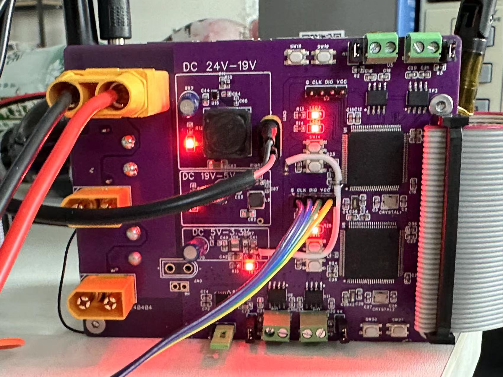

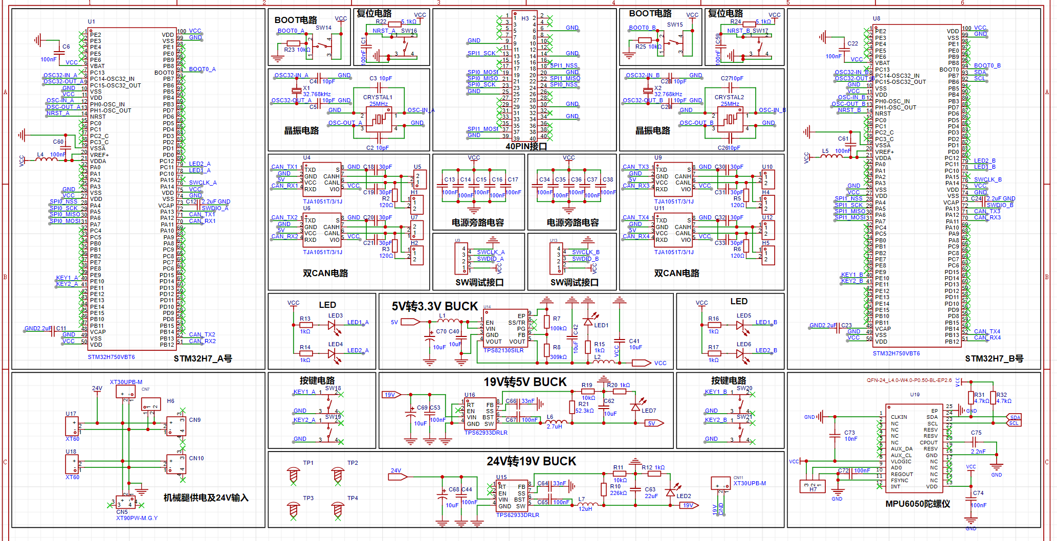

The lower-level system
connects to the upper-level system via a 40-pin ribbon cable and can be fixed to the upper-level system via M3 copper pillars . The main
controller consists of two STM32H750RCT6
microcontrollers with four CAN bus channels, each channel connecting three servo joint motors, for a total of 12 motors, with a maximum baud rate of 1MHz.
Two SPI channels are used for communication between each microcontroller and the upper-level system, with a maximum baud rate of 15MHz. An
onboard MPU6050 gyroscope and
three DC-DC synchronous step-down converters are provided: 24V-19V, 19V-5V, and 5V-3.3V. 19V powers the robot dog's upper-level ORIN NX (XT30), while 5V and 3.3V power the microcontroller system.
It also integrates a power distribution board, providing four 24V XT60 interfaces and one 24V XT30 interface. The
main components are shown in the figure.

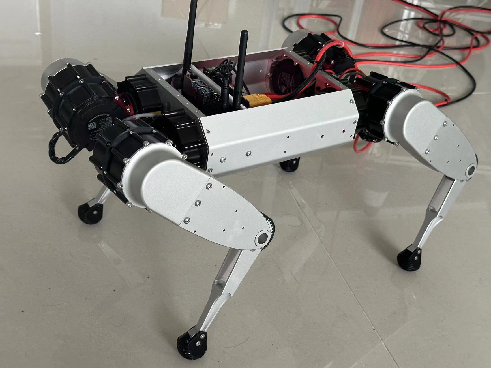

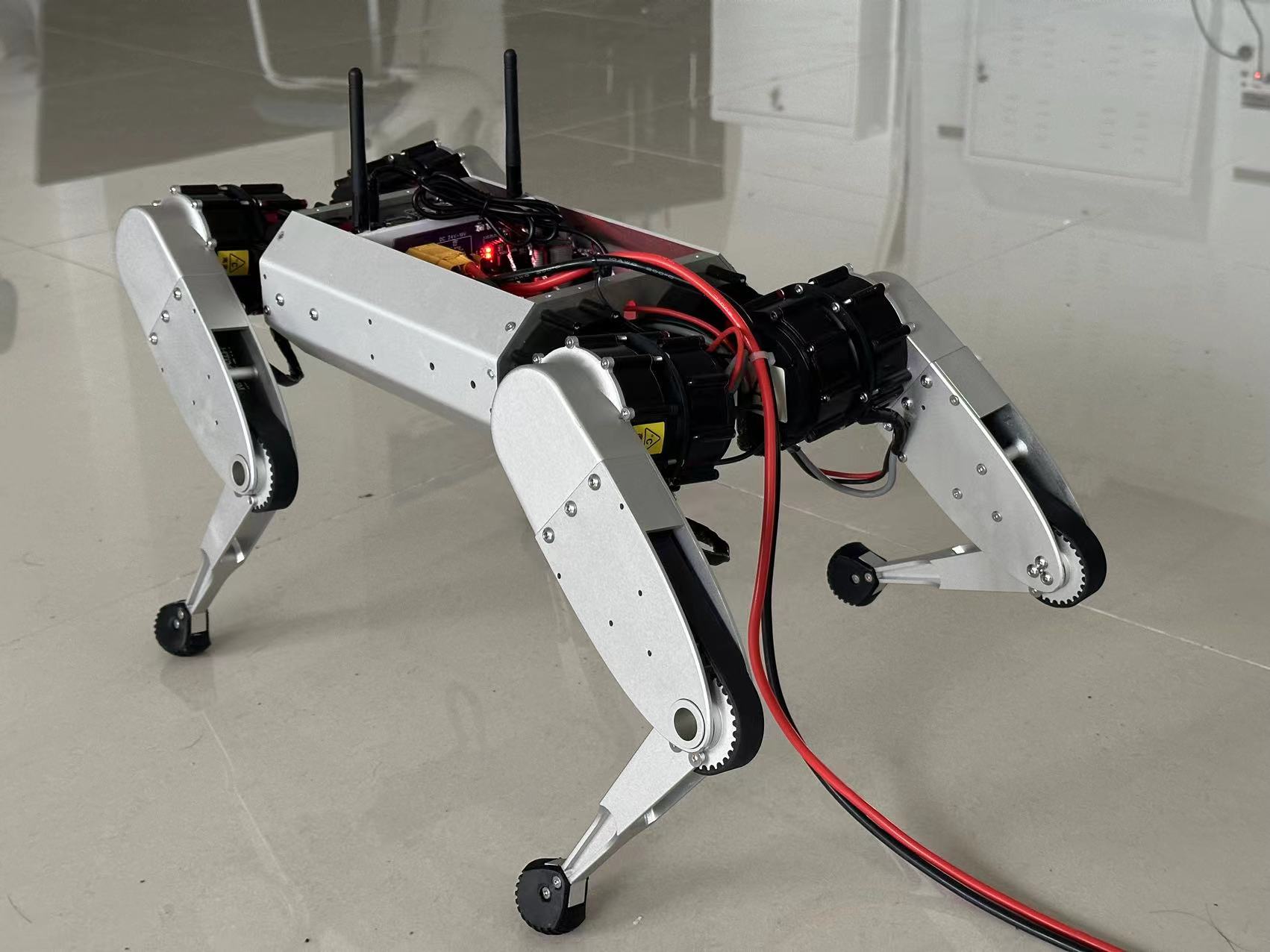

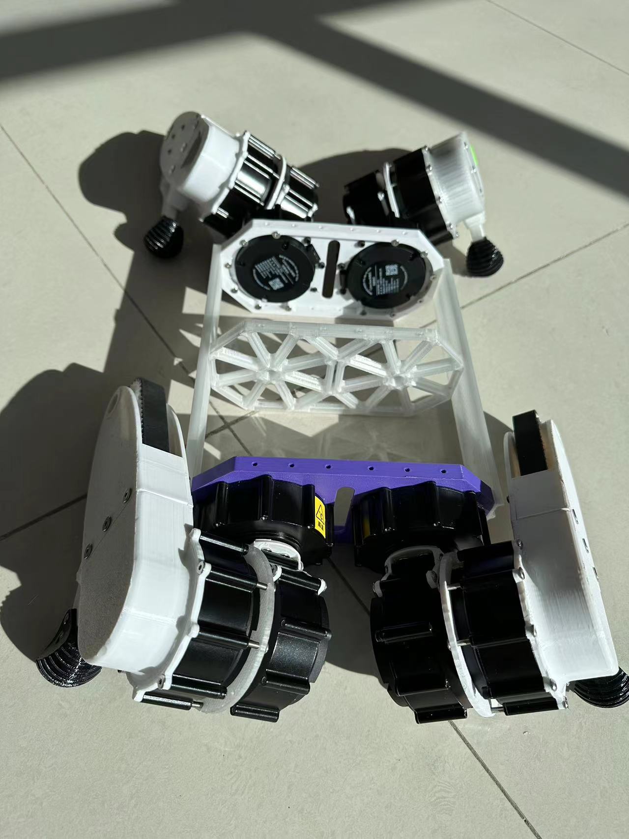

Physical demonstration :

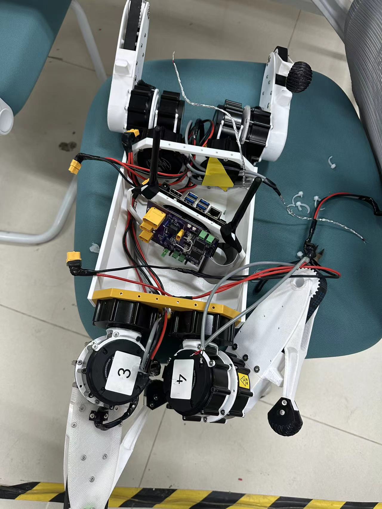

Combined upper and lower computer diagram
, running and debugging diagram,
mechanical assembly diagram

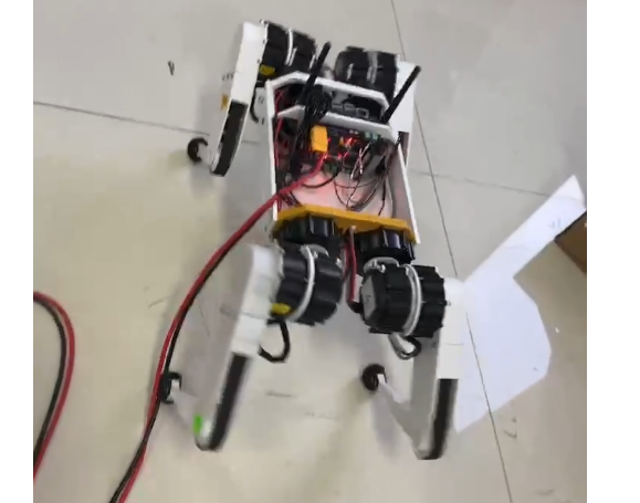

. Dark crawling & tidy workbench:
Small steps, finally able to walk!!!
Plastic to iron, glue to welding, the complete form is here
! There are also unique marking postures!!!
