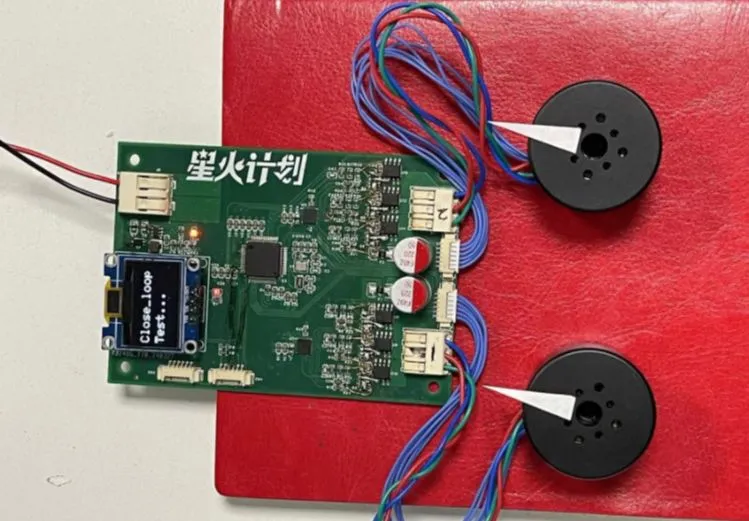

This project
utilizes the STM32F722RET6 main chip to implement a high-performance, low-cost FOC dual-motor control system.
Through torque feedback between the two motors, a non-direct contact, real-time force feedback system is achieved, with one motor acting as the handheld end and the other as the actuator.

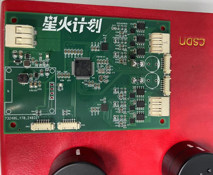

The main chip uses STM32F722 to drive two brushless motors using control algorithms.
The hardware driver uses a high-side driver chip DRV8300DR + 6NMOS, and current sampling uses a CC6903SO Hall current sensor for inline current sampling on the high side. The most important thing to pay attention

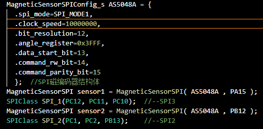

to in the software
is the SPI clock frequency of the magnetic encoder. It's best to use a frequency of 10Mbps or higher.

3. Magnetic encoder chip driver: confirming the AS5048A magnetic encoder's SPI data output is normal.

Physical demonstration
sample board processing: Because LCSC required ordering MOSFETs and couldn't use surface mount technology, I bought them myself. I used a hot air gun for a long time and it looked like it was soldered, but measurements showed the MOSFET was faulty. After several days of back and forth, I still couldn't get it working. After
exhausting my 15 MOSFETs, I ended up buying 20 more. This time I learned my lesson and manually soldered the MOSFETs face down, and it worked perfectly on the first try! Haha!

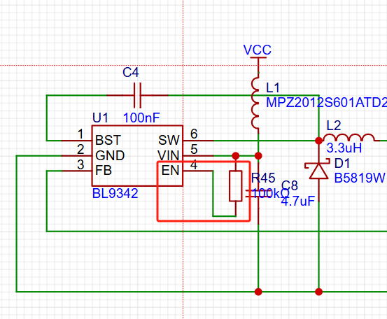

1: During hardware debugging after the PCB was installed, I discovered the power chip's enable pin was floating, resulting in no power. Project information updated.
2: The AS5048A magnetic encoder's SPI clock speed should ideally be above 10Mbps. Using 1M or 2M will cause jitter in a single motor .
