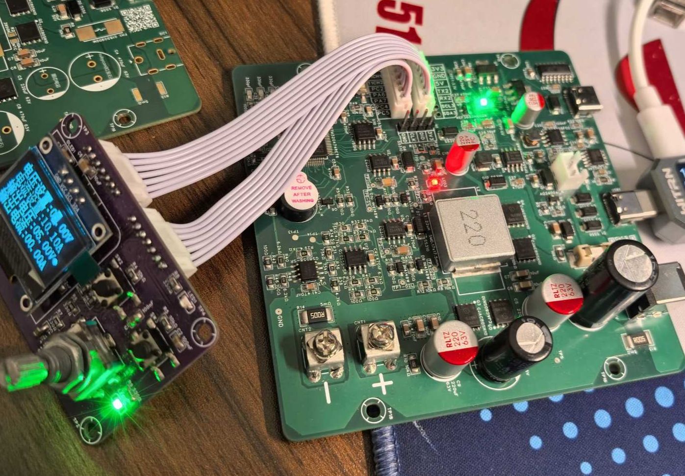

This paper designs a synchronous rectified Buck-Boost digital power supply based on STM32. The power supply circuit consists of a MOSFET driver circuit, a 4-switch Buck-Boost circuit, a signal conditioning circuit, a PD fast charging protocol circuit, an auxiliary power supply circuit, and a microcontroller control circuit.
The power supply can be powered via a DC interface or a Type-C interface. The Type-C interface supports communication with the charger via the PD fast charging protocol, automatically requesting and obtaining a maximum operating voltage of 20V. The power supply uses an STM32G474 microcontroller to monitor the input and output voltage and current in real time, and uses a PID control algorithm to adjust the output PWM duty cycle, implement overvoltage and overcurrent protection, and sample the motherboard temperature for overtemperature protection. Furthermore, the power supply parameters can be viewed in real time on an OLED screen, and the output voltage and current can be set via a rotary encoder and buttons. It can also communicate with a host computer via another Type-C interface, allowing real-time viewing of various power supply parameters and waveforms through the host computer software.

This digital power supply design uses the STM32G474RET6 chip as the controller. This controller has significant advantages such as simple peripheral circuits, diverse control methods, and excellent expandability. To achieve a precise clock signal, the controller uses an external crystal oscillator X1, a 25 MHz quartz crystal oscillator. In addition, the circuit includes multiple filter capacitors, including C45, C51, C56, C46, ​​and C52, which are used on different digital power pins of the microcontroller (MCU) to ensure power stability and reduce noise interference. Resistor R49 and capacitor C49 constitute the power-on reset circuit, and SW1 is the MCU reset button. U11 is a USB-to-serial chip, model CH340C, connected to the second Type-C interface, and the serial port connects to the MCU's USART1 interface. U10 is a Flash memory chip, model W25Q64, used to store parameter settings and other information, and connects to the MCU's SPI3 interface. Q6 is the buzzer driver MOSFET, used to control the buzzer; the MOSFET gate is connected to the MCU's PB5 port. Terminal H1 is the SWD programming port. H2 and H4 are PH2.0 connectors for connecting to the control panel. The connectors have a reserved USART2 interface, allowing for easy replacement of the control panel with a serial port screen. An ESP32 can also be added to enhance networking and wireless control capabilities. D13 is a 5V reverse polarity protection diode. The schematic diagrams
of the cooling fan driver and motherboard temperature sampling
circuits are shown below. The power supply motherboard temperature sampling works by using an NTC thermistor R2 and a pull-down resistor R4 in series to divide the voltage and output it to the MCU's ADC port for sampling. The NTC thermistor used has a resistance of 10kΩ and a B value of 3950K.
The cooling fan is driven by an N-MOS transistor, model AO3400. A diode D2 is connected in reverse parallel to the cooling fan interface to prevent damage caused by the back electromotive force (back EMF) generated by the motor. When the motor is powered off, due to rotational inertia, the rotor will not immediately stop rotating but will continue to rotate and generate an electromotive force. This electromotive force can damage transistors or integrated circuits in a circuit, especially when the motor is connected to these components via semiconductor switches such as MOSFETs.
Control Panel Circuit Design
The circuit diagram of the control panel is shown below. SW1 is a rotary encoder used for setting parameters, etc. SW2 and SW3 are buttons; SW2 is used to switch settings, and SW3 is used to control the power output on and off. LED1 is the system running status indicator, flashing at 500ms intervals during normal operation. LED2 is the output status indicator, lit when the output is on and off when the output is off. OLED1 is an OLED screen used to display power parameters and status information.

Instructions for Use
The output voltage and current values ​​can be set using the buttons and rotary encoder. As shown in the diagram below, the inverted color display indicates the current setting position. The rotary encoder can be used to increase or decrease the value, and pressing the encoder switches to the next setting position. The SW2 button switches the setting item. The set data is automatically saved to the Flash memory chip, and the data is read from the memory chip the next time the system boots up.
SW3 button turns the power output on/off.
You can switch to the data display page to view the current input and output voltages and currents of the power supply, as well as information such as the motherboard temperature and MCU temperature, as shown in the figure below.
You can switch to the settings page to set the thresholds for over-temperature/over-current/over-voltage protection, as shown in the figure below. The set data is automatically saved to the Flash memory chip and will be read from the memory chip upon the next power-on.
