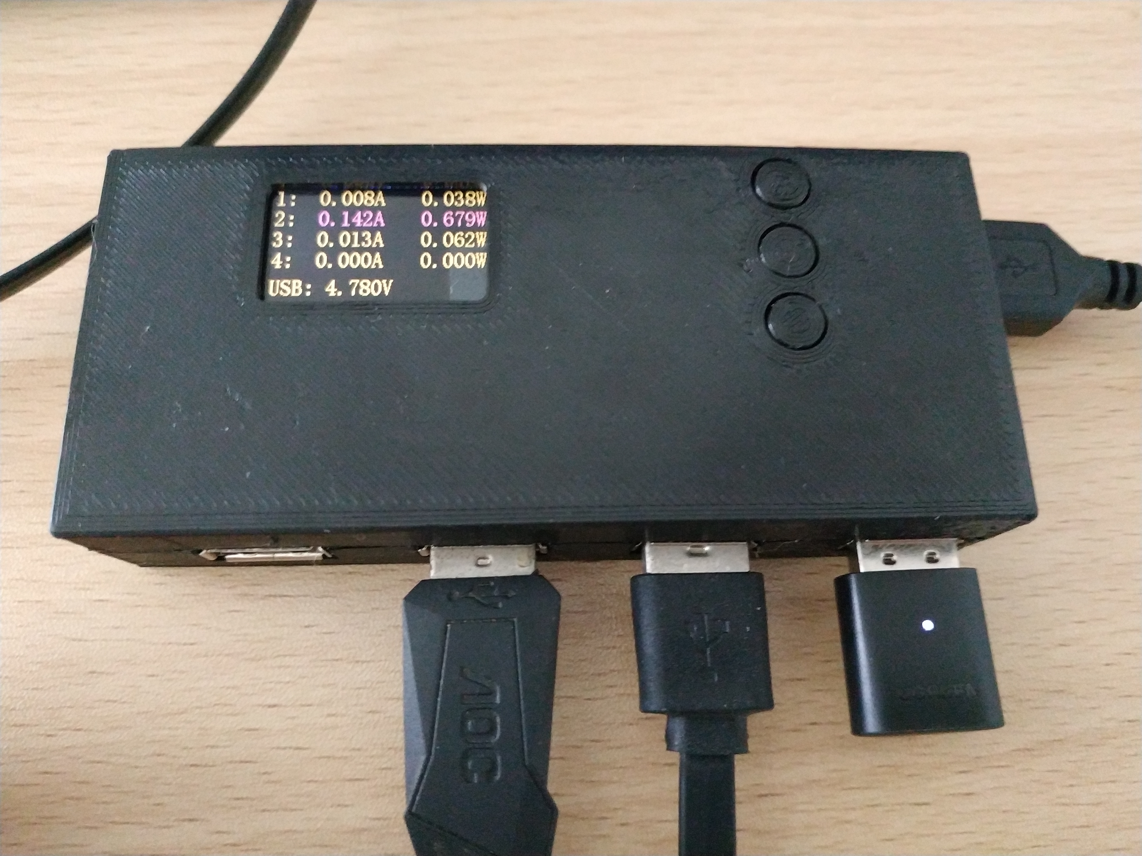

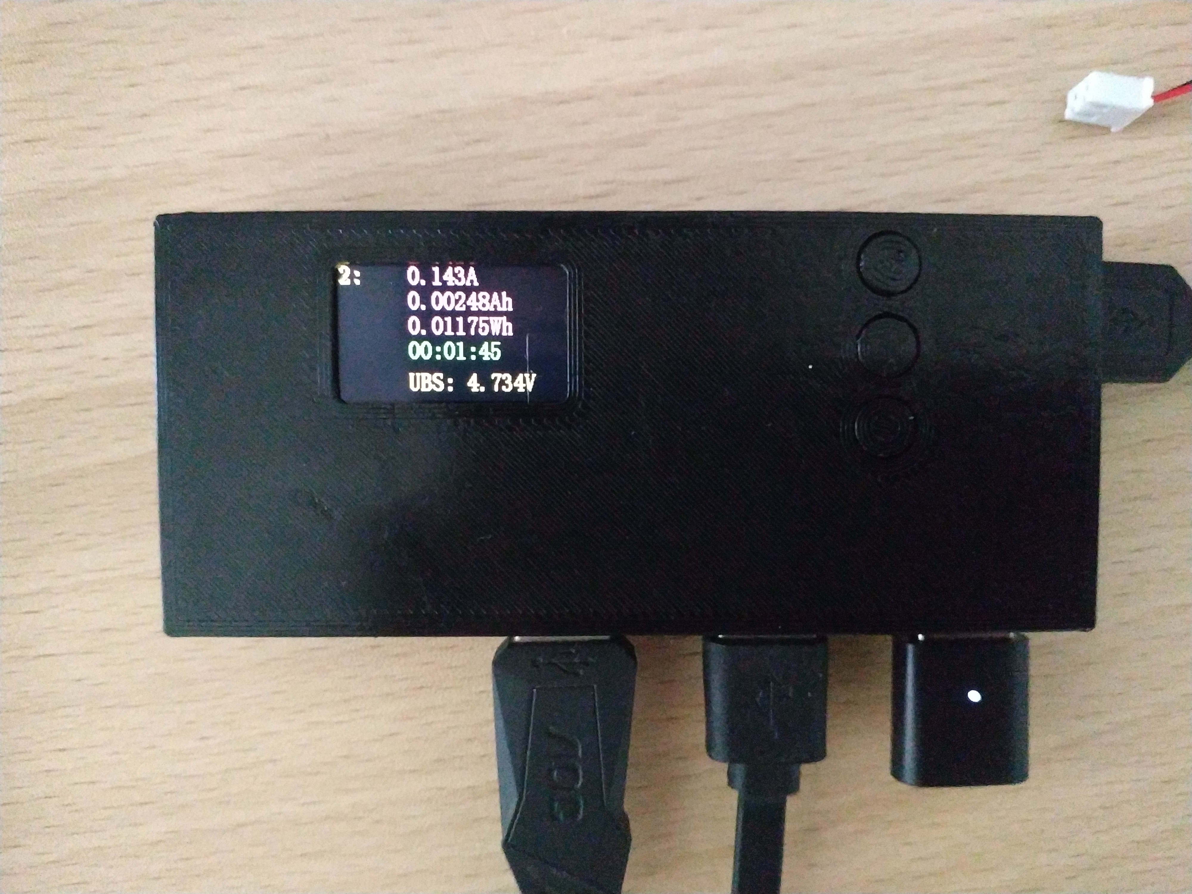

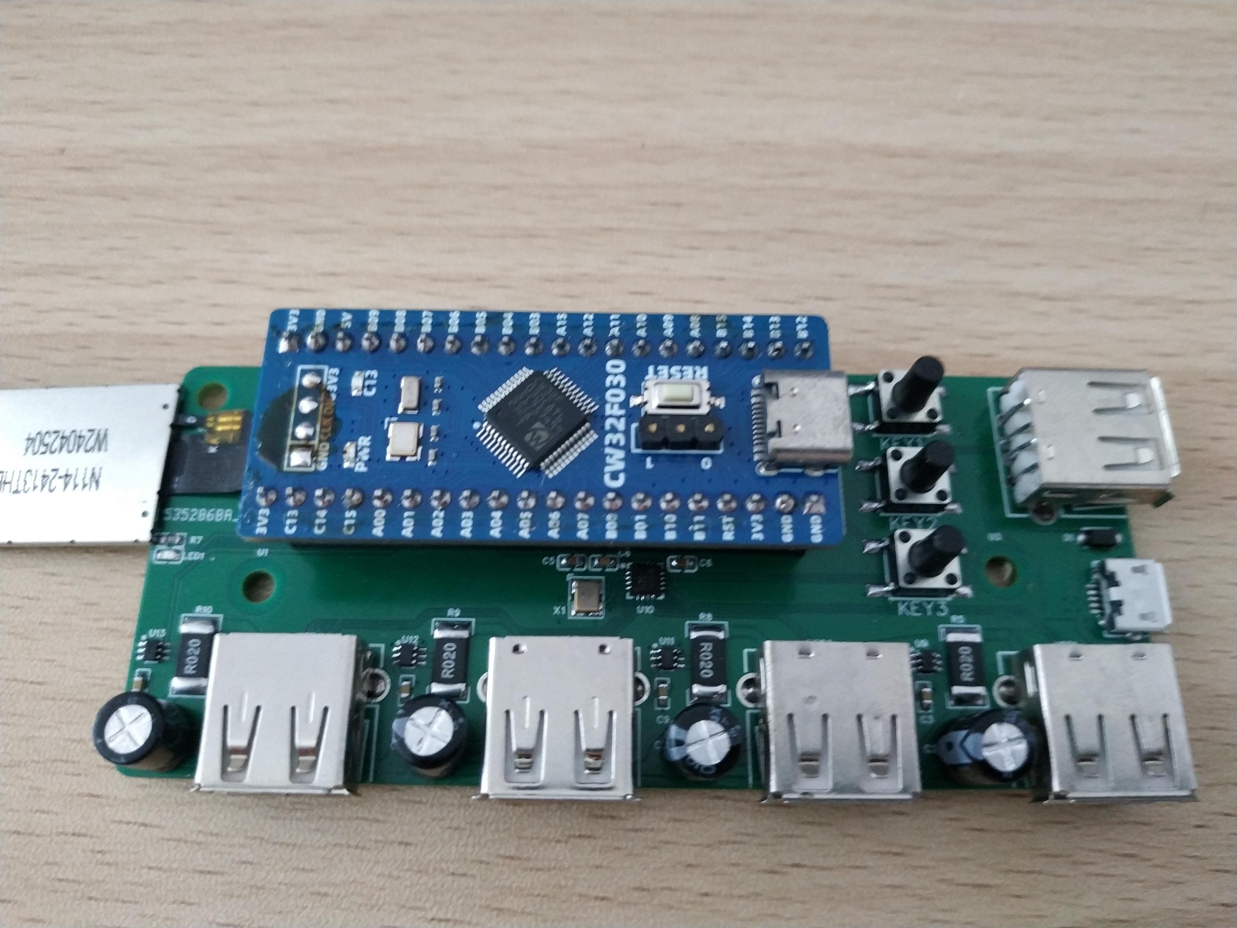

1. Project Description:
This USB hub, built using a LCSC (LCSC) development board, displays voltage and current, calculates power, and shows current waveforms.
Maximum voltage is 6.6V, and maximum current is 3.3A.

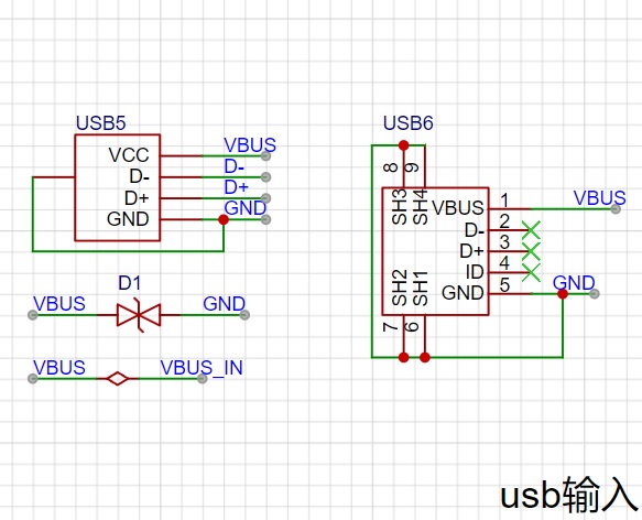

2. Circuit:
  1. USB Input:
  USB5 is for data input, USB6 is for external power.

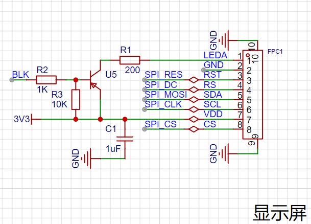

2.
Uses a 1.14-inch screen and SPI protocol.

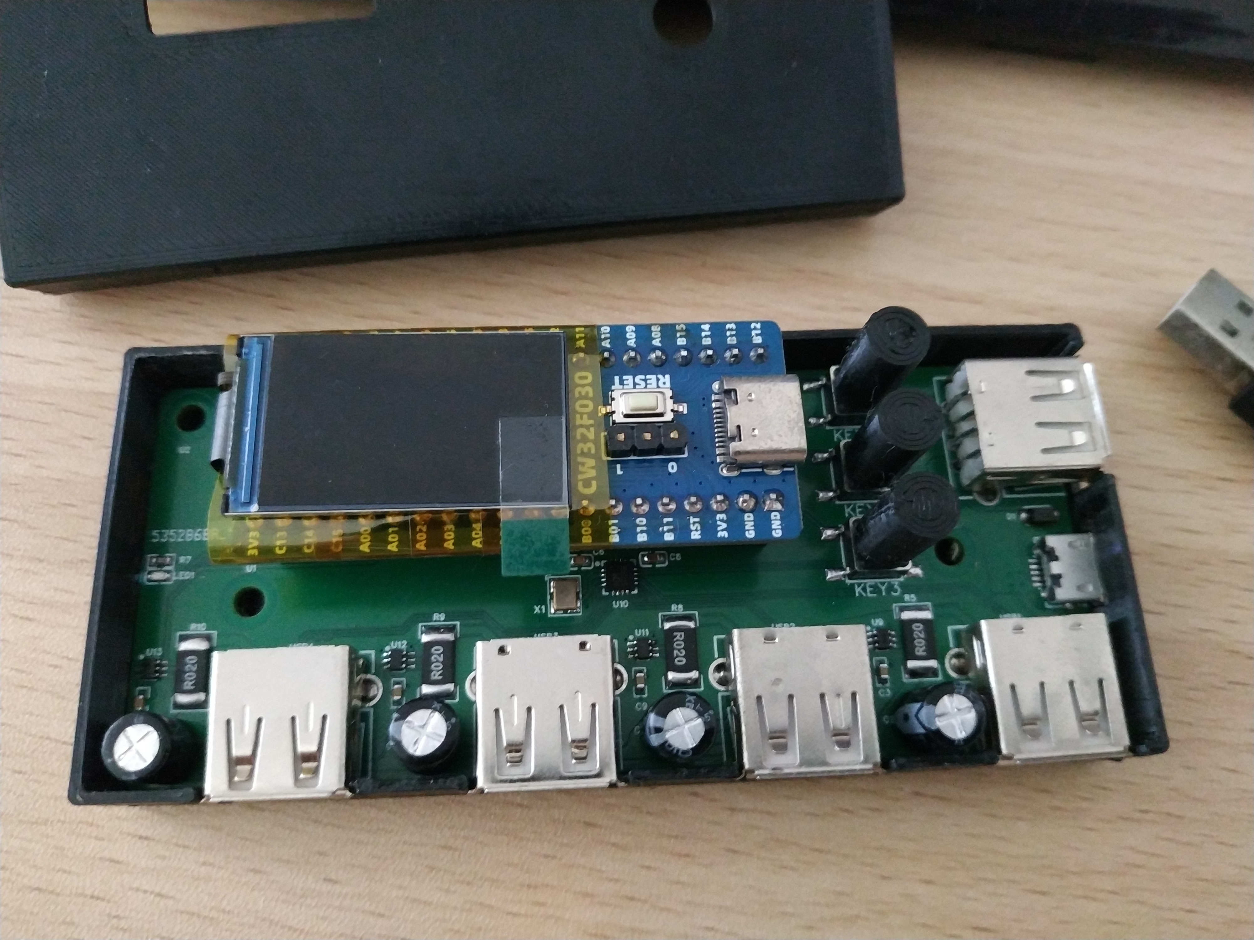

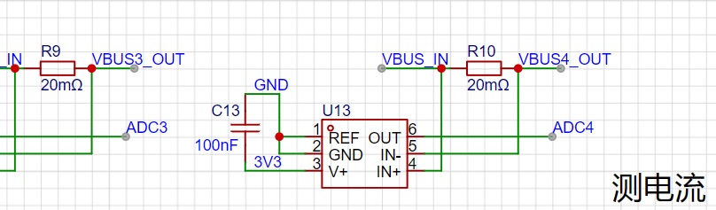

3. Current Measurement:
Uses a TP181A1-CR current sensing amplifier with a 20mΩ shunt resistor. With a chip reference voltage of 3.3V, it can measure a maximum current of 3.3A.

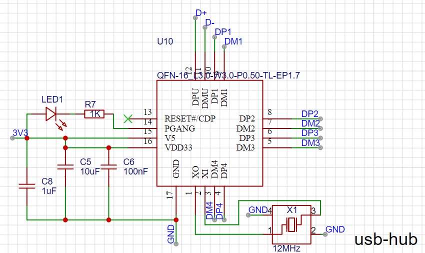

4. USB Hub:
Uses a CH334P, USB 2.0, and one LED indicator.

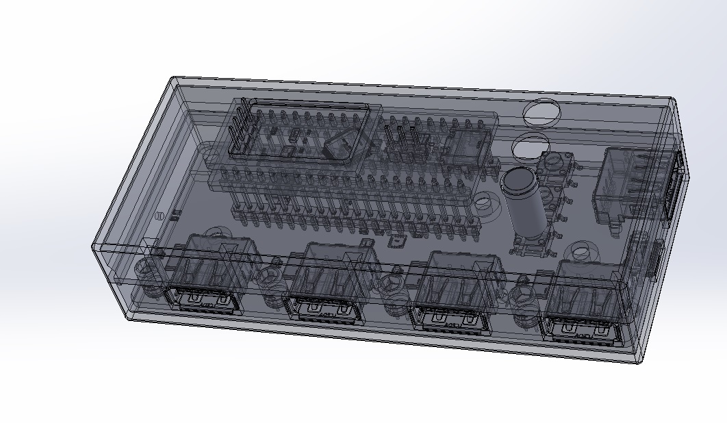

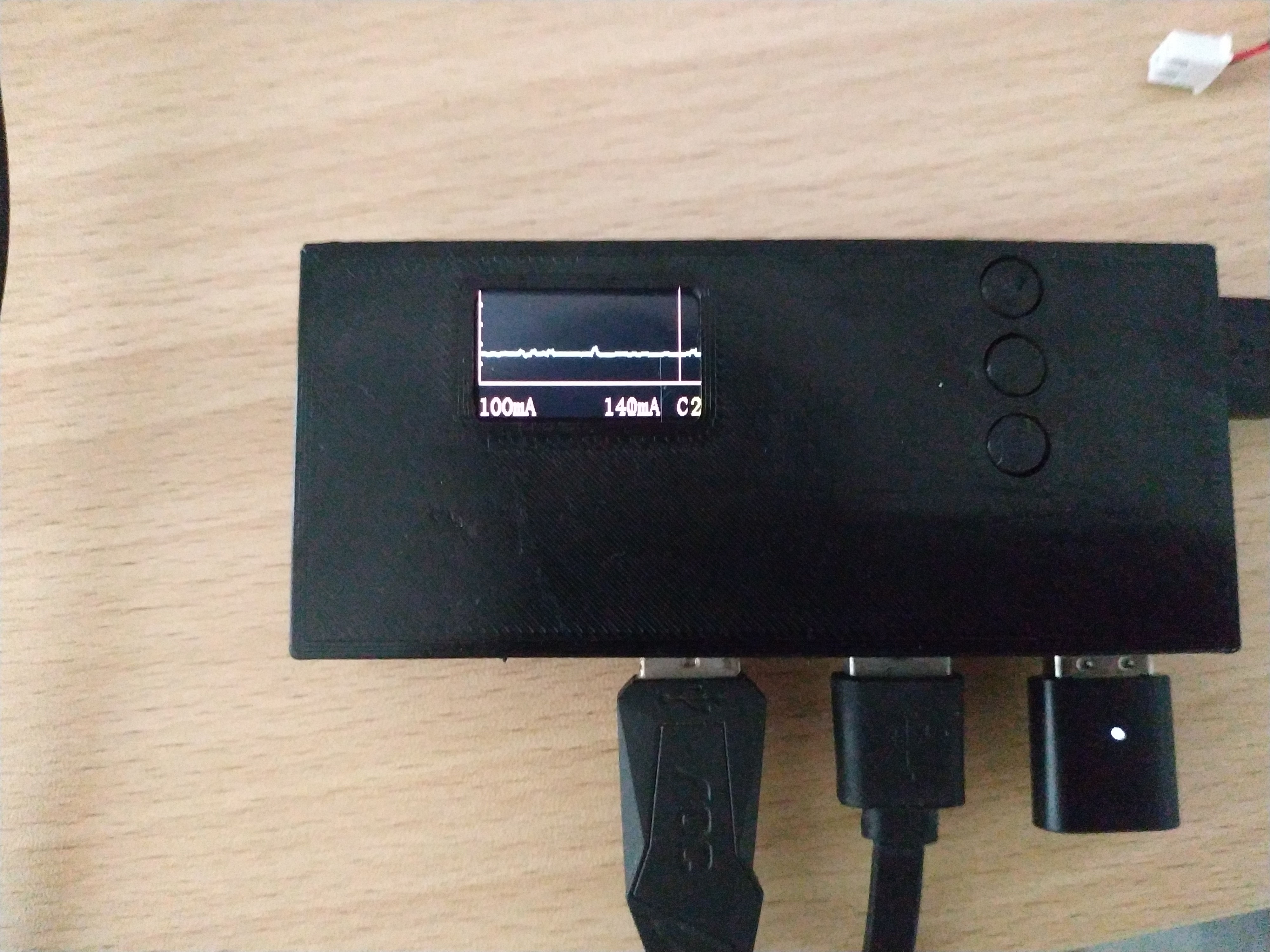

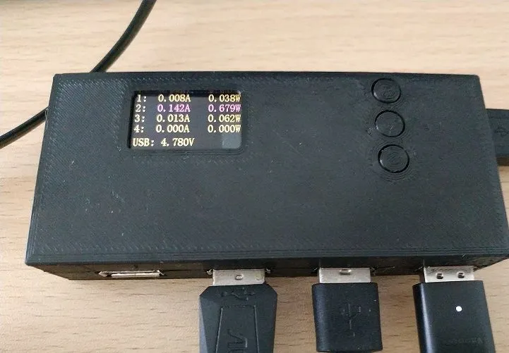

4: The casing
uses a SolidWorks design.
5: The actual product.
