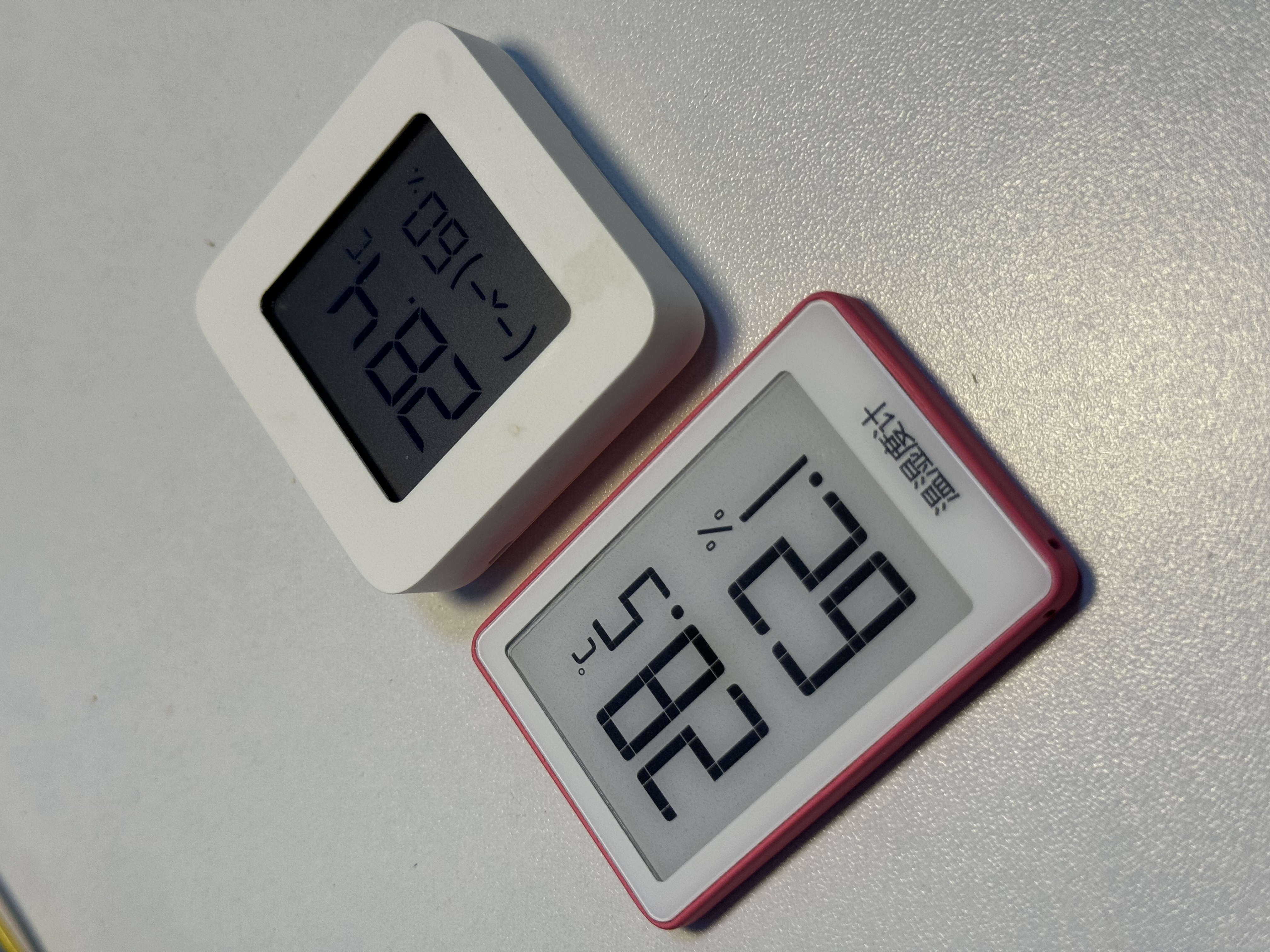

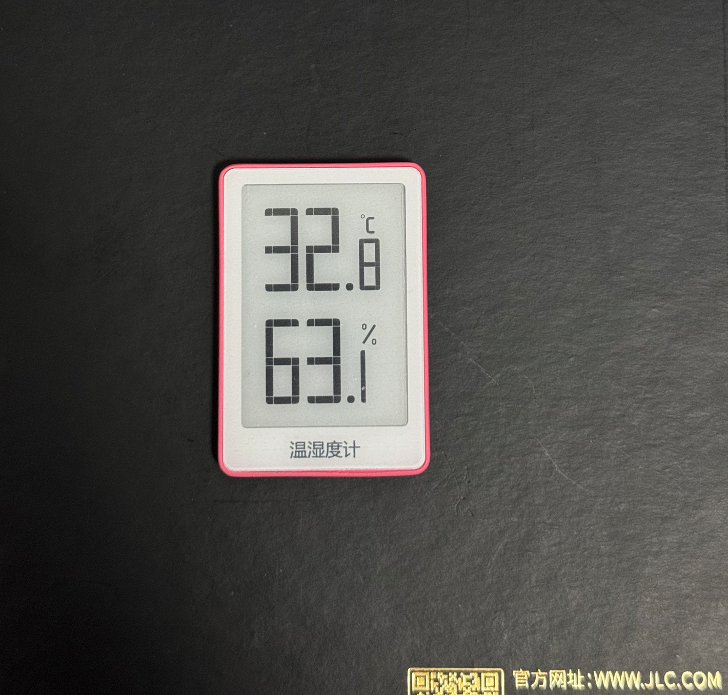

This project aims to design and develop an ultra-thin 1.9-inch segment e-ink display for thermometers and hygrometers, utilizing a low-power 1.9-inch segment e-ink screen. The core controller is the ESP8685, featuring 2.4 GHz Wi-Fi and BLE 5 functionality. To ensure high data accuracy and reliability, a high-precision Swiss sensor was selected. The device has a built-in battery and is equipped with a magnet for easy attachment to refrigerator surfaces, facilitating everyday household use.

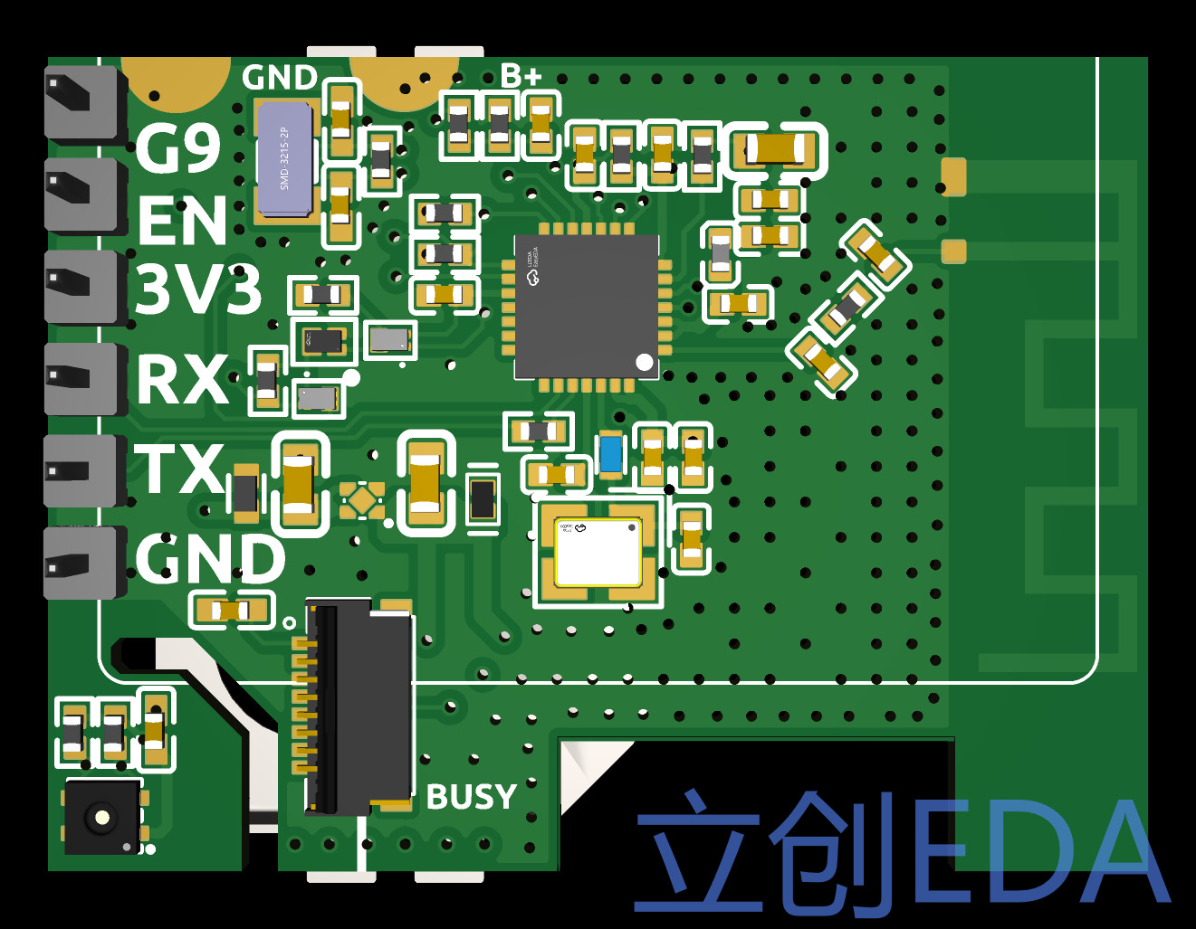

Hardware Design: The circuit board
uses a four-layer PCB design (JLC04101H-3313, 1mm thickness)
with low power consumption (standby <8μA).
Components include
a 300nA low quiescent current LDO.

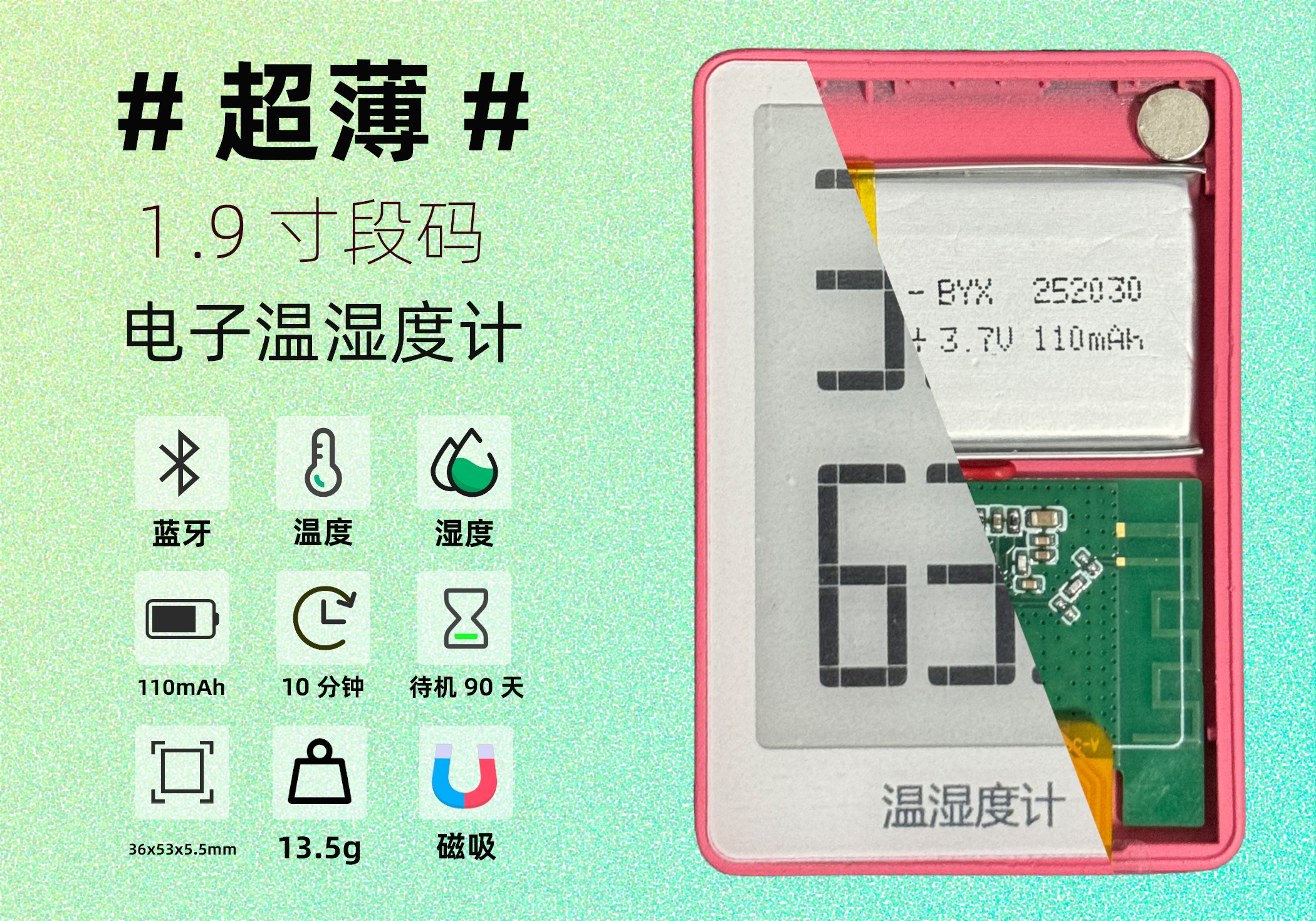

Built-in battery :
252030 3.7V@110mAh high-capacity battery .
Built-in magnets:
Three strong magnets allow easy adhesion to surfaces such as iron, nickel, and cobalt . Software Design:

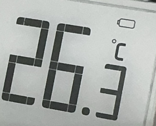

Battery Warning:
When the battery voltage is below 3.4V, the thermometer and hygrometer display a low battery icon.

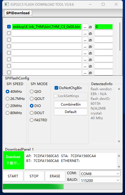

Firmware Burning:
Wireless Communication
: Temperature and humidity data can be uploaded to a cloud server via Wi-Fi for remote monitoring. It also supports BLE communication, allowing users to read device data via a mobile app and perform operations such as parameter settings. (Real-world scene footage)
