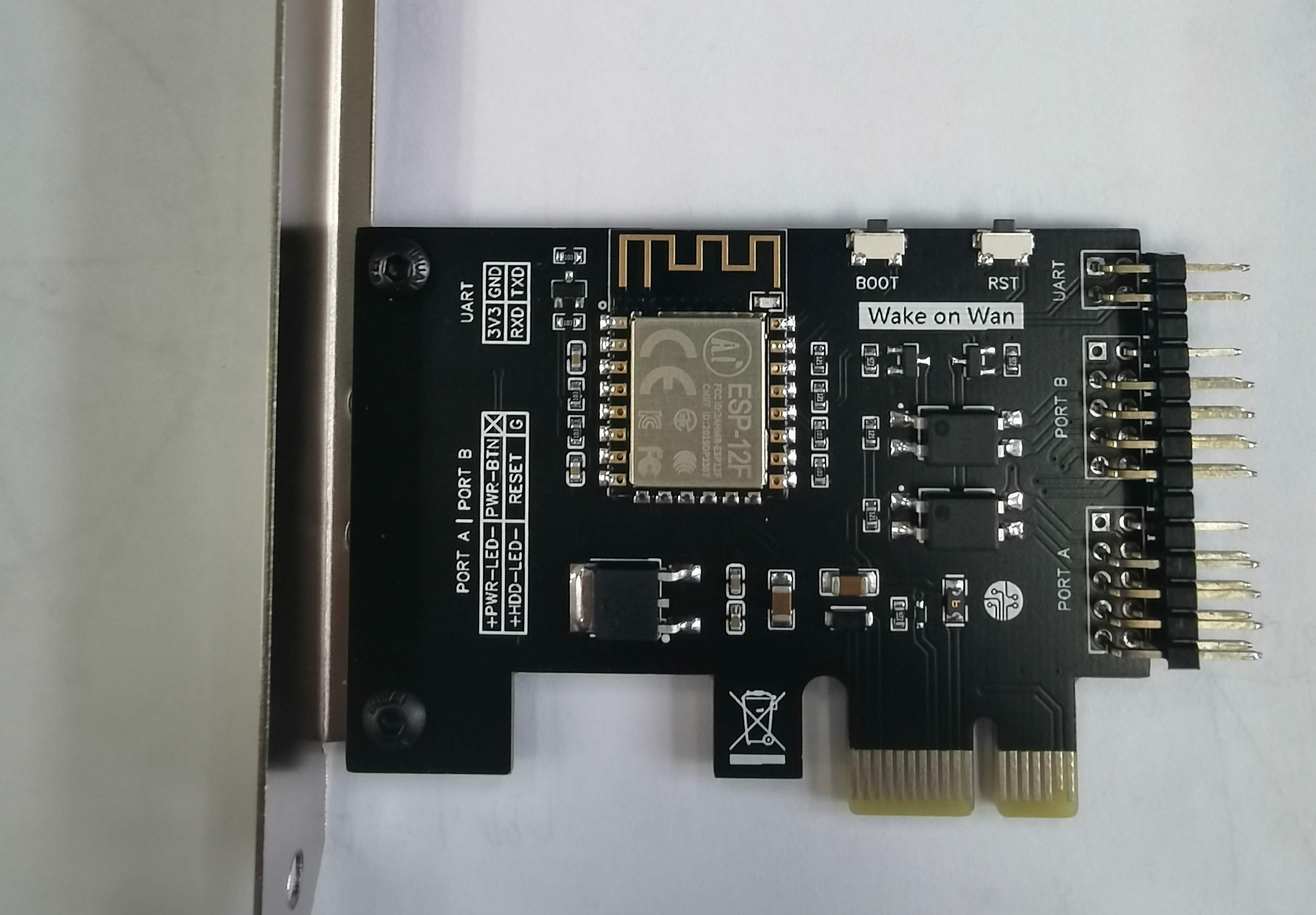

Yes, this project comes from a person with obsessive-compulsive disorder who feels uncomfortable having an idle master controller in his hand. It turns out that this ESP-12F is used as a weather clock. I felt it was a bit wasteful, so I changed the plan of ESP-01S (which has been released to Open Source Square). After finishing it, I looked at this ESP-12F every day and wondered how to use it and have some practical use. When I saw the remote boot card in the square, I felt very good, but I didn't believe it. When I turned around and saw my idle WS2812B, I had to add faith to the boot card!
The next step is to operate the drawing board until I, an obsessive-compulsive person like me, feel satisfied with the layout. Alas, there is so much nonsense, just go to the picture!
The hardware part mainly refers to the design in the square. Although you can directly turn on the IO port without using the optocoupler solid-state relay, but you can say how reliable the personally designed solution is. If there is a problem, the motherboard must be repaired. The gain outweighs the loss. This project has or retains the following advantages:
1. The optocoupler solid-state relay isolates the boot card and the motherboard boot control part to a certain extent;
2. It is best not to use a diode for reverse connection protection for 3.3VAUX, because the voltage drop of the diode itself will cause the ESP module to be at a non-rated operating voltage. This project uses a self-restoring fuse;
3. Some WS2812Bs do not have standard TTL levels. This project uses the simplest bidirectional level conversion circuit (3.3 - 5v mutual conversion). The stability of more ws2812s controlled by 5v will be much better.

Instructions for burning code: Connect the USB to TTL module to the UART interface on the board (RX-TX cross-connection). After inserting it into the computer, press and hold BOOT, then press RST, and then let go. Use the IDE to upload the code.
Network configuration instructions: After burning the code, first use blinker's developer-development tool-ApConfig to perform network configuration operations. The light of the ESP-12F will flash during the unsuccessful network configuration, and will stay on after the network configuration is successful.
Practical functions: 1. The first button is reused for power on and off. The button color and text description will be automatically adjusted according to the power on status. After changing the button type to switch type, press it to clear the network configuration information and re-configure the network.
