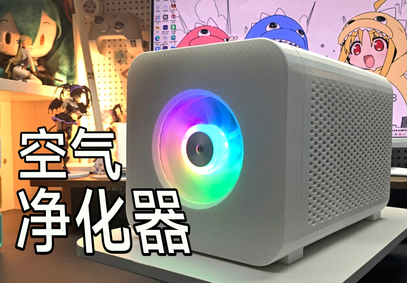

This is a smart desktop air purifier with RGB lighting and Xiao Ai voice assistant control, built using ESP Wroom 32e.
I highly recommend watching this video, which includes the project's initial purpose, principles, functions, effect demonstrations, and
a basic introduction to the air purifier (click to jump to Bilibili).

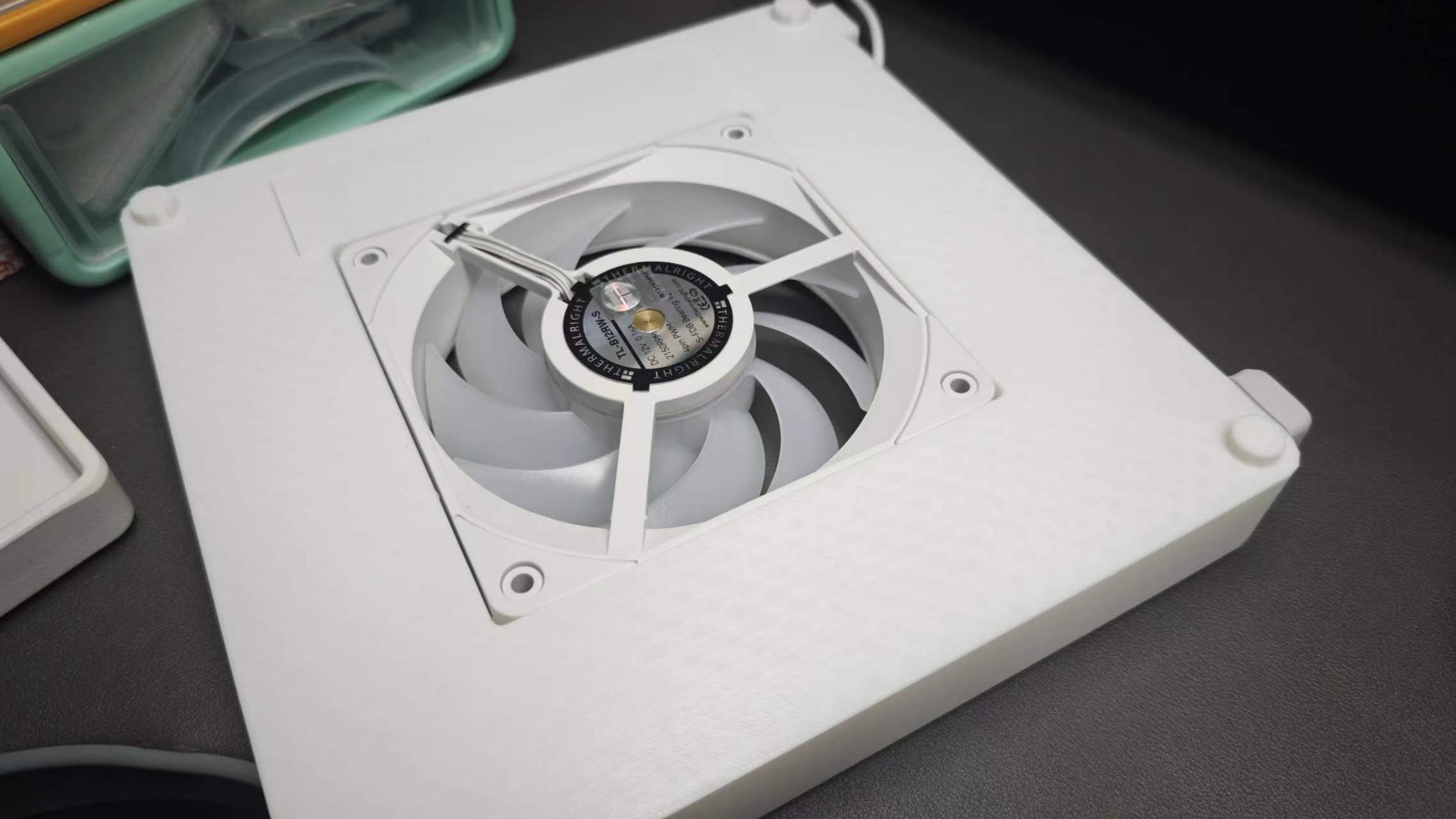

1. Fan Selection: A 3-pin RGB computer fan, 12cm*12cm*2.5cm. I used the Limin B12. An air purifier made with a 12cm computer fan won't have particularly strong purification performance. My goal isn't to drastically improve the air quality in my dorm, but rather to provide a small-scale purification (otherwise it wouldn't be called a desktop air purifier) ​​while also offering a nice decorative effect (RGB lighting and filling empty space on the desktop). I also wanted to control noise; this air purifier is significantly quieter than my Zephyrus G14 when playing 3A games. In quiet mode, it's practically silent unless you get very close. If you want better performance, you can replace the fan with a larger, more powerful filter. The board I made is essentially a controller, so theoretically you can choose a larger computer fan, 14cm or 20cm, as long as it's 12V and supports ARGB. A 12cm fan is sufficient for my desktop; any larger and the casing will be too bulky. There's less space for components and cables (the casing size can't be changed, and the desktop space is limited). In short, I suggest watching the video above first. The 1x3P and 1x2P headers on the PCB don't need soldering; instead, solder the fan's ribbon cable (just cut it off). I'm not sure if the fan ribbon cable order is consistent across brands; the wiring order I used is shown in Figure
2. Filter selection: I ultimately used a Huawei C350 PDD version with a diameter of 20cm and a height of 273cm. The later improved model (in this open-source article) was also designed based on this size. You can also choose a cheaper Xiaomi PDD version filter (same diameter, around 293cm high) or any other filter, but you'll need to design your own casing. I've only provided casings for your own filter (see the attachment to this article). If you're struggling to decide between Xiaomi and Huawei PDD filters, I personally suggest spending a little more to buy the one compatible with the Huawei C350 air purifier (Xiaomi and Huawei only refer to the PDD filter model and brand).

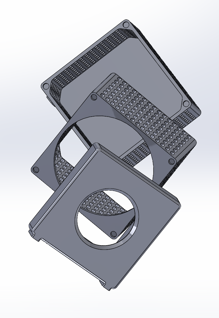

. 7. For the shell printing, I used R3D's white economy model PETG and a Tuozhu P1SC printer. I changed the infill density to 8%, did not use BRIM, and used about 900g of consumables (priced at about 24 yuan, let's say 30 yuan for consumable costs). Other materials are also acceptable; I've provided the SW file directly.

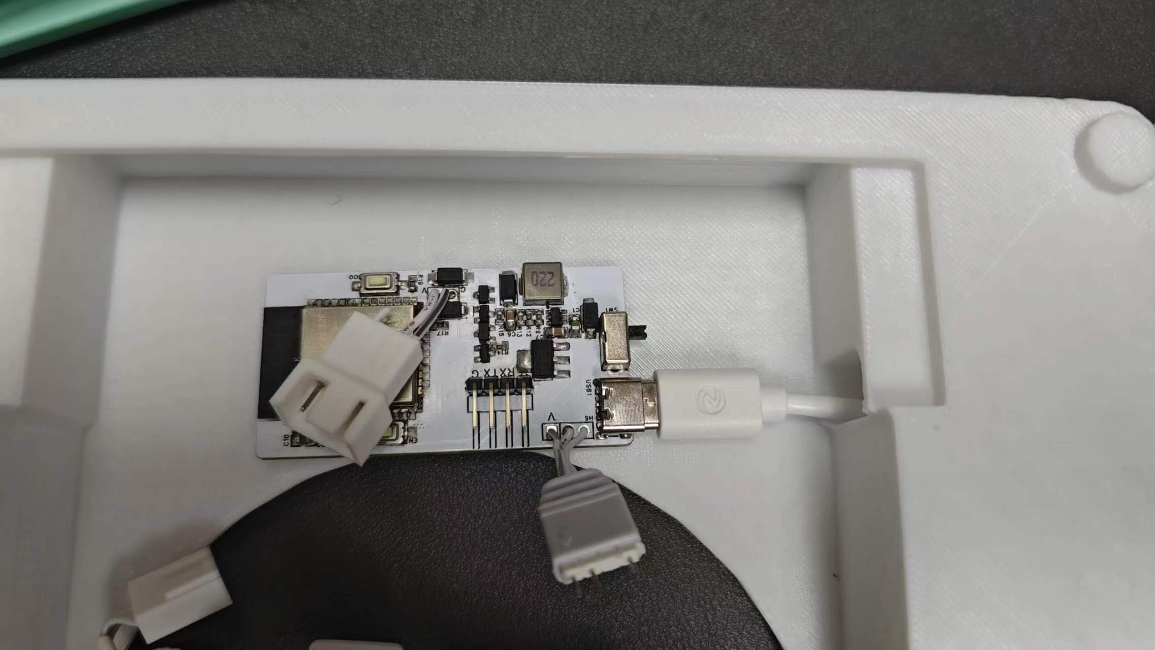

8. The last small board in the casing is the cover for the main control unit after all the components are connected. It looks like this when closed:
9. You can directly use a 5V 1A power adapter (this air purifier has very low power consumption, so a high-power charger isn't necessary). I added a USB extension cable with a switch and connected it to a USB-C cable; I suggest you do the same. The switch on the PCB is only for debugging.

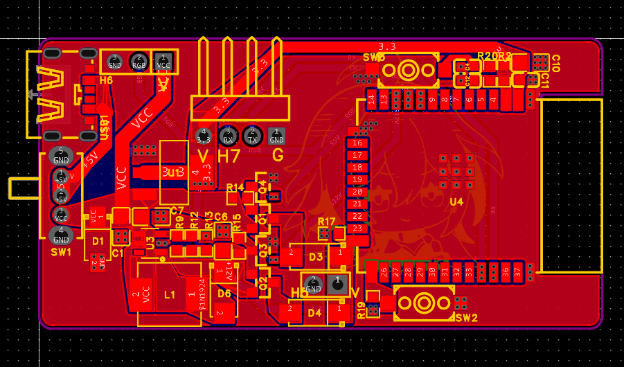

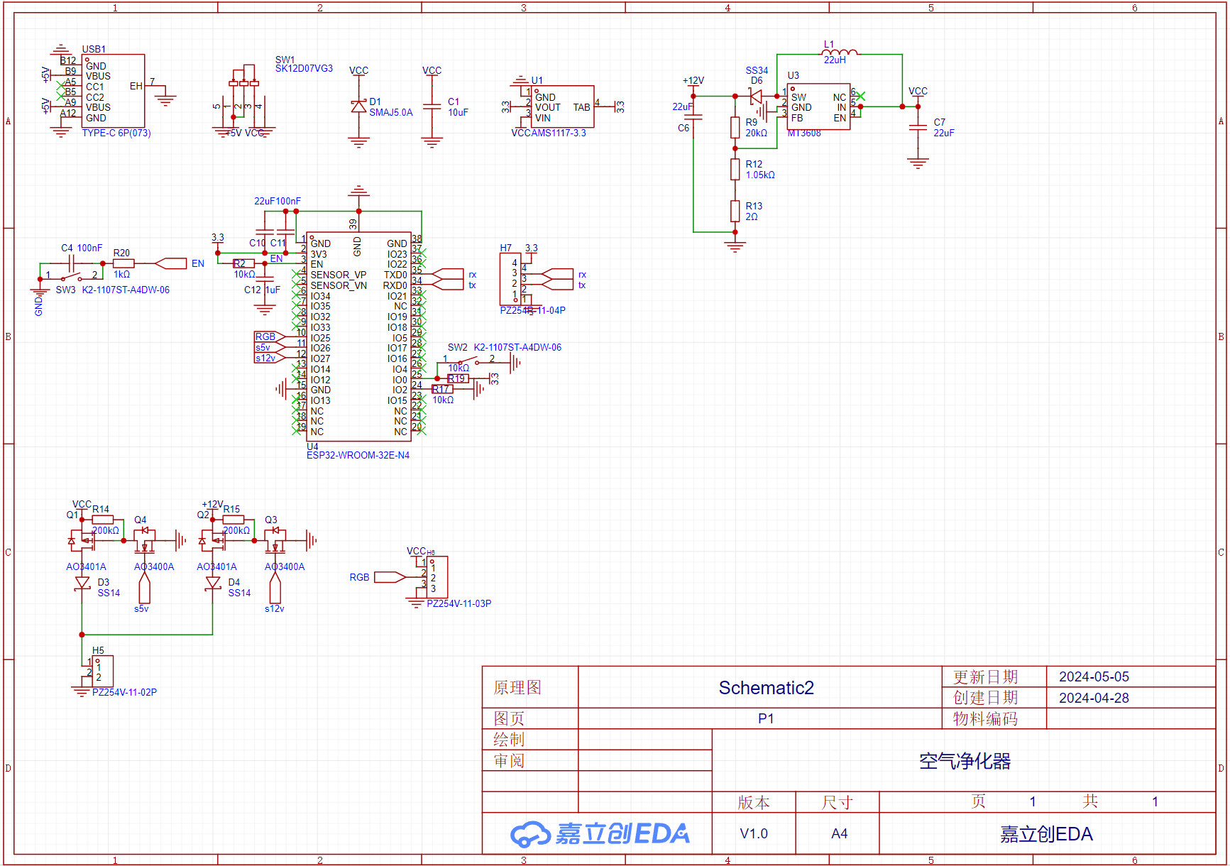

Schematic
(ESP32 version)
PCB
(ESP32 version)
